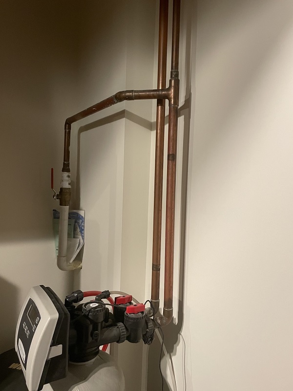

Finished up the ‘water softener addition’ project. Used a combination of Pex and copper(L grade) for this job. Not entirely sold on the ‘pex is more convenient/quicker’ mantra. Did have a couple pex fittings that leaked, and boy those are a royal pita to replace. PVC for this job was not in consideration due to findings that PVC taints water. CPVC is getting more of challenge to acquire in sizes larger than 3/4”, at least around anyway. Got two small leaks in the laundry room, both at transition points from one product to another.

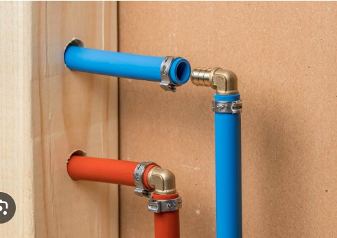

we built a house in 1980 and i used cpvc for all the internal H and C lines.. 3/4 and 1/2 inch.. 30 years later i was replacing a shut off valve on the sink and POW , the plastic exploded.. Found it was real brittle .... ended up a new project to replace everything in the house with PEX... I got the kind you use brass elbows and Tees with barb fittings... Got a hose clamp type thing that you PINCH tight with a special crimping tool... Worked great... that stuff will FLEX in areas when you need a little BOW... and i was told if it ever Freezes, the pipe expands and will not fail....( no freezing my house expected).
i used this type... not the stretch and compression type..

This is the same style I used. The crimper, although marketed as ‘one handed’ is a bit tough after arthritis sets into your hands.

Lars.... the crimpers i have are about 18 inches long and definitely take two hands.. you just squeeze them like a pair of pliars till it hits and STOP lug... that SEATS the clamp.. I  probably did 100 of them and dont remember any leaking..
your right Jay.. the PEX has the same OD as copper pipe so you can use Shark Bits to connect them, if needed....... the OD is slightly smaller... and you have some restrictions at the elbows... i used a minimum of those and have no problem with water flow..... most showers , sinks, valves flow less than 2 GPM these days anyway.

It is true the sizing of pex is deceiving, was always advised if using pex, to ‘step up a size’ from what would be considered a normal feed run. That why I used 1” pex to go 30’ to supply the water softener and laundry room. Will be utilizing the existing 3/4” pvc that runs 30’ back to the utility room where all the plumbing splits originate to all the other bathrooms, kitchen, outside faucets, etc. Later on if I notice a drop in flow with multiple taps running, I will switch out that 3/4” pvc with something larger. Municipal water psi is a steady 62.

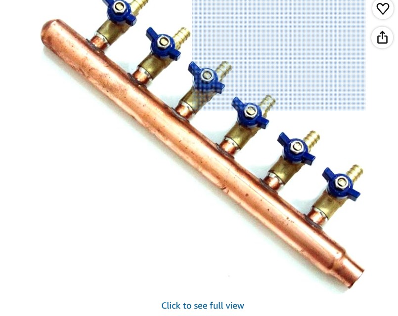

i used a 1 inch copper manifold with  several 1/2 inch valves mounted on it for the OUTLETS.. I ran 1/2 inch pex to several locations.. Kitchen, bath, bath, laundry, all have a different 1/2 inch feed.. Each can be shut off individually.. Longest run is probably 40 ft.

This is inbound.  1" T is flow in to Softener and to outside Spigots(3) header, Out of Softener is 1" to WH and supplies of Cold to remainder of House, necks to 3/4" just prior to split offs thru house drop to 1/2"
