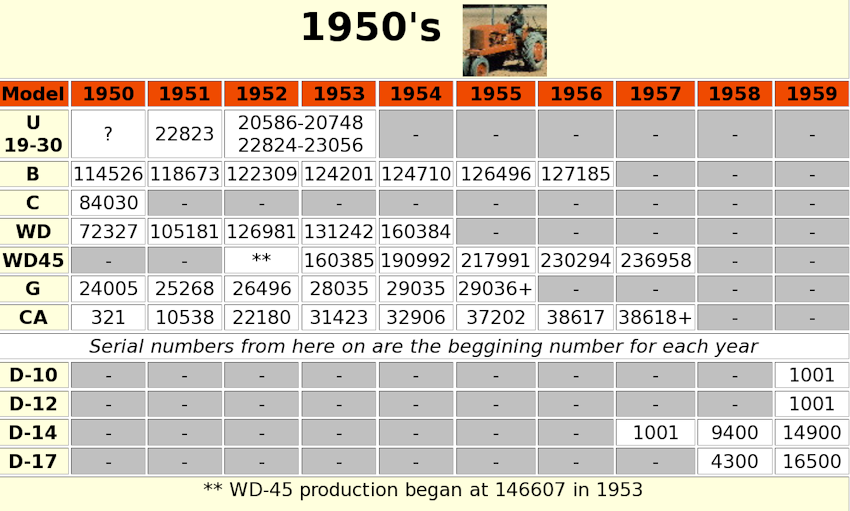

I have a derelict tractor which I always believed to be a WD45 since that is what the gentleman who sold it to me 40 years ago said it was. It has the correct WD45 curved shifter and engine block with a distributor ignition.
Grandson and I were perusing it for parts the other day when I noticed that it has a 3-bolt front bolster like a WD. I had never previously bothered to check the serial number which turns out to be:
WD156376
According the serial number chart on this website, this number falls into both the tail end of the 1954 WD category and also the 1953 WD45 range.
There appears to be an overlap of serial numbers between the two models. I am assuming the chart to indicate the last serial number produced in that year (the D-series and onward indicates the first tractor produced that year).
Or, I may be overthinking this Tongue

The chart you have there is pretty confusing! WD production ended in 1953 at serial #146606. WD45 started in 1953 at serial number #146607.
Ed (Ont) View Drop Down
Joined: 08 Nov 2009
Location: New Lowell, Ont
Points: 1657
Post Options Post Options   Thanks (0) Thanks(0)   Quote Ed (Ont) Quote  Post ReplyReply Direct Link To This Post Posted: 07 Jul 2026 at 8:36am
So yours is late 1953 WD45! For sure!!! Smile

The chart you have there is pretty confusing! ...
Indeed!
This chart is a screenshot of the chart linked at the top of this page, it is obviously in error.
I'm pretty sure that my tractor was not built in two separate years, I was just unclear as to which interpretation is correct.
Points: 23484
Post Options Post Options   Thanks (0) Thanks(0)   Quote DrAllis Quote  Post ReplyReply Direct Link To This Post Posted: 07 Jul 2026 at 9:26am
The "WD"- series serial numbers all ran continuously pretty much start to finish. At WD 127000? the new curved stick transmission went into affect. At 146607 the G-226 engine began and the chassis model became the "45". The 4-bolt wide front end was late 1954/early 55.
