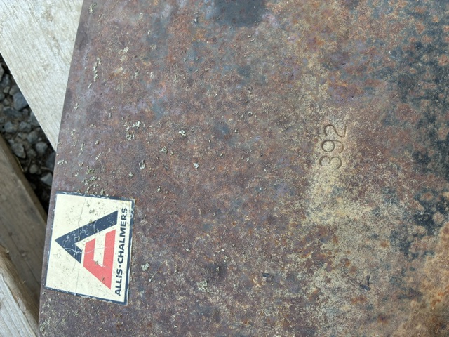

Can't find any marking on the new to me plow bottoms as to what number they are. I'm hoping they are 387's as parts are available. Landsides are really bad, rest of it shouldn't be hard to get ready to plow this fall. Is there an easy way to identify a 387?

If they are 392's I have some pretty decent used ones. uploads/24926/IMG_0228_1.jpeg Ned nbsjo@yahoo.com

Alright, further research has shown they are likely 387's. Bought some shares from Kenny awhile back. 2 of them are Adams, AM 164's. Bolt holes line up, but are not mounted yet. Will do that when hooked to a tractor! Anyway, internet search shows them as for the 387 bottom, available at Ag West (and probably other places) for $33.72 each. Might have this thing field ready by the end of July!
