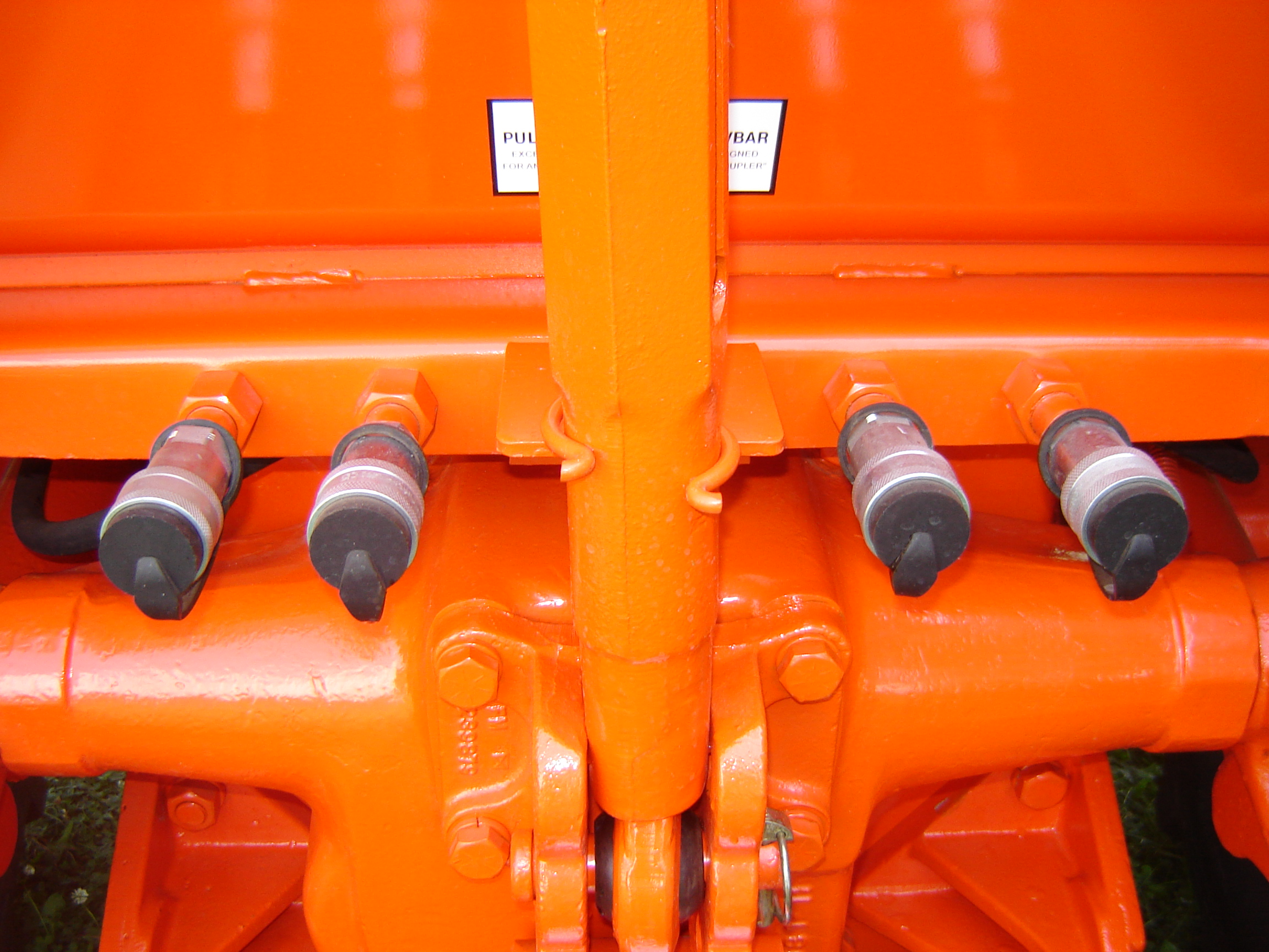

Under the fuel tank of any mighty One-Ninety was originally 100% steel hydraulic lines. There were four bulkhead connections at the very rear of the fuel tank frame lip for you to thread in your couplers so that they were solid. Who knows what you have. Doesn't sound OEM.

Post Options Post Options   Thanks (0) Thanks(0)   Quote DSeries4 Quote  Post ReplyReply Direct Link To This Post Posted: 17 Aug 2025 at 9:30am
Factory look
