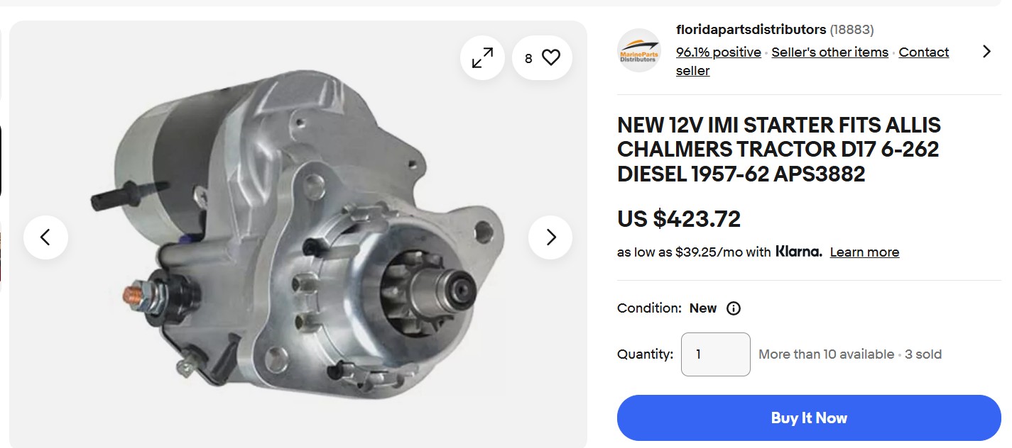

Dr Allis ? Does someone make a Gear Reduction Starter for a D17 Diesel ? Can you remove a canister oil filter base and mount a Spin-On base ? Thanks, Elvin

ebay.... ???

NEW IMI HIGH PERFORMANCE STARTER FITS ALLIS CHALMERS D SERIES 262 58-62 APS3882
$ 211.86 $ 423.72
Replaces Part Numbers & Specifications
ALLTECH: 104-3882 1043882
AMERICAN POWER SYSTEMS: APS3882
DELCO: 1113082
ITEM DESCRIPTION: STARTER
UNIT TYPE: DELCO
TYPE: OSGR
VOLTAGE: 12
ROTATION: CLOCKWISE
TEETH: 10
POWER: 2.5KW / 3.35HP
GEAR OD: 1.587IN / 40.3MM
MOUNTING EAR 1: 11.9MM UNTHREADED
MOUNTING EAR 2: 11.9MM UNTHREADED
MOUNTING EAR 3: 11.9MM UNTHREADED

I have a D17D, spins over quickly. The key is good grounds and heavy battery cables. 2/0 welding cable with crimp connectors works best with the correct + and - terminals. They are a different size and it makes a world of difference. Not only on a diesel but gas as well. My WD suffered from a slow roll over until I changed all that out. Just started it today after winter hibernation and she spun over quickly and fired right up. 6V battery and didn’t even trickle charge it. I’m telling ya, it makes a world of difference.

Get the old starter rebuilt and it will be as good as new

I've used those newer style starters on my Olivers,they'll turn the motor faster than the originals and seem to need less battery power.
