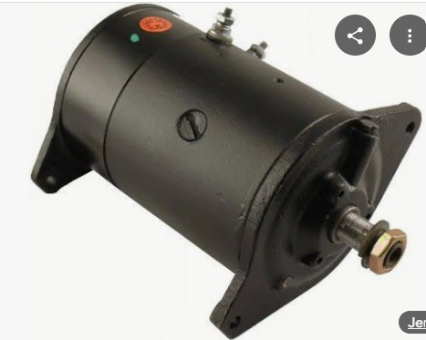

should look like one of these... a generator uses the voltage regulator... and OLD ALTERNATOR can have a regulator also.. NEW alternators do not need a regulator, it is internal..... How was the tractor charging the battery before without the reg ?
generator
alternator
Edited by steve(ill) - 25 Feb 2025 at 8:46am

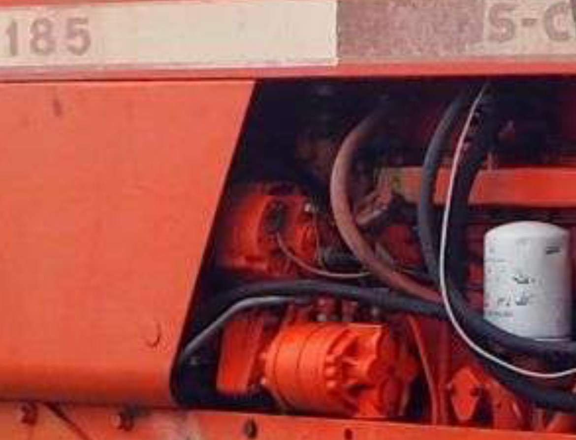

Not sure if that’s old style or new always charged fine before changing harness
Points: 88616
Post Options Post Options   Thanks (0) Thanks(0)   Quote steve(ill) Quote  Post ReplyReply Direct Link To This Post Posted: 25 Feb 2025 at 9:22am
that looks like a Delco with a tack drive ?? If it charged before WITHOUT the regulator, then i would assume it has an INTERNAL regualtor... You can look at the TWO PIN CONNECTOR and see if they are parallel to each other or IN LINE with each other.. But since it WAS WORKING.. i think  you dont need the regulator wires,  but need to make sure the TWO PIN CONNECTOR is part of the NEW HARNESS.
check the two wires on the small plug on the alternator... something was rewired at that point for the alternator... you need that on your new harness.
generator
alternator
185s never had generators.  All were alternator with voltage regulator from the factory.  If it was charging before the wiring harness was changed, then one of the wires are not going where it is supposed to.  When I bought my 190XT, one of the wires intended for the alternator was actually hooked up to the water temperature sensor!  No wonder it didn't charge!

Haymaker 6060, your picture is a Delco 10DN alternator with mechanical tach drive they normally use external regulator. Originally the Voltage Reg was under the small cover in front of instruments & on hood. There are 2 regulators available for that harness; with ammeter or with idiot light. They do not interchange, wrong regulator and won't charge.
 IF memory is correct the Delco 10DN can be converted to 1 wire with an aftermarket regulator that plugs into the 2 wire plug on alternator & 1 or 2 other wires.
 IF yours was charging without the flat plug for regulator in use, it may have 1 of these mounted someplace.
