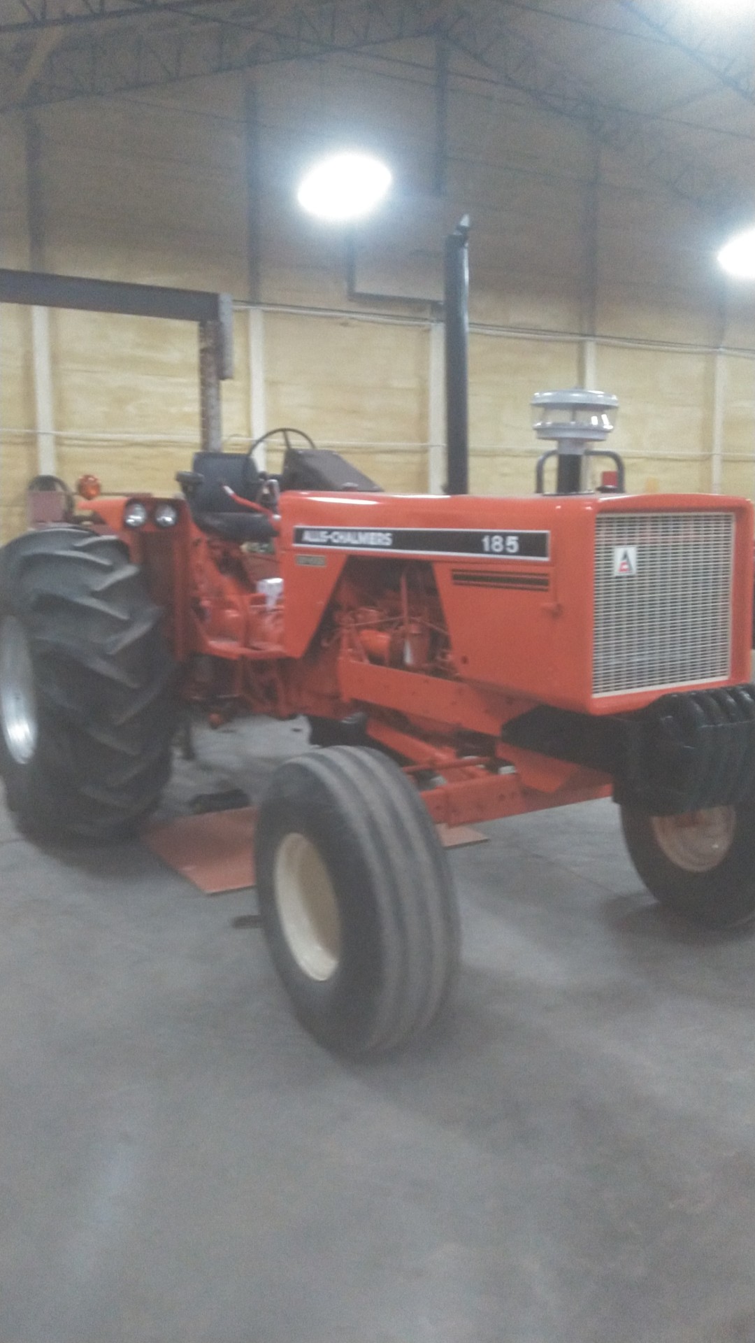

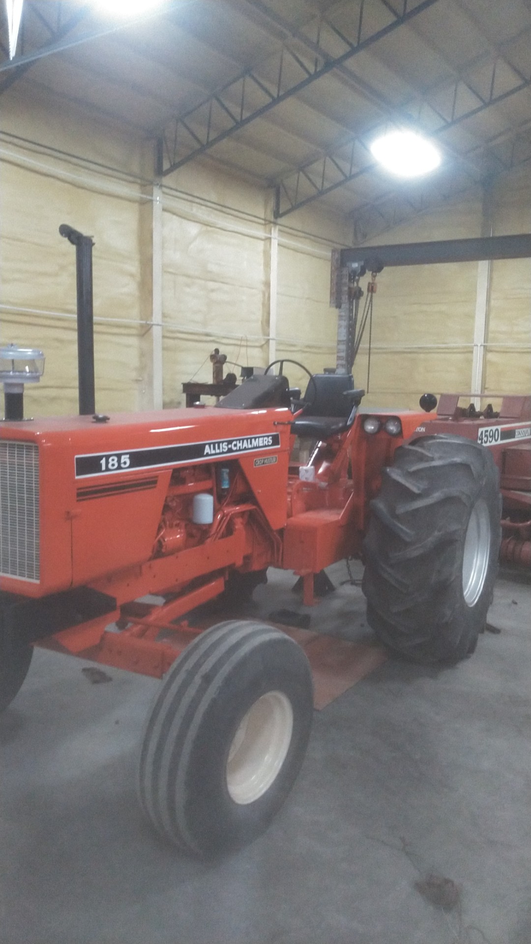

Latest project finished - then found a leak from the PTO mechanical shifter shaft - this has Hydraulic shift PTO - it was a change order unit probably. After lamenting the splitting we tried an alternative. With the correct O ring we stretched it over the arm - took 3 tries as rough edges popped 2 - and when around the lever we pried out on the shifter and the o ring snapped around the shaft pinching the o ring between the housing and shifter like a gasket. Since this shifter never moves we thought it worth a try - after 2 days - so far so good!  Yes it is a 'patch' but if it holds - it's worth a grand.. anyone notice anything else unique on the unit?

a closer view....
Points: 22170
Post Options Post Options   Thanks (0) Thanks(0)   Quote DrAllis Quote  Post ReplyReply Direct Link To This Post Posted: 19 Feb 2025 at 5:47pm
Turbo and matching exhaust manifold added. No eng oil cooler. Custom "EZ reach" throttle.

Post Options Post Options   Thanks (1) Thanks(1)   Quote tbran Quote  Post ReplyReply Direct Link To This Post Posted: 19 Feb 2025 at 9:49pm
yup, add no leaks, yet, and rear tires/wheels off a 540 MF Combine..

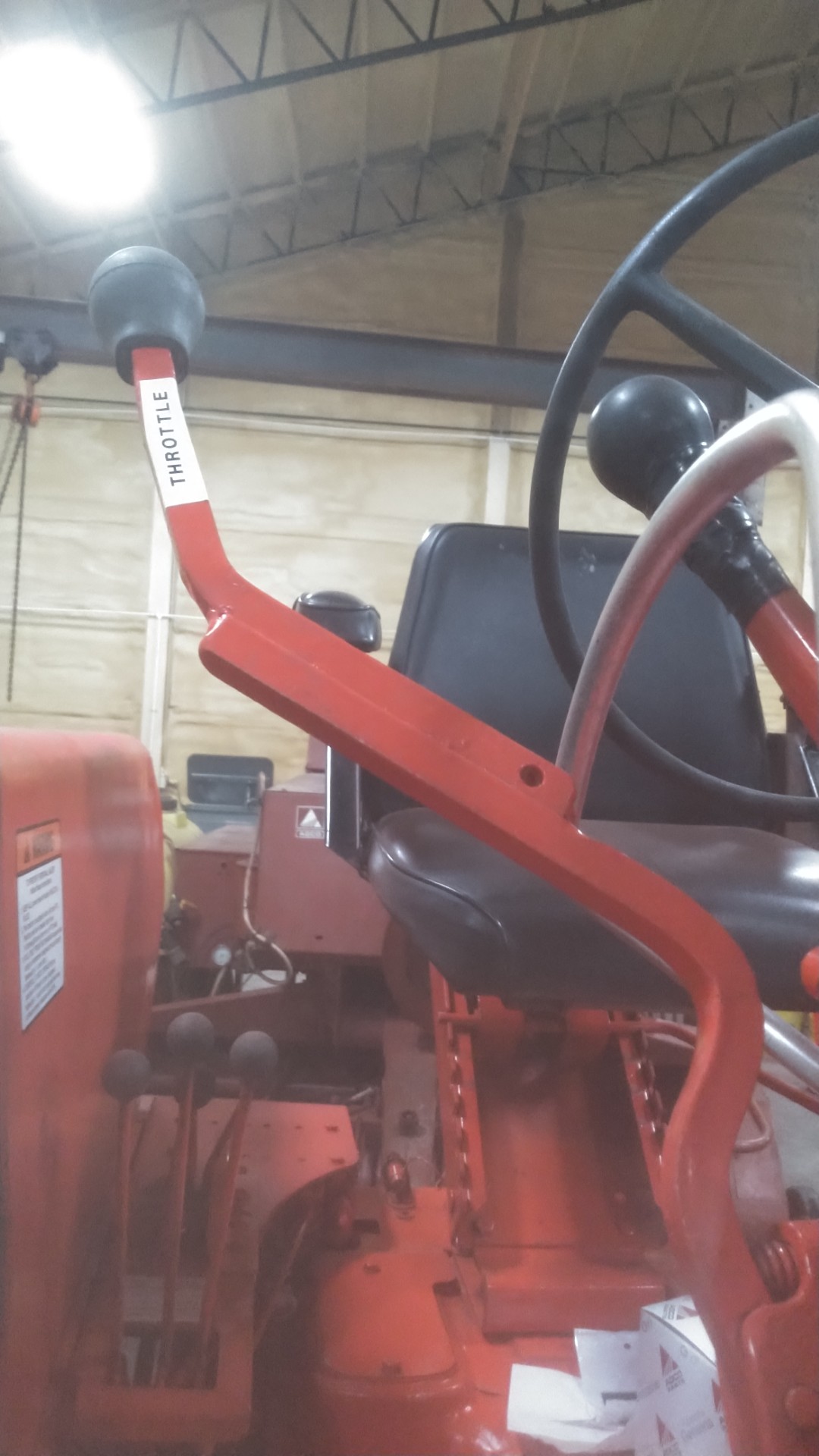

How about some info or close up pic of the throttle? Looks pretty neat!

No big deal - I had a salvage 175 throttle - just tack, heat and bend to liking - the other one I have at the house was made out of square stock and was a tad longer - the county fair puller of the 70's

I could never understand why after the 190 tractors were introduced AC didn't put the throttle in the side console, maybe even the PD control on all the "100" series tractors. So much more user friendly for the operator.
