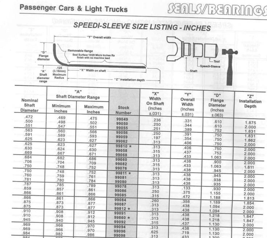

try to get a speedy sleeve to go on your crankshaft   I did that years ago

I have cleaned the GROOVE and put steel epoxy in it and sanded it smooth.. One has been that way for 15 years... The SPEEDY SLEEVE is a thin stainless tube  a few thousandths thick that you press over the crank journal.. That is a great idea... just got to get the right size..
this shows what it looks like and that there are various sizes... I DID NOT PICK THE SIZE.. you will need to GOOGLE after knowing the DIA.

Speedy sleeve worked great for me on my 45 front crank seal and also on my CA pro shaft. Good luck.
