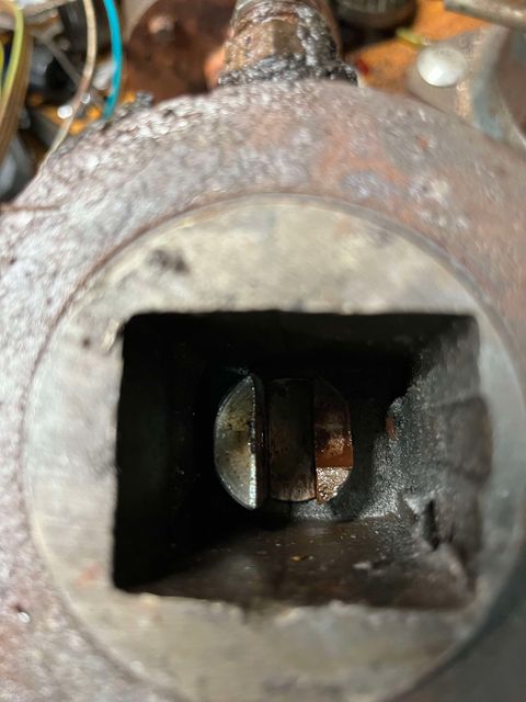

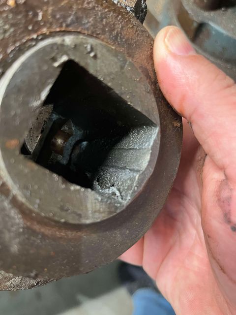

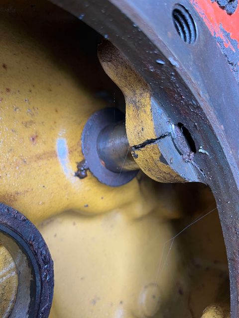

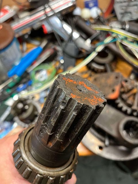

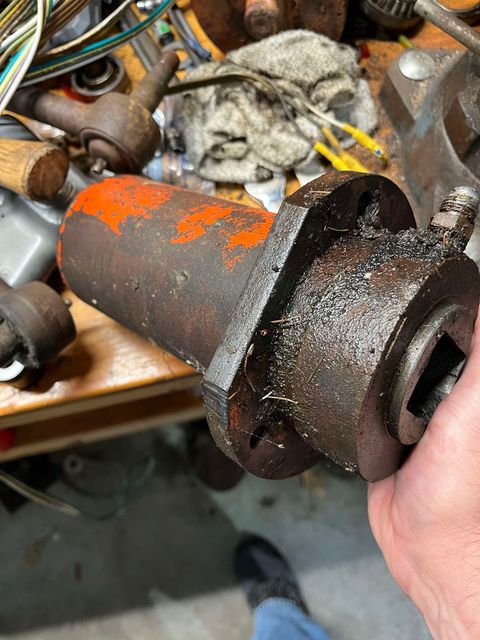

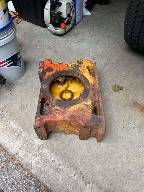

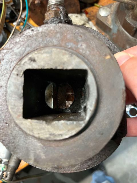

Long story made shorter , picked up a rode hard and put away wet 170 gas S/N 5560 for a song and a dance. Thinking I'd have a bucket tractor for short money ...as if .. 3 point and bucket works well and engine runs well with very even compression. Tractor wouldn't steer much at all  when I bought it thinking how bad could it be . My untrained eye says  (just guessing) that pin fell out of the end of the piston rod and took a trip thought the steering box
but maybe not ?!    front bolster or pedestal  has a crack in it where the idler gear shaft rides, end of piston rod is toast, and roll pin broke in the  steering arm fell down and took out  some teeth. What was left of the piston rod pin fell out when I dropped the cover in the bone dry steering box
