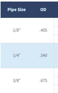

I measured the diameter of the screw thread part of the sensor and it is 3/8 of an inch.
Is that a standard size, universal fitting? I guess I could find an adapter if needed too.
Points: 88586
Post Options Post Options   Thanks (0) Thanks(0)   Quote steve(ill) Quote  Post ReplyReply Direct Link To This Post Posted: 07 Feb 2024 at 7:15pm
I would ASSUME that is a tapered 1/8 inch pipe thread.. You could take it to the Hardware store and see if a pipe coupling screws onto it.... YES... many of the "sensors" are 1/8 inch pipe..
Pipe OD...
Points: 88586
Post Options Post Options   Thanks (0) Thanks(0)   Quote steve(ill) Quote  Post ReplyReply Direct Link To This Post Posted: 07 Feb 2024 at 7:20pm
1/8 NPT is National Pipe THread... this is one of hundreds of possibilities... You can get some that have a 90 degree sweep, or 180 or 270 degree sweep.. Some are 2 inch dia gauge, some are 2-1/16.. some go to 80 psi... etc....... Dont buy a 200 psi gauge if your reading 20 psi... Wink
