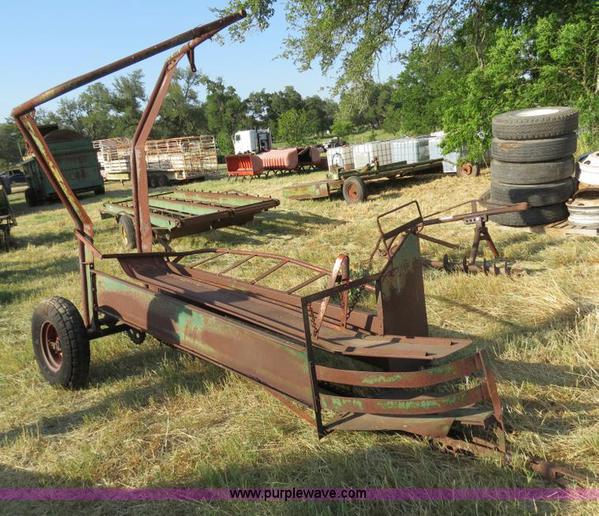

I finally found a picture of the model we used .In the picture it is laying down in transport mode. It stands up and attaches to the side of the wagon. We had a 1/2" bolt that stuck up out of the side of the wagon about 3 inches. The loader was lifted on to it and gravity would keep it on the wagon. Drive alongside and chain would conveyer bales up and rest baleon a platform. If you didn't pull the bale off the next one would push it off . Worked with both square and small rounds. My little sister was just old enough to steer the tractor. I would get her going in the right direction, jump off tractor, climb on moving wagon, stack the wagon full , climb off wagon to get on tractor to stop. Oh what fun !!!

Looks like it was ground driven?
