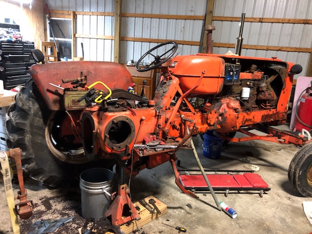

No hydraulic problems here. I just wanted to make sure that all parts were still in there, so I took them all out. I’ll put them back now. LOL
Unrelated question: anyone know what type of sealant they used for the street els from the hydraulic hose to the hydraulic cylinder? It’s orange and really needed some heat to get it apart. Street el was actually cracked at the cylinder and that’s why all my hydraulic oil was ending up in the rear end. I am betting that the rubber hose was stiff from 65 years of age. Stiff enough to lever on the 1/4 fitting enough to get a hairline crack. Just my guess. Hard to say what really happened.
