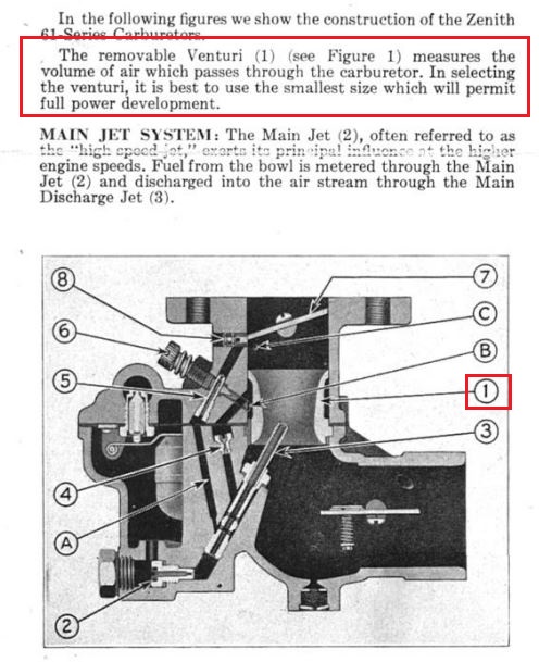

A 9707 is off a WC tractor.... Have seen that before... You may have to change the throat tube to smaller ... and change a jet to get it to run right.......... When you "CHOKE" it, you are cutting down on the air because the VENTURI is too large of diameter for a 125 cid engine  (WC was 201 )
I dont remember exactly, but im thinking on the B or C version, the venturi is about 9/16 or 5/8 inch bore ??  ......... see what yours measures.
