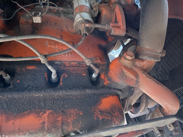

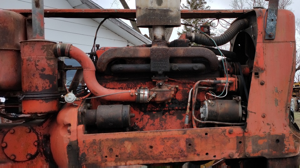

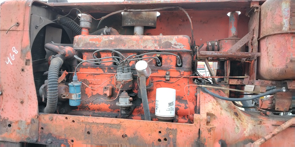

Brought home a D17 with a 6 cylinder engine in it. Auctioneer said it was a D19 as what the seller said it was...then said it maybe was just the engine that was a D19.
 But it didn't look right for a D19 engine with the water volute coming off the side of the head. Thought all D19 engines were of the more modern design going straight forward.
  Well, thought maybe this engine was a combine engine but the C series combine engine I have is of the similar design of the D19.
  notice the side discharge on the head.

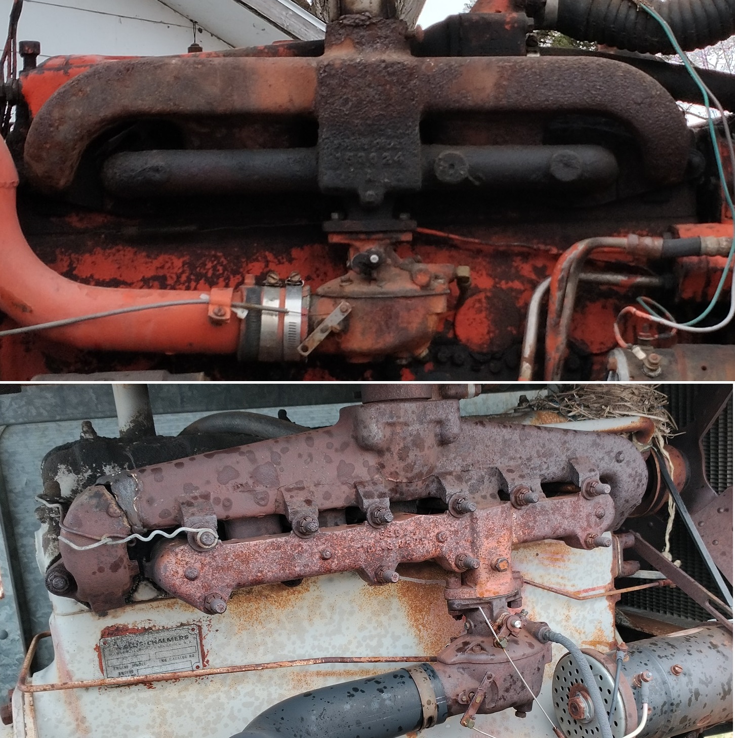

Notice the manifold, this is centered for carb and has extra heat to the intake side from the exhaust side... D19 and the 230 on the A allis combine have the carb more towards the front of the engine. So was this an industrial engine?

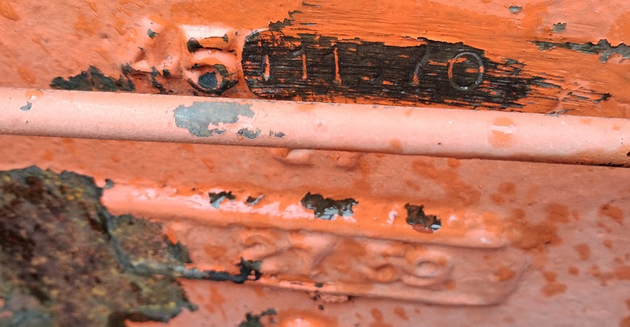

No ID plate on the engine just the cast number of 45 with stamped in marks after it.... then under the rod is cast a number of 27 and the cast in date looks like 1-27-59
Looking at the cast number of 45, it almost looks like a 0 was ground off after it.
 Big question is, how can I tell that this is a 230 cube engine or a 262 engine?
and was it a low grade fuel burner (low compression engine) or a regular grade burner despite the design of the manifold. thanks.

I'm gonna say a 230 engine because of the manifold, water pump/cylinder head design and the 1959 casting date.

Doc, I had thought the same thing, but the early D17 diesel was 262 of the nearly same design.  and the D19 came several years later with the newer design and the D17 diesels got the newer designed engines as well.
 And as far as I know, the 230 got left behind.
 If it is a 230, wonder how the HP and fuel consumption will compare between it and the 226?

The G-230 and G-262 were used in the A and C combines and the D-19 tractor. The D-19 never had that water pump or manifold design. If they made a G-262 before 1961 (D-19 time frame) I am unaware of it.

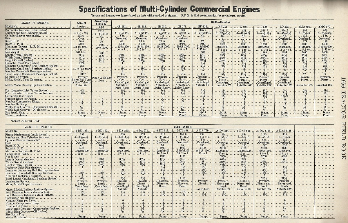

Went and looked in an old The Tractor Field Book with power equipment specifications, published by Farm Implement News Co., Chicago 1956.
 They had a section under 'Specifications of Multi-Cylinder Commercial Engines'. Each company was listed with the gas models and then listed with the diesel models.
 Under Buda, they listed 11 models of Gasoline and 11 models of Diesels....
I see they listed the 6B-230 and a 6B-273, but no 6B-262.  I also see in the Diesel section they listed a 6 DA-230 which was a close copy to what was used in the WD45 and a 6 DA-273 that Cockshuts used but no 6-DA-262 engine . So AC must have developed the Diesel 262 for the D17 and then the gas version and turboed diesel262 for the D19.   Thanks

What about a dsl that got a gas head installed? Air cleaner looks cobbled on and dsl batt box?

What's the chassis s/n ? .....17-XXXXX or 19- XXXXX.   Power steering pump definately D-19 or series 3/4 D-17. Air cleaner is homemade in design and location.   Also, the BD-273 is a bored block...no wet sleeves. The 262 series was an Allis-Chalmers created engine with wet sleeves that sank over time.

Looks to me like the engine s/n is 111570  ?? which could very well be. The D-17 parts book says that old water pump mount design was prior to engine s/n 119938.

The air cleaner looks like something off a D14? or a power unit? The intake is about the size of the WD's intake pipe.
 The location of was determined by the previous installer, and the hood still has the front hole.
Power steering pump arrangement does look like that of a D19
Manifolds are certainly different than from an A Gleaner 230 engine.
SN is D17 7640D ... Tractor 1958, block first month of 1959. Close in age. lol
Was looking at the chart and see the 230 could produce 73HP at 3200 rpms and 164 ft pounds at a thousand rpm, with 6-1 comp. ratio, just think what it could have done at 8-1.
To bad AC didn't make a thicker top deck to the block and a wider liner ledge when designing the 262, it could have withstood the test of time.

Think of it this way: A-C hadn't used this  gasoline "B"-series engine yet in farm tractors, as the D-19 was first in 1961. I think the carb/manifold design mimics the Buda engines used in Cockshutt tractors. Same can be said for the water pump/cylinder head design.  In 1961, the engines design features change and the old B-230 series gas engine now becomes the G-230 and it's bigger brother the G-262, both with new designs in the manifold and water pump components. They are now Allis-Chalmers engines, not Buda.

Dr., that seems to be looking like how it played out.  And to think Allis bought Buda out in November of 1953.
    Buda had been hard at it to try and get their engines into all parts of the industry and into the trucking industry too...  after Allis purchased them, that effort waned, as I have read.
  Been an interesting thread looking into the Buda engine in this tractor... tho it might have been better if it had the 262 in it instead.
  Now to see if the 230 will start and run... if it's junk, I will put the 230 from the combine in it, that engine ran really good.

The picture of the engine painted grey in color, I would call a Gleaner model "A-2", not a straight model "A".  So, the Gleaner model A series combine was built from 1951 thru 1967.  Not sure when the A-2 came out, but I'd guess 1961 or later, kind of following the D-19 engine time line. With that in mind, you'd have ten years of engines in older model A's that very well could have had that old Buda style manifold with centered carburetor and water pump hanging from the cylinder head AND possibly painted orange ??

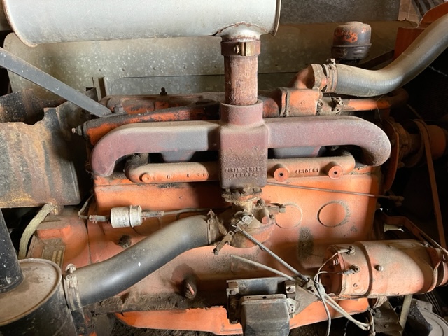

That engine looks exactly like the 230 in our old Gleaner A combine. I don't know exactly what year it is, but it is an A, not an A2. Here are a couple of pictures for comparison.
We also have an older Gleaner A parts combine that has the Hercules engine. The Hercules is a flat head engine, so completely different than the Allis/Buda engines.  It's interesting that they have the same bore and stroke, I never knew that!

I did some looking and found the combine serial numbers.  The A with the 230 was built in 1960, while the A with the Hercules was built in 1955.  Just for interest, I did some reading in Norm Swinford's book and he wrote that Allis switched from Hercules engines to the 230 sometime in 1957.

Brendan, your 230 engine looks really clean.
 I went and checked the gray engine A Gleaner I have and serial number is A-40361. Can't find any serial number breakdown of years for the Gleaners.
