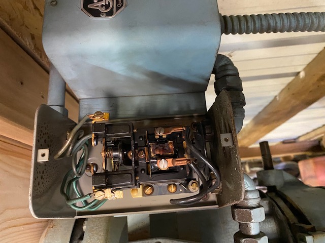

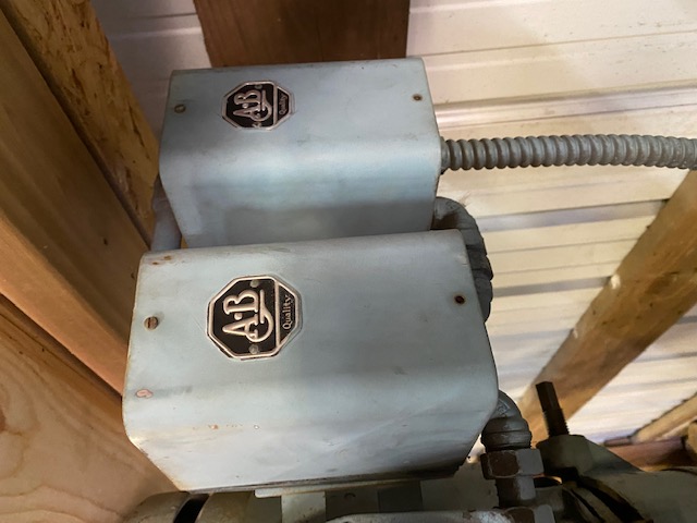

These are on my milling machine. What are they for?

Thad, its kind of hard to tell what goes where and where it comes from in the photo... Set of contacters on the top is normally used with a small switch (on  - off) to turn on LARGER wires that draw more current.... or could be  used on a 3 phase motor to change direction of travel..... Can you trace where the wires on the top come from, where is the Main Power, and where do the two big black wires at the bottom run toward ?
EDIT.....
i think the ON (?) switch sends power to the bottom ( black wires) to energize the coil  ( single phase, or 1 of the 3 phases) to pull the contactor UP or DOWN...  there is probably 3 sets of contactors at the top that connect the wires on the LEFT to the wires on the RIGHT... So it looks like an ON- OFF, 3 phase power to the motor switch.
Since there are TWO BOXES, it could be to run a motor forward or backward.. reverse direction ?

As Steve says, they're contactors.  The contacts are at top, and the coil is at the bottom (black wires).  Energize the black wires, and the electromagnet coil on bottom will pull the contacts together.
MOST LIKELY, the two contactors are wired up so that one of them will run motor forward, the other will run it in reverse.  There's 3 leads going to a 3-phase motor.  Call them A, B, and C.  The motor has three leads... call them X, Y, and Z.
Hook up
A to X,
B to Y,
C to Z, and the motor turns in one direction.
Switch ANY TWO wires, and it will run opposite direction... so
A to X, B to Z, C to Y... and so on.
IF There's only two contact sets on the contactors, and it's three phase, there's three leads.  The way it works is simple... ONE of the incoming power leads is always connected... let's say A to X.
To make it run one way, B-Y and C-Z
To make it reverse, B-Z and C-Y.
In this example, it only takes two contactors, each having two sets of contacts.  When ONE contactor pulls in, it makes the B-Y and C-Z connection.  When the other pulls in, it makes the B-Z and C-Y connection.
Your switch, therefore, needs to just connect control power to one contactor, or the other, to get a 'run forward' or 'run reverse' command.
Just gotta make certain that ther's NO WAY that you could ever have BOTH pull in at the SAME TIME... they have to be mutually exclusive, lest you have B shorted to C.
BTW... a contactor is oftentimes referred to by some as a 'relay'... and while they do the same thing, a contactor is different for one very basic reason:
When you energize the coil of a relay, the contacts it controls close... and as long the coil of the relay has power, it will continue to hold them closed.
And the relay coil will continue to draw the same amount of power.  Let's say the coil of the relay requires 2 amperes to pull in, and once it's in, it continues to require 2 amperes to hold those contacts.
A CONTACTOR, however, is an AC device that, when it 'pulls in', the AC coil's polepiece is 'contacted' by the armature pulling in the contacts.  When the armature lands AGAINST the coil's polepiece, two things happen- first is that the armature becomes part of the polepiece's magnetic 'world', and it holds extremely tight, and second, the 'magnetic world' of that armature and coil now 'restrict' the amount of AC current that can flow through the coil... the property is called 'inductive reactance'...
so the end result, is that an AC contactor might require the same 2A to pull in, but once in, the coil naturally LIMITS the amount of current flow through the coil... say... to 1/4A... and as a result, it not only reduces waste energy significantly, it substantially increases the coil's operating life...
IF you come across a contactor that's buzzing when it's pulled in, shut the machine down, carefully disassemble the contactor's mechanism, clean it all up good, especially the pivots and the armature/polepiece faces, and put it back together... it'll pull in solid, get a whole lot quieter, and run cooler.

the two black wires at the bottom, and from the Second box, should run to a FWD- REV switch..... you "turn on" one of the AB boxes or the other.

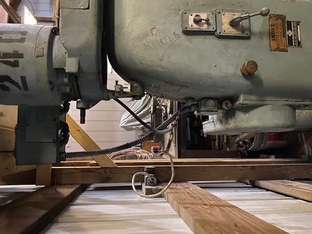

It has these two switches on the left of the column. Both are 3 way switches.
It also has a switch on the front of the head which I believe is either the spindle foreword reverse switch or it changes the spindle speed. This has a 2 speed motor.

You can see the junction box on the back of the column where the wire is cut. That’s a 4 wire power in.
On the other end of that box is another cut wire that’s a smaller 3 wire in. I assume one for the spindle and smaller for the power feed.

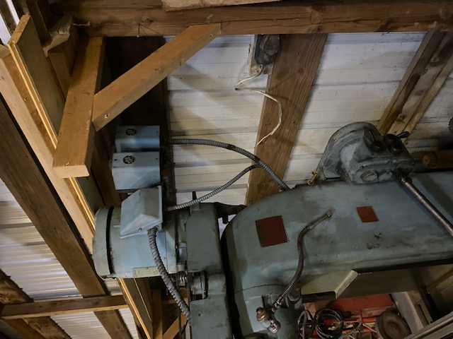

Only the big motor for the spindle is 2 speed
The power feed is just single speed

Steve it’s hard to see but the AB boxes have a conduit coming out the bottom and going in the bottom right f the motor box.
The conduit you see going forward from the motor box goes to a switch and n the head of the unit. It’s either the 2 speed or a fwd reverse switch.

Both AB boxes wires go to the motor and the switch up front.
The motor has 6 wires coming out of it.

It has a flexible light on the right side. Could it be 120 volt for that? It’s a factory light I believe???

It is ILLEGAL to run a 3 phase 240 and a single phase 120 in the same 4x4 power box....
NOT necessarily.  It is bad practice to bring in TWO separately-derived power supply services into the same machine, through the same box, except for circumstance where all power sources are disengaged by a ganged multivoltage switch...
but it is rare for that to happen in MOST tool environments.  The exceptions are usually when the machine has a VERY HIGH voltage input (say... 1200v) for running really large drive motors, but has 120v CNC controls and work lighting.  Basically, if there's a 3-phase 480 input, and a 120v single phase, they'd put a dry transformer across two of the 480 legs to derive that control power from downstream of the 480v safety switch.
The other thing that is generally considered bad practice, is to have a neutral wire on a 3-phase machine... i.e. a 480/277Y feeding into a machine, where the Y centerpoint and one leg is providing 277 single-phase to something, while the 480V 3-phase powers a motor.  It's considered bad practice (because a neutral means there's zero-sequence current (unbalanced 3-phase load) which, if marginal, makes the machine carry the remainder through it's ground wiring... so having a Y-centerpoint (that's 'centrepoint' for our brethren north of the Poutine Curtain) generally doesn't happen in an industrial environment.
The location of the high/low speed Dahlinder switch MIGHT be located INSIDE the mill's column...  with the speed selector shaft protruding to a control handle on the outside of the column.  On my Bridgeport, I tucked the VFD, and a control transformer, inside the BRJ column, and mounted the power, lighting, and speed/direction control pendant feedthrough in a box on the side... it's so nice to have it out of the mayhem...

Last night I went to visit my mom tonight I work at the cemetery hopefully tomorrow night o can get out there and trace wires.
I’ve been looking at lots of pics and video of these machines. Most do not have this light.
I wonder if it’s an add on?
