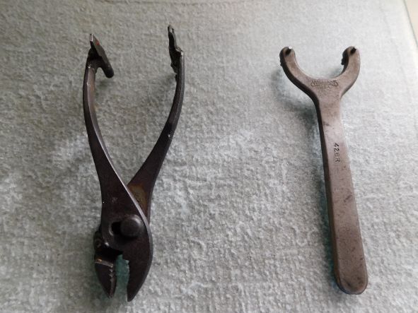

Here is one I made and one I bought. Unscrew the cap where the shaft comes out and pull rod out. There will be a plug with Orings and backups then on the end of shaft is the piston with cup seals. Pretty straight forward just remember where everything goes when you take it apart

Thanks everybody for the additional direction and tool picture.  I thought I would tackle one of the tilt cylinders first since they are smaller.  My seal kits should be showing up by Friday.  I haven't envisioned everything yet so may have some more questions.  Once I dig into it, it may be more obvious.

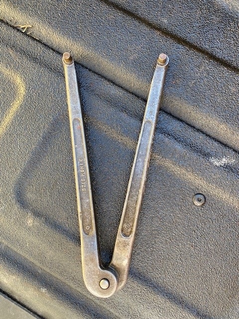

If there is no nut, how do you separate the two halves? Is that what the tool I pictured first from a&w is for?

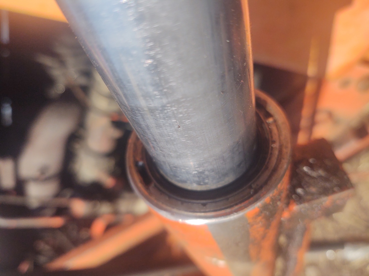

Post Options Post Options   Thanks (0) Thanks(0)   Quote calico190xt68 Quote  Post ReplyReply Direct Link To This Post Posted: 04 Feb 2023 at 11:21am
Here is a picture of one of the lift cylinders.  The others look the same.  Those slots don't look right to me though and almost like it is chipped?    Do I have a bigger problem?  Slot looks a little longer than I expected.   I noticed there are some really small slots that look factory made and maybe that is where the spanner wrench goes?
Thanks for any insight.

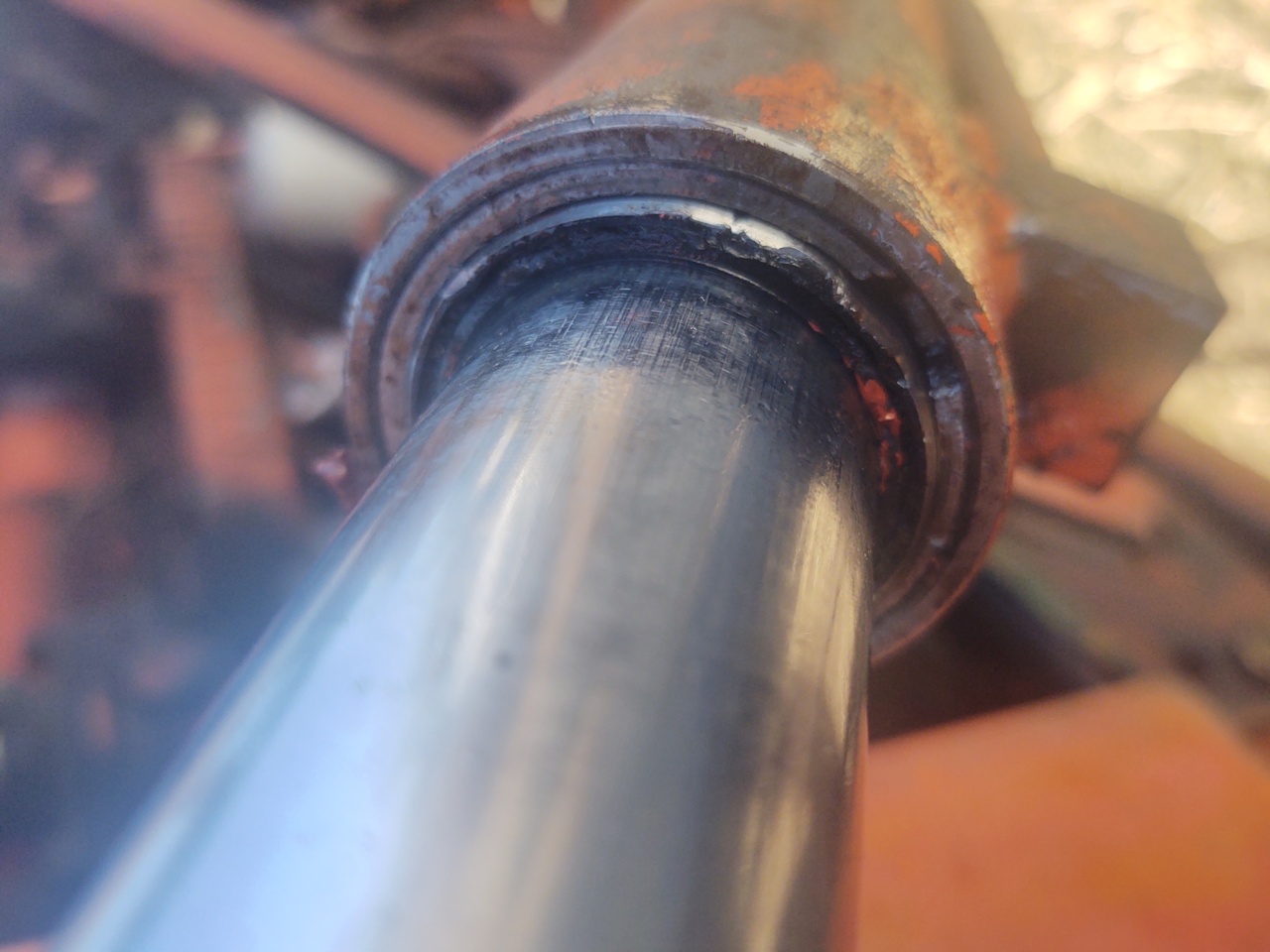

Post Options Post Options   Thanks (0) Thanks(0)   Quote calico190xt68 Quote  Post ReplyReply Direct Link To This Post Posted: 04 Feb 2023 at 11:34am
This is the other lift cylinder.  Has the same long slot but looks broke to me.

The "ears" on the spanner tool A&W sent you a picture of would appear to closely match the slots in the gland locking ring (nut) in your cylinder picture.  They look like they were turned out by being driven with a punch or screwdriver tip at some time in their life.

Post Options Post Options   Thanks (0) Thanks(0)   Quote calico190xt68 Quote  Post ReplyReply Direct Link To This Post Posted: 04 Feb 2023 at 2:30pm
Thanks and that makes sense.  I was afraid they were broke so good to know.  I am waiting on my spanner tool.  That's why you don't want to use a punch then.
