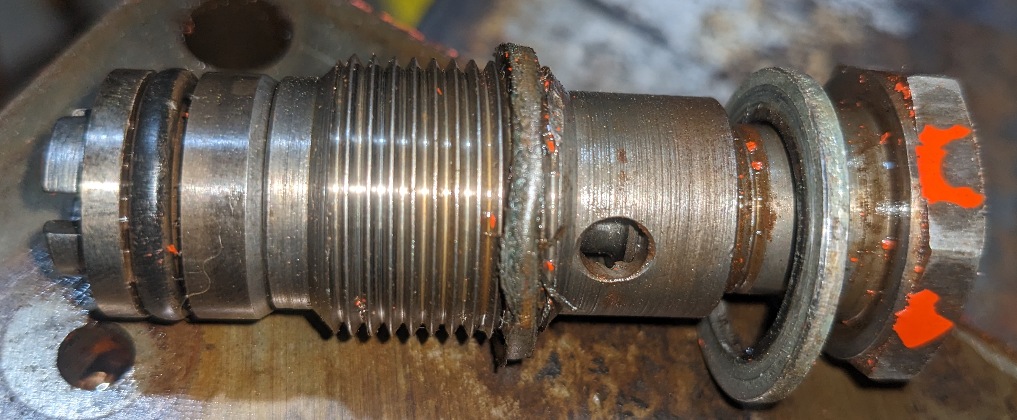

Wondering if there is anyone on this forum with experience/knowledge of the hydraulic remote option on an AC 160?  The remote used to work... I tore the tractor down for a engine rebuild and new clutch and after assembly it appears that the return flow is blocked.  When the remote valve is engaged, the engine will bog down and the loader I have attached to the remote does not function.
I have removed and torn a part the directional valves on the loader and found no issue.  I have connected a single hose to the remotes, forming a loop back setup, and the issue still occurred.
I have removed the remote valve and torn it down.  What I found is that one of the balls that rides on the valve rod was missing.  Not sure how, as this is the first time I have taken this valve apart however, it would seem from studying the profile of the valve rod that this ball would not cause any engagement in the plunger for this port.  The port in question being the one at the rear of the valve body.
As of last night I became concerned that I might have reassembled this port without the top washer/seal on the banjo fitting.  Surprisingly, it seems that this might actually not leak as expected but, testing and measurements show that the banjo bolt would actually prevent the plunger from ever moving.  This theory arose when I realized I only had 1 of these washer/seals on my work bench and have not been able to locate it.
With all that background; I am trying to find out what the actual diameter is for the ball that is used to actuate against the valve rod.  The one that was present slid into the lower lubrication channel, where this is a small magnet embedded in the copper plug that seals the drill hole created during manufacturing.  I don't think it is ever coming out... ;)

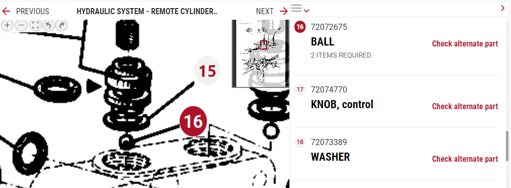

This looks like the valve I am working on.  The ball I am referring to is in this image:
Identified as #16, part number 72072675

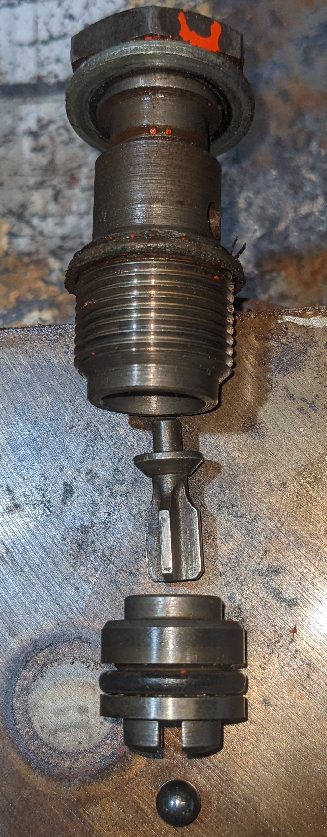

Post Options Post Options   Thanks (0) Thanks(0)   Quote nikel Quote  Post ReplyReply Direct Link To This Post Posted: 04 Jan 2023 at 8:24pm
Apologies up front if you already know what I was referring to.
Poor mans exploded view:
The ball shown above is 6mm ball I was testing with to see how well if fit and functioned.  It is not to spec, that I know of.
How the to mate when installed:

I now have an assortment of chrome balls , 1 to 8 mm in size. It seems like a 6mm ball works best.
Now i just need to get all new o-rings abd put it back together.

One more thing, that seal you are referring to is actually a set steel shims.
The piece that sits on top of the shims does not need to come out. The ball in question fits down the same bore the plunger goes into
