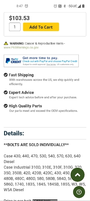

These connecting rod bolts may not be available, unless I'm just that terrible at searching for them?

Post Options Post Options   Thanks (0) Thanks(0)   Quote Hunt4Allis Quote  Post ReplyReply Direct Link To This Post Posted: 24 Sep 2022 at 7:48am
I cannot believe these are over $100 per bolt? That seems a bit insane, I could see if it were a NASCAR rod bolt or something...
Thats gotta be a typo.

you'll need to use the paypal credit to pay for those lmao! Old low rpm engines don't need the rod bolts, main bolts or head bolts replaced unless there's something wrong with them. You'll know when torqueing them if they are good, as mentioned above, all bolts are designed to stretch a small amount and torqueing them is a simple universal method of achieving that stretch. If a bolt "goes plastic" while torqueing it, in other words, just keeps stretching, it's junk, unless it's designed as a stretch bolt, like the old VW head bolts. The old Case is not like that though.
