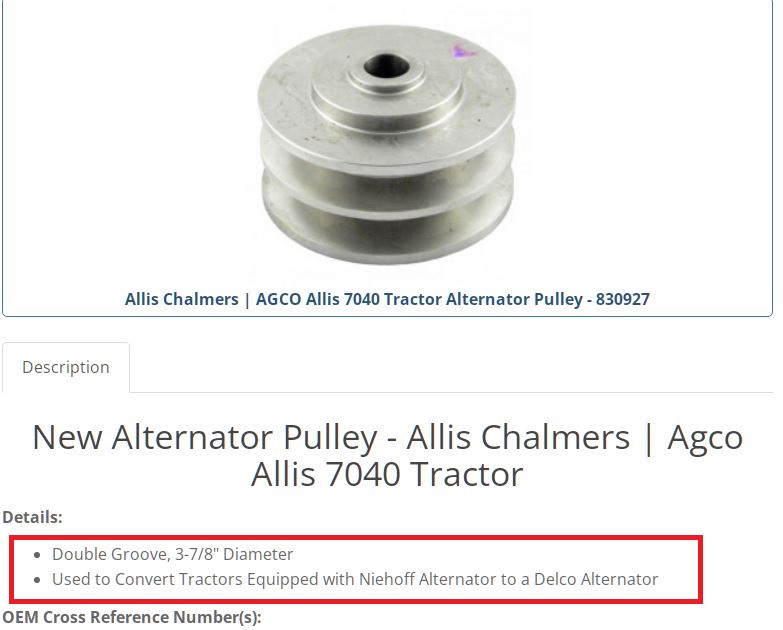

I have a 7045 serial number 3616 that came with a niehoff alternator. When the niehoff  gave up, I replaced it with the same  delco si and pulley setup that I have on my 7040. The tach then read 500 RPM'S faster at wide open. On the 7040 it's right at 2500. My question is what setup do I need so the tack reads correct. Are there multiple pulleys for the delco alts? Thanks for any feedback.
Points: 88173
Post Options Post Options   Thanks (0) Thanks(0)   Quote steve(ill) Quote  Post ReplyReply Direct Link To This Post Posted: 02 Sep 2022 at 10:28pm
your pulley is probably 3.55 inch dia

Thanks Steve! I'm going to get one ordered right away.
