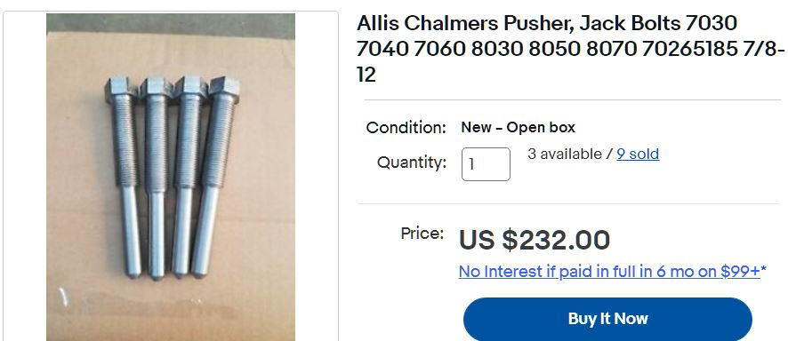

OK, now I'm REAL curious...
WHAT are 'pusher ' bolts ?

Jay,they are used to push the wheel hub off the axle wedge. Wedge has threads,hub has tapered hole bottom to match end of pusher bolt and leading inch plus of bolt has smaller diameter with no threads. Have been pictures of them on forum before
Points: 88197
Post Options Post Options   Thanks (0) Thanks(0)   Quote steve(ill) Quote  Post ReplyReply Direct Link To This Post Posted: 10 Aug 2022 at 8:37am
Points: 24728
Post Options Post Options   Thanks (0) Thanks(0)   Quote jaybmiller Quote  Post ReplyReply Direct Link To This Post Posted: 10 Aug 2022 at 8:49am
thank steve, YIKES !! $50 EACH !!!!
