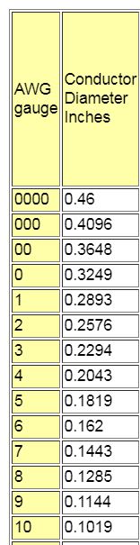

Post Options Post Options   Thanks (0) Thanks(0)   Quote steve(ill) Quote  Post ReplyReply Direct Link To This Post Posted: 21 Jun 2022 at 12:52pm
Wire diameter for different "gauge" size..
