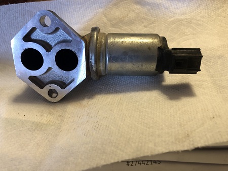

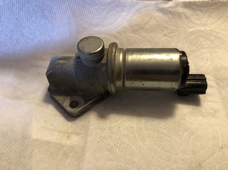

 On the way home, I started to talk to myself and what or where this is all coming from and how we used to look for leaks with a can of carb cleaner or startin fluid,,,,,?
 I had to raise the idle quite a bit to keep engine runningand went to following a vaccum hose from start point to end and after the 3rd hose,,,,VIOLA,,,the engine revs up quite a bit and stops missing,,!! after a bit it goes back to missing, so more spray, again a rise in idle but NOT on a hose,,,its leaking on this Doo-hicky bolted to rear of intake manifold and after several sprays, it is not the gasket but the body of this part.!!
 I'ma see if I can post a pic as I have no idea what this is called,,,,,
fixer1958 View Drop Down
Joined: 13 Feb 2010
Location: kansas
Points: 2434
Post Options Post Options   Thanks (0) Thanks(0)   Quote fixer1958 Quote  Post ReplyReply Direct Link To This Post Posted: 13 Jun 2022 at 2:17pm
It's an "idle air control".

 Well, a bit of an update on ole Shameless's fav trk,,,,,,I got to looking at the IAC and there is a small shaft that is moved back and forth that opens and closes a seat between the two ports on the IAC body,,,well,,the frigging shaft is frozen with both ports closed to each other,,,,Also, the little electric"solenoid"? was not working for CHIT... with 12 volts across the two pins,,SO,, this may of been the culprit that started the whole Chit-A Risky,,,,
