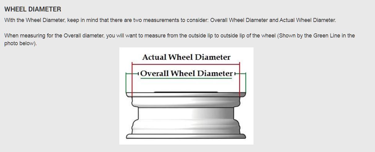

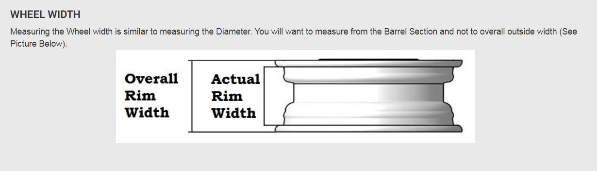

I guess im lost... The FIRST rim is 15 x 10... 15 inch ID tire and rim is 10 inches wide-- Is that the OUTSIDE WIDTH, or side to side where the BEAD sets ?
Second rim is 16 inch DIAMETER and 10 inches wide, so takes a 16 inch ID tire... again 10 inchs WIDE is pretty wide.. Is that total or WHERE THE BEAD SETS ?
Third rim is 16 inches DIAMETER so takes a 16 inch TIRE.. but is a little WIDER than the 10 inch WIDE rim..... Still takes a 16 inch TIRE...
where does the 16.1 come in ?  These are basically wagon or truck type tires... 15 or 16 inch ID and about 32 inch OD tires ???
Points: 88197
Post Options Post Options   Thanks (0) Thanks(0)   Quote steve(ill) Quote  Post ReplyReply Direct Link To This Post Posted: 25 Mar 2022 at 8:03pm
you want ACTUAL reading, not OVERALL........
Points: 88197
Post Options Post Options   Thanks (0) Thanks(0)   Quote steve(ill) Quote  Post ReplyReply Direct Link To This Post Posted: 25 Mar 2022 at 8:14pm
looks something like this... if the THIRD rim is just 1/8 inch wider or so... then its still a 16 x 10.
