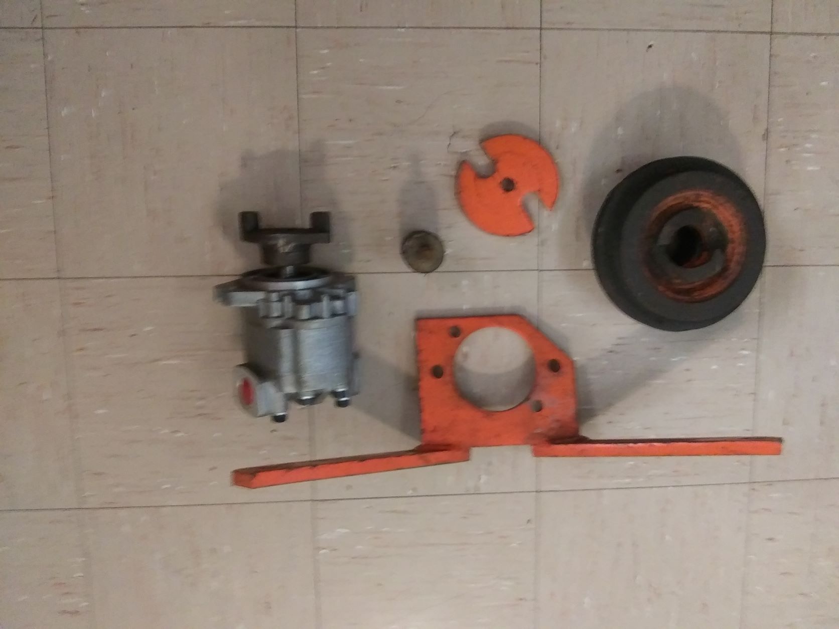

whatshould i order that will replace the pto pump for my f11? any certian brand size model  ,  loader valve is open center .  i need to have use of the pto beside the loader this year  .    and i do not want to keep taking the pump off and on. and i do not want  pto stub out of the end of the pto pump,   i think my pto pump is a 21 gallon per minute

This is the kit for WD & WD45

i have the pulley for the factory power steering ,    what are the specs. on that pump

I don’t know for sure probably around 12 gallon at full throttle on WD45. It came from Norther Hydraulics and has a 12/1999 code date. If you have salvage yard close by the pumps off of the Gleaner A, C, F will work

I bought the longest pump I could with a 5/8 shaft, and I think I maxed out at 14/gal a minute.
Not gonna fit anything bigger in that space I don't think very easily.
