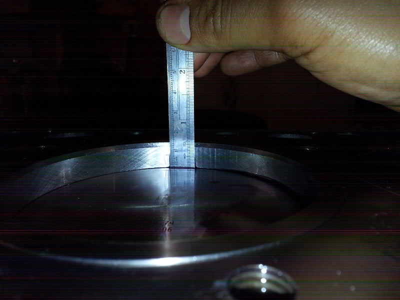

I have overbore WD flat top pistons on a 45 crank, .53" to top of sleeve and 8.86:1 calculated static CR with a stock thickness compressed head gasket, don't remember how thick. Pistons were identical measurements to original except for bore. Doesn't mean much but will give you an idea. Never dynoed or did compression test but I do have to run 30-50% ethanol to keep it happy.
