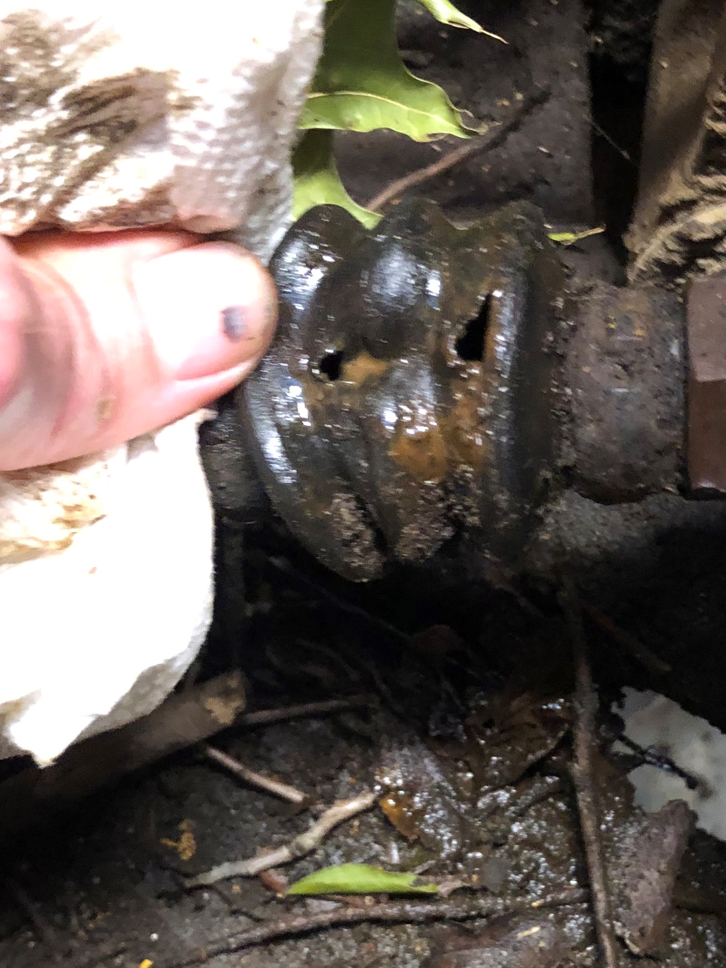

Hello All,
I thought the input shaft seals were leaking on my HD6, but after taking a closer look, the locking plunger boot has 2 holes in it.
Reviewing the parts and repair manual, there's no other dynamic seal on the plunger itself, and is the suspect in my leaking tranny.
Anyone else have experience with this one?  They're available aftermarket through General Gear.
Also, will the plunger come out the front of the transmission without other disassembly? Or can I replace it without removal?
Thanks, Joe

The locking plunger can be disconnect to the rod yoke and if you whant removed the plunger from the front you have to removed  the sleeve locking plunger and pull the rod and if the transmission is over full the oil will leaking some were

general gear  @  www.tractorparts.com has new boots and driveshaft seal kits

Thanks Cal,
I called them and ordered the boot, going to try it first.
