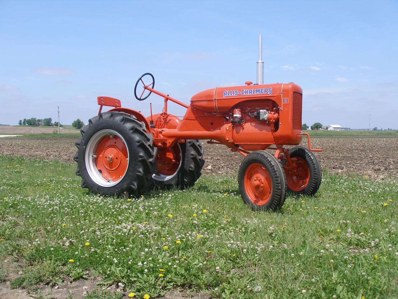

This is a 1940 modified to use as Orchard ( low profile), but the paint and decals are correct.

How about the front rims? Was there a silver lining?
And also the muffler.  I really like the looks of this one.
Points: 87582
Post Options Post Options   Thanks (0) Thanks(0)   Quote steve(ill) Quote  Post ReplyReply Direct Link To This Post Posted: 11 Mar 2021 at 9:25pm
no, the front rims were solid orange..on all B and C tractors.
a lot of the Bs had that tall muffler... I dont really know if there was another option, or changes aftermarket over the years........

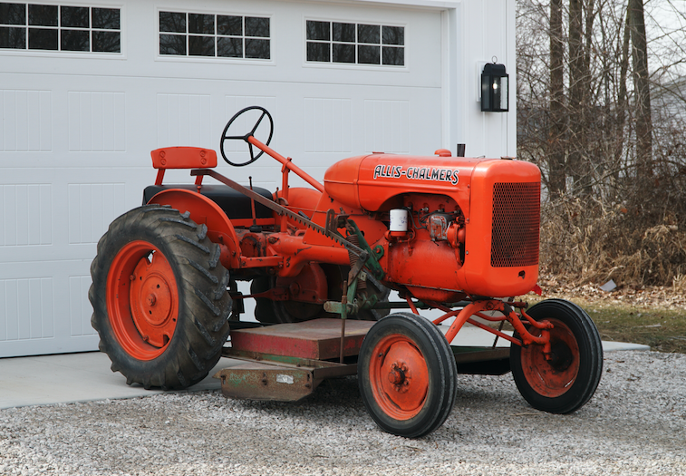

Is the tractor in this picture Persian Orange #2?
Points: 87582
Post Options Post Options   Thanks (0) Thanks(0)   Quote steve(ill) Quote  Post ReplyReply Direct Link To This Post Posted: 12 Mar 2021 at 4:17pm
I would say it is PO1 , pumpkin color... and just looks a little redish due to camera and time of day / lighting..... my tractor ( orchard) above is PO1........ cant believe this guy went to all that work, correct decals, etc.. and used the wrong paint.

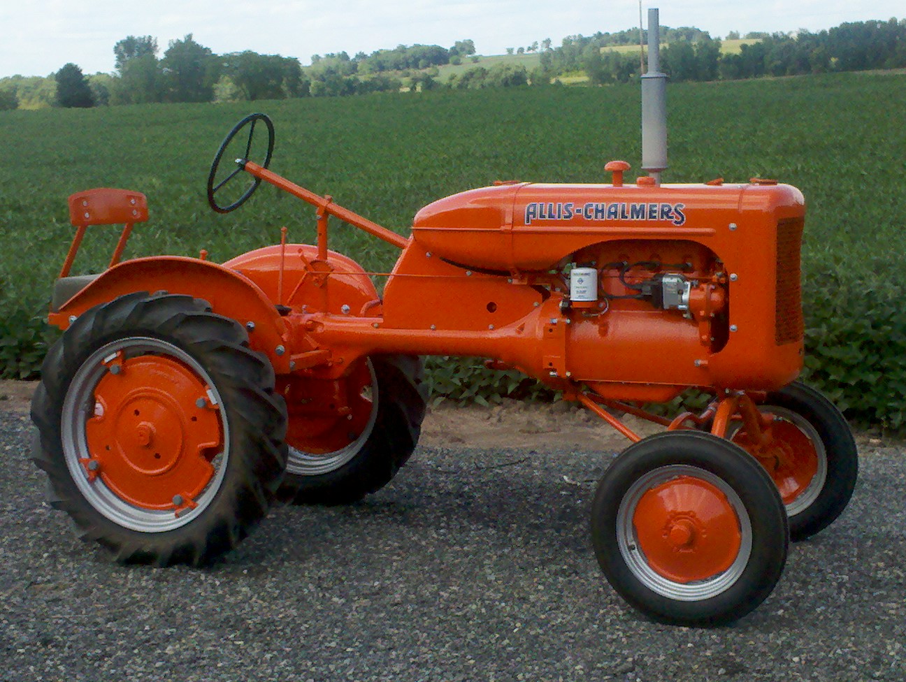

Here is a picture of one in the sunlight.  Similar to the first one I posted.  Looks like Persian Orange 1, Blue Lettering, and only silver lining on the back rim.
I want to restore my 1940 to look just like it would when it was new, but I really like the added silver lining on the front rims.  Hard to decide.
Points: 87582
Post Options Post Options   Thanks (0) Thanks(0)   Quote steve(ill) Quote  Post ReplyReply Direct Link To This Post Posted: 12 Mar 2021 at 6:39pm
Cactus, there are a few that are "original" , but most people like to modify a little to suit their needs.. I like alternators and 12 volt systems... i like a push button start ... Decals and Paint look good original, but everyone likes to put THEIR final touches on them.

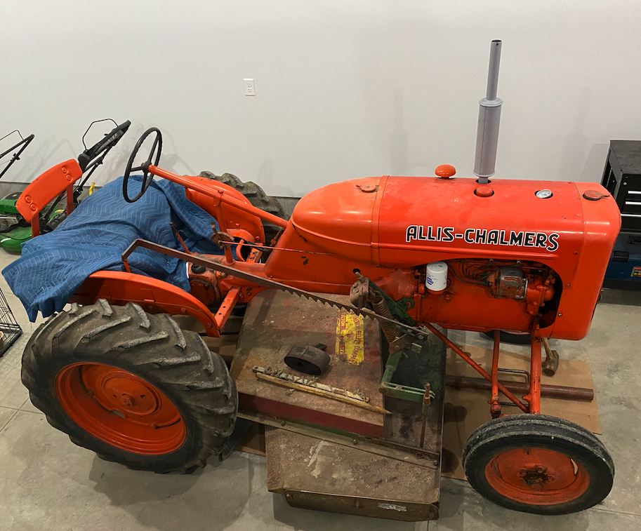

Bought this new muffler today at an Allis-Chalmers shop.  Planning on installing it tomorrow.  The shop told me this would be a period correct muffler and would’ve had the same silver finish. Any advice for the install?
1939Dodge View Drop Down
Joined: 18 Jan 2014
Location: Pa.
Points: 554
Post Options Post Options   Thanks (0) Thanks(0)   Quote 1939Dodge Quote  Post ReplyReply Direct Link To This Post Posted: 14 Mar 2021 at 11:45am
Have an appropriate pipe nipple available in case the manifold pipe is rotted.
Buy  a rain cap.
Make sure you have the support bracket that ties the exhaust to the manifold.

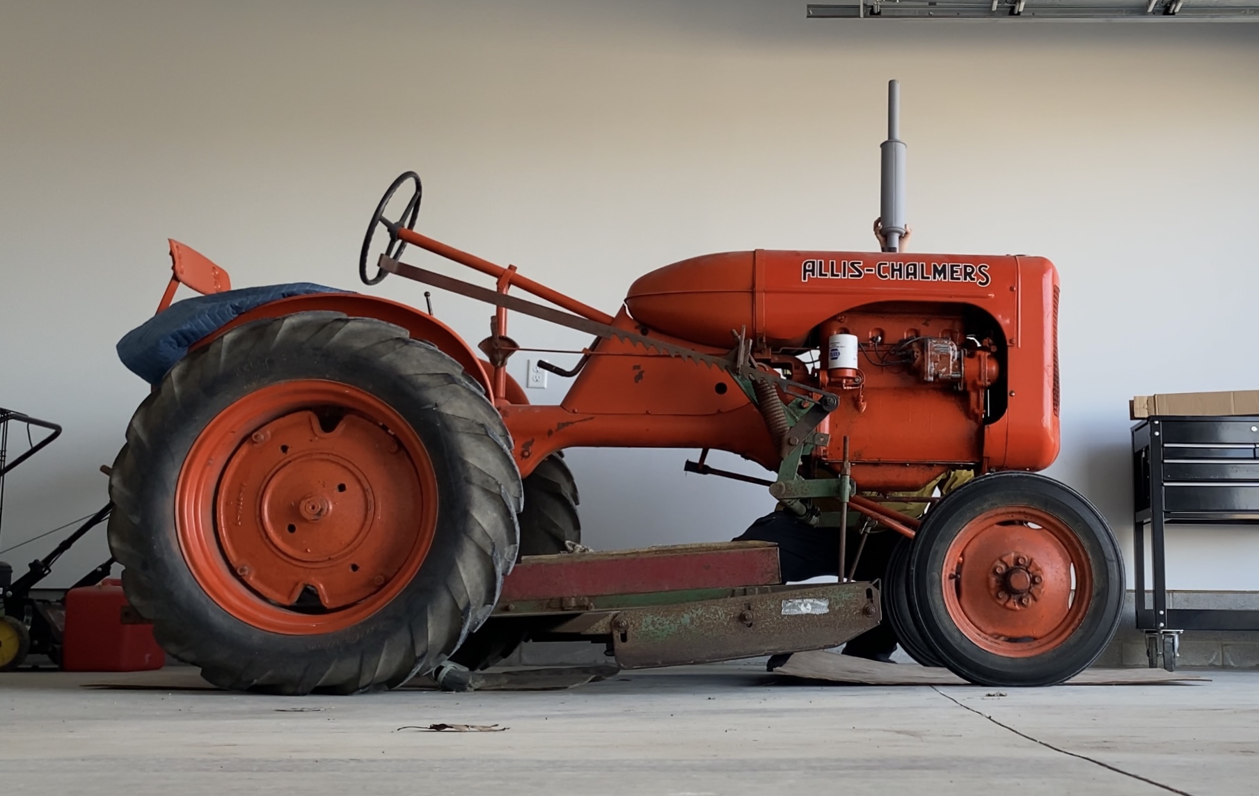

Installed the muffler last night.  Realized afterwords that my tractor appears to be both Persian Orange colors (1 & 2).  Someone must have swiped parts with it at some point.

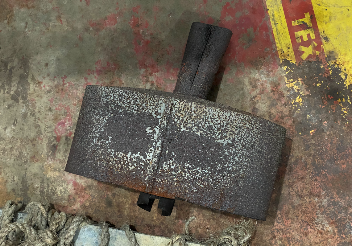

The original muffler.
