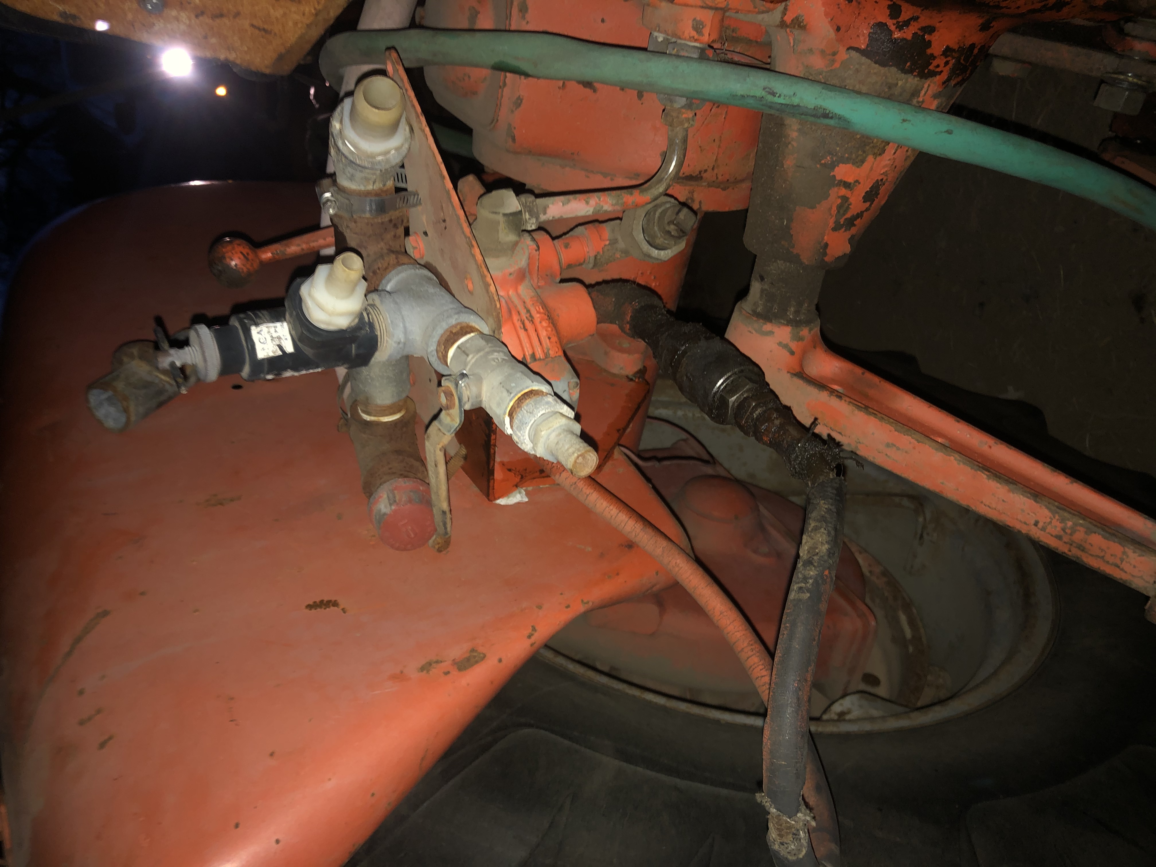

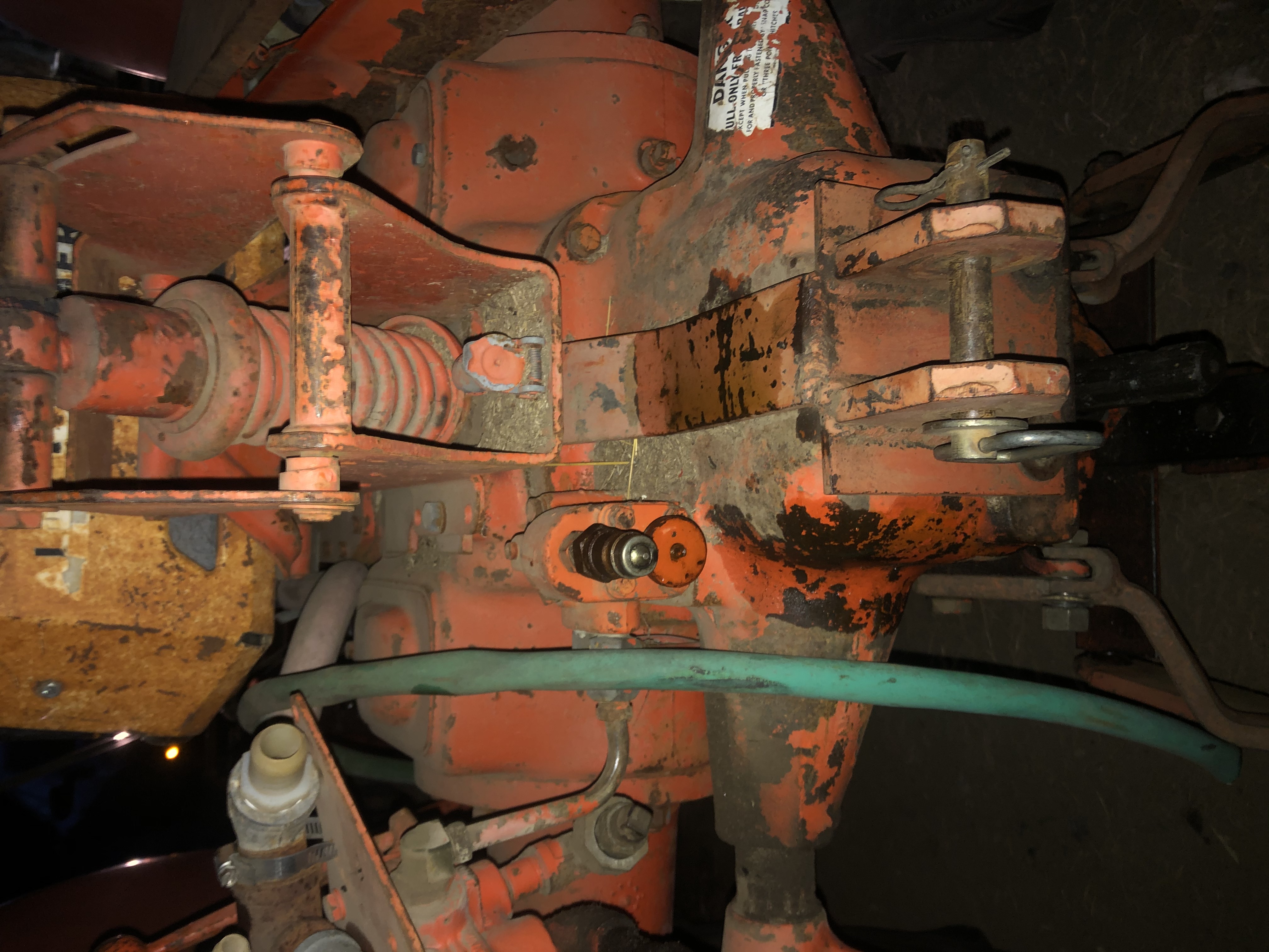

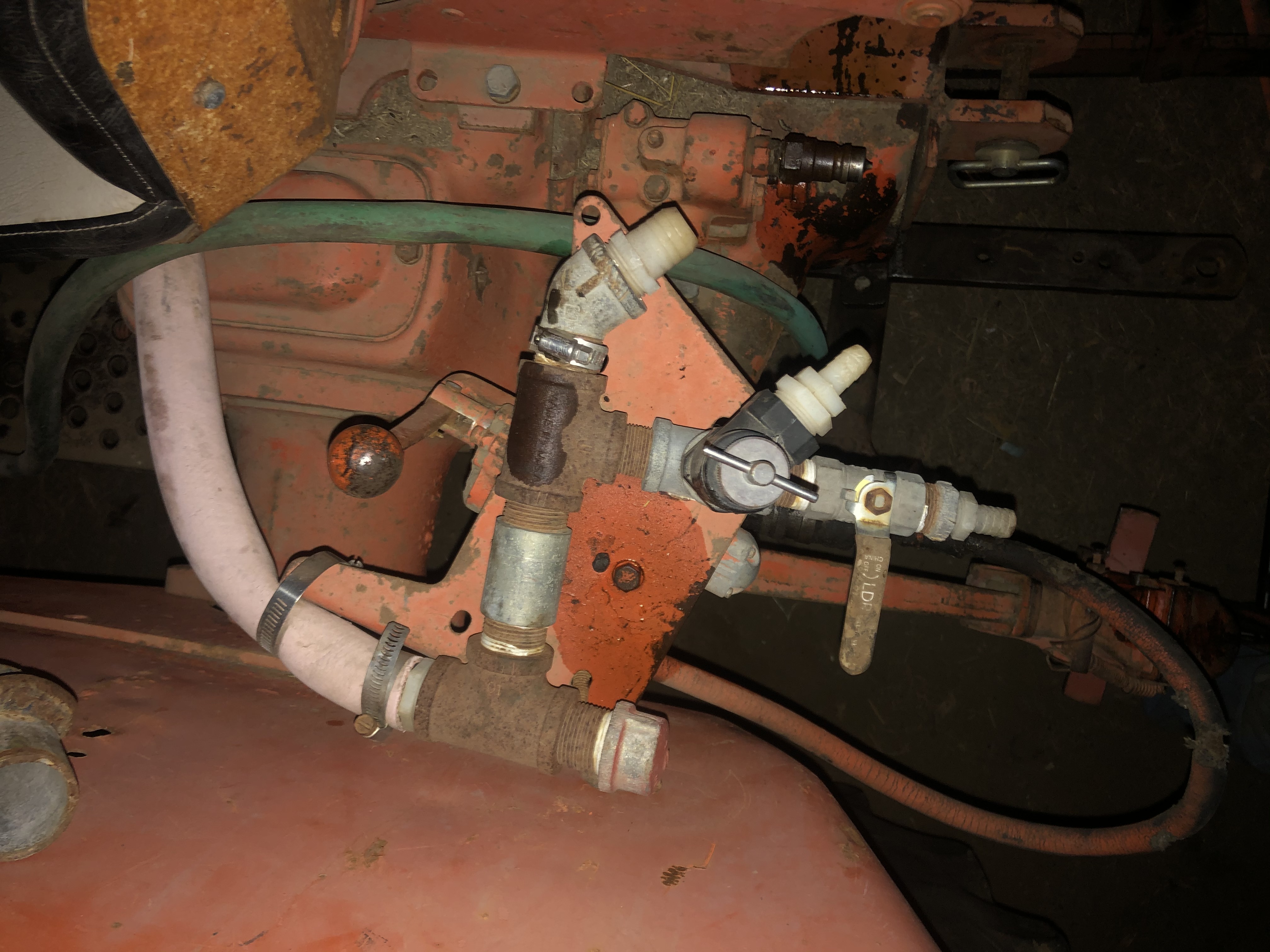

I have a allis chalmers D17 with auxiliary hydraulic control and I have a John Deere 949A planter I am trying to move but I can not seem to get the hydraulics to activate I was wondering where it would hook into I have attached some pictures of the hydraulic setup on it. Ignore the hose connections this tractor was used for spraying.

Do you have a one way or two way cylinder? One way would connect to where a line is now connected . Two way , one hose would hook same place, other would hook just behind on line that looks like it has a plug in it. Lower picture .          MACK

After looking at picture, you should hook to point on tractor. To use remote valve , there needs to be a hose from point on tractor to left side of valve.             MACK

So would it go at the connection on the left where there is a hose already there or on the connection on the right where the plug is

If the orange hose next to finder goes into valve, it should plug into back of tractor.         MACK
