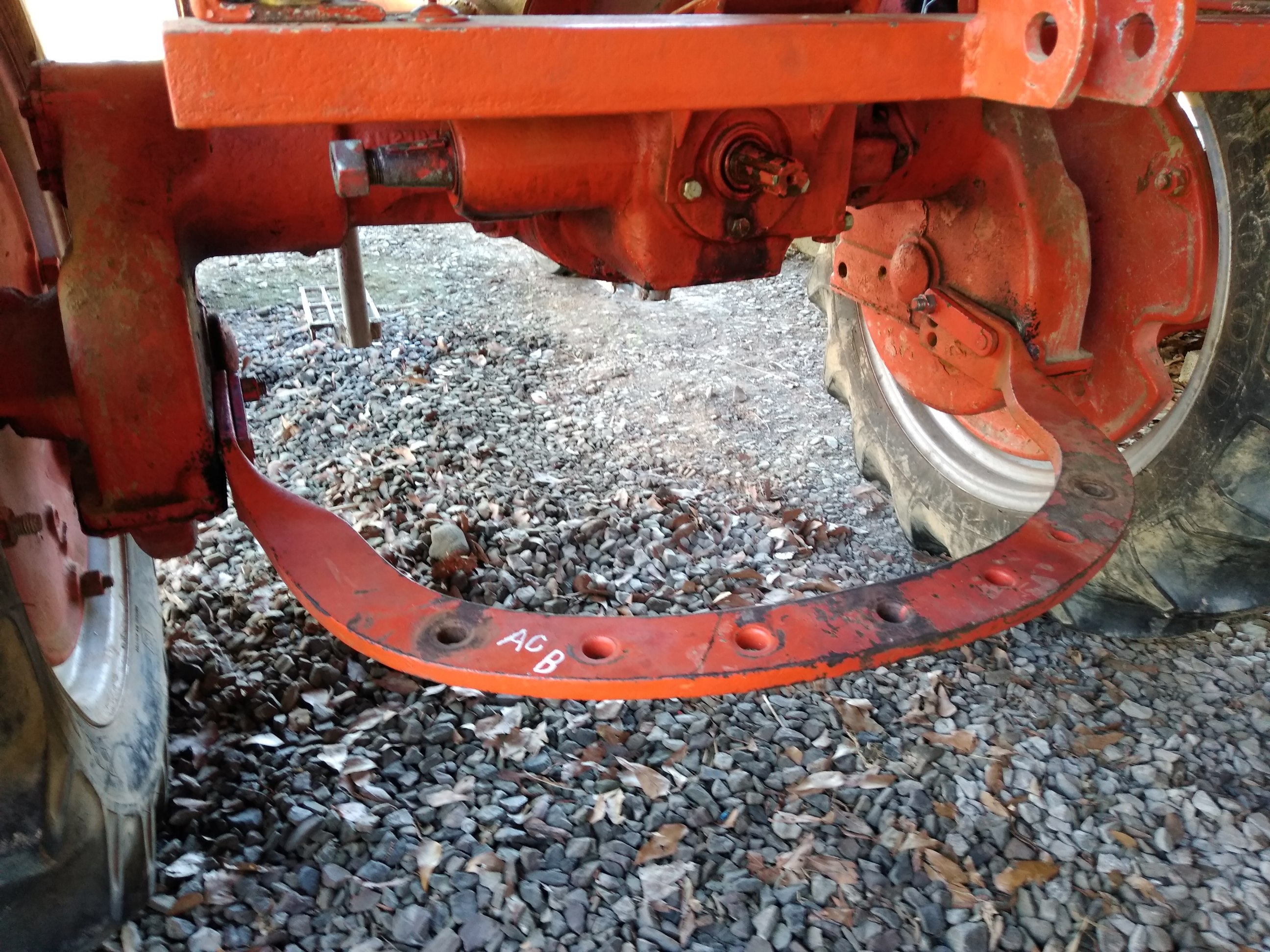

This looks to be an original B drawbar, but it doesn't look like everything needed to get it in working form on the tractor.

Yes John that is the swinging drawbar, the "a" shaped piece bolts to the "u" shaped piece in the direction they are facing. Then the drawbar "fork fits the "u" piece and bolts to the "a" piece.    It seems to me that you don't see many B's with this setup.   Bill Long will be able to tell us if it was standard equipment or if it was extra........ right Bill?

The only thing that looks to be missing are the "Hammer Straps" to attach the drawbar to the final drive housings and a couple of bolts to attach the swinging drawbar U piece to the standard drawbar.

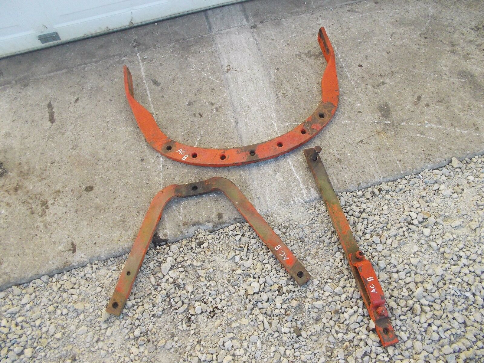

there are two BRACKETS that mount the U shaped drawbar to the final drive case.. and there are two BRACKETS that hold the drawbar up to the seat frame
vertical braces below
attachment bracket / pin for each side into final drive case

I cant find the EXACT drawing now.. Very similar drawing in the AC - B or C "operating instructions and maint manuals"... part no 257986 or 257985.
You can make the hanger straps from various things.. I have one tractor that has like 1.5 x .25 inch strap .... i have one that has  turnbuckles someone obviously bought at the hard ware store.......... and i have one that has 1/2 inch allthread.... Probably costs $10.... i think a lot of guys decided the "needed" the anchors and  "home made" them.  The "standard" drawbar did not include the straps...the "ASAE" did... PULLING is ok... If you want to put down pressure on the bar ( trailer hitch, etc), then add some type of straps.

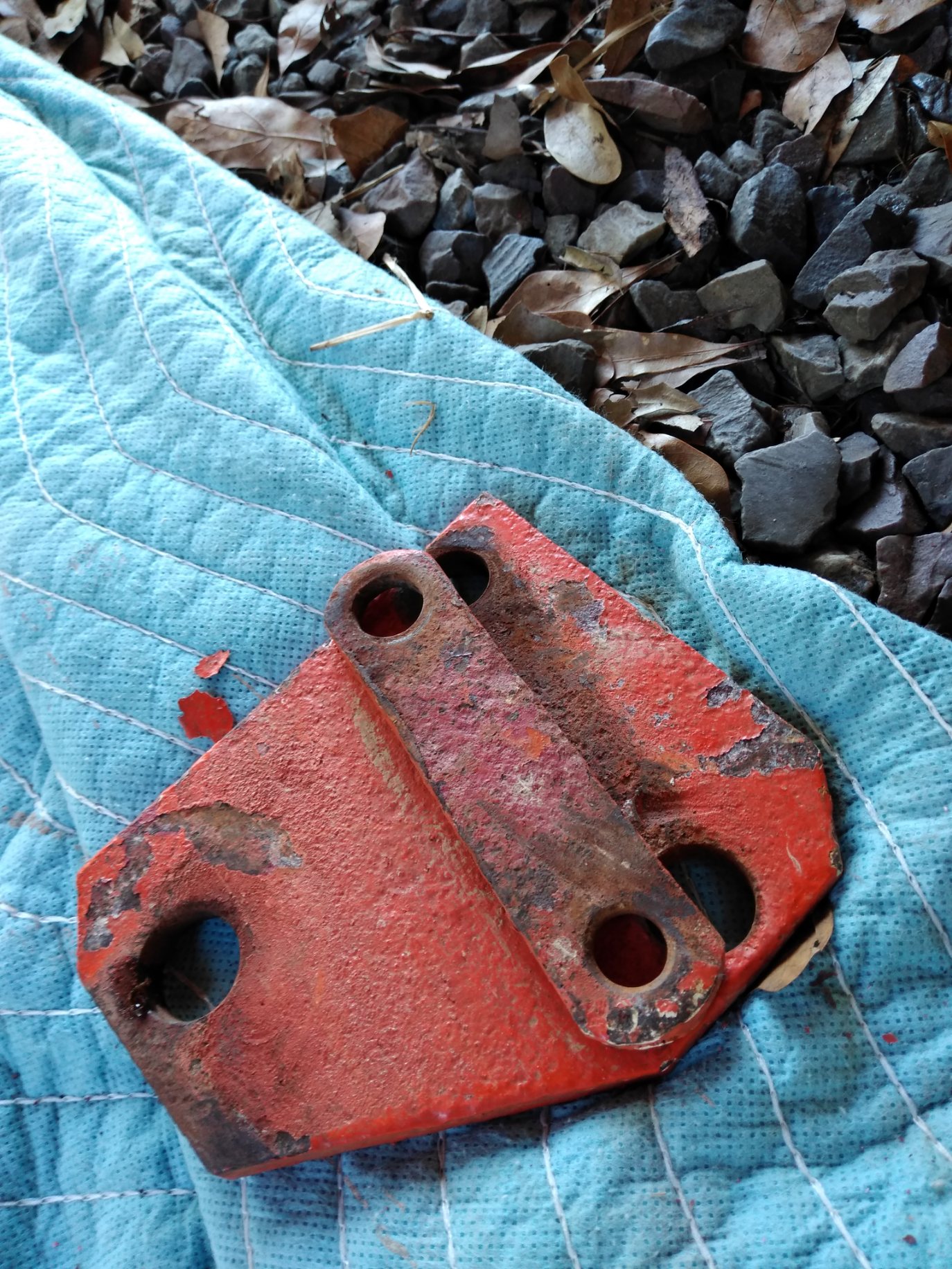

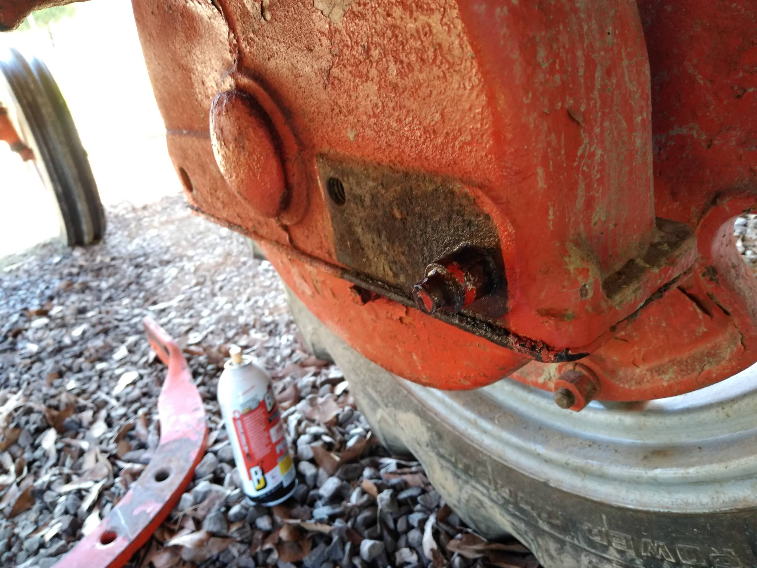

Well, it's never as simple as it should be.
Somebody manufactured the pin assemblies on both sides. I was able to get the threaded cap bolts out with no issue, but the clamp pin is another issue altogether.
Here's what the situation is. First picture is what was on the tractor. Second picture is the right side final drive unit, and the clamp pin, or what looks like is left of it. Both sides are the same. They're not coming out, and both look to have been broken. Were I able to get the drawbar on, it would suffice, but that's not happening. The old farmerized drawbar was either purchased (or manufactured) with this setup in mind, or when it was installed, something broke on the clamp and somebody improvised.
All guesses on my part, obviously. Only way I can see to get that out, is to cut and drill. It's not budging, and I don't think it would be a good idea to heat it with what would be necessary to break it. Unless I'm missing something.  I'm open to suggestions.

Post Options Post Options   Thanks (0) Thanks(0)   Quote steve(ill) Quote  Post ReplyReply Direct Link To This Post Posted: 26 Mar 2021 at 7:09pm
It kind of looks like the original pin was stuck in the hole and would not come out.. The guy cut off the "bar" and left the "pin" in the hole... Then made a 2 piece draw bar to fit over it ? ..... You could check the diameter of the PIN sticking in the case and the diam of the HOLE in the new drawbar to confirm this. .... If that is the case, then you need to get ONE of the pins out of ONE final drive.. You could then slide the drawbar up at an angle and pilot on the ONE STUCK PIN.. then lift the drawbar up and put in the OTHER PIN... Your "PIN and BOLT" on one side could be two pieces.. dont need the strap between them.
 I think i would try to grind the outside 1/2 inch of the pin and make it square. Get an impact stocket and impact gun and try to BUDGE it... I think some heat would be OK.. Not much there you can hurt........... If all else fails, you can cut if off flush, then drill a 1/4 inch hole thru the center of the pin, then keep going up in size until your NEW pin fits.
if you look at your NEW PIN/ BOLT ......(BELOW)..... it does look like the guy cut the ARM off and left the PIN in the hole.... I have seen quite a few TIGHT ones.. I have sprayed with penetrant like you, then beat on the arm trying to TWIST it .. and have the arm break off... HEAT is normally your friend, and impact  will help instead of hammer.

Normally you would heat the case to EXPAND it to remove a stuck bearing, etc... In this case i would heat the PIN... it will have to transfer  THRU THE RUST to get the case warm / hot... that should break some of the bond loose.

A close look at the inside drive casing, especially the right side, it appears as though the plug is part of the case housing. Wacko
It's going to be a hoot, trying to grind those plugs square, not slipping and "decorating" the inside drive housing with "character" scars. Tongue

John. the plug is not part of the case. They are PINS that are heavily rusted into the hole.. You need  HEAT and BEAT to get them out.... IMPACT or weld the plate back on the PIN and beat back and forth as Dave said.

i just had to do that on a c that i just got,  just start working the pin with a pipe wrenchand blowing air around it to start clearinig the rust it will come out or weld a 1 inch nut to it it with a little gap gap so you can pry and turn then put a new piece of round on the strap and be done with it

Well, it's done. My neighbor was hesitant to want to apply oxy, even though I told him I wasn't going to hold him responsible.
Sooooo.... it was drill baby drill.
Finally got it done yesterday. Using a battery run drill and a power drill, finally got both sides deep enough to put in the new clamps. The power drill broke away from me a couple of times. Sore hand notwithstanding, that could break one's hand, considering the angle one has to work to drill in that area.
