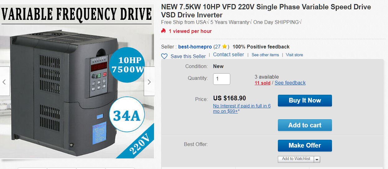

YEs Joe... the small 2 HP VFD above was from Amazon.
I looked on e-bay for a 10 HP Phase Converter.... this will be a box full of capacitors that SIMULATES the third leg for a 3 phase motor using only single phase input.  There is two sets inside. ONE is to start the motor rolling, the other is at operating speed. It would probably have a small timer  / etc inside to switch from START to RUN mode... Not bad for $200.
Points: 88586
Post Options Post Options   Thanks (0) Thanks(0)   Quote steve(ill) Quote  Post ReplyReply Direct Link To This Post Posted: 27 Dec 2020 at 4:54pm
Most of the VFDs that will handle 10 HP are about $400...  I see a "new brand" on e-bay for $165- 200.   I assume China.. it does say 5 year guarantee, what ever that is worth..
Again... THEY DO NOT CHANGE VOLTAGE, just FREQUENCE.. Your 3 PHASE motor has to  have a 208 - or 240 v TAG on it.
