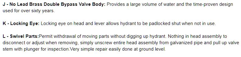

I can't remember the brand I like the most.(senior moment?) painted green, it s repairable, from the top, no digging.
When replacing hydrants, I spend the money, up front, I hates diggin in the cold, seems like that's when they fail...
On edit, I found the name, its a baker!  see link below.
92 PSI pressure sounds pretty damn high, I think that may be your main problem...
Interesting, hadn't heard of them but according to their site these are rated up to 125psi.Shocked  Sounds like a pretty good hydrant.
Have you DONE the "repair from the top" fix ?? I just CAN NOT imagine lining thigs up 4' down in murky/muddy waters ??
Points: 88173
Post Options Post Options   Thanks (0) Thanks(0)   Quote steve(ill) Quote  Post ReplyReply Direct Link To This Post Posted: 07 Dec 2020 at 6:10pm
Read "L" on the Baker unit..........
