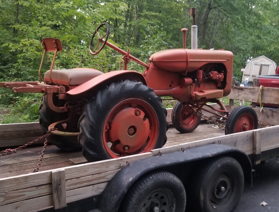

What am I doing? Picked up a B today from my daughters old boyfriend. This tractor makes 7 Allis Chalmers...
They broke up and he lost interest in the Tractor Hobby. The tractor sat outside for three years.
I had done a head rebuild about 10 years ago with him. It was a great looking and running B. Now its stuck tight.
Got it home today, took the plugs out and there was some rust on the ends of the plugs. Shot PB Blaster down the plug hole. I'm hoping with time it might loosen up.
The tractor is crank start only. No ring gear on the fly wheel. I tried rocking it back and forth while in 3rd gear, no fan movement.
I don't want to pull another motor, I have a million projects ahead of that one. I've already rebuilt a CA that probably has about 1 hour if that on it.

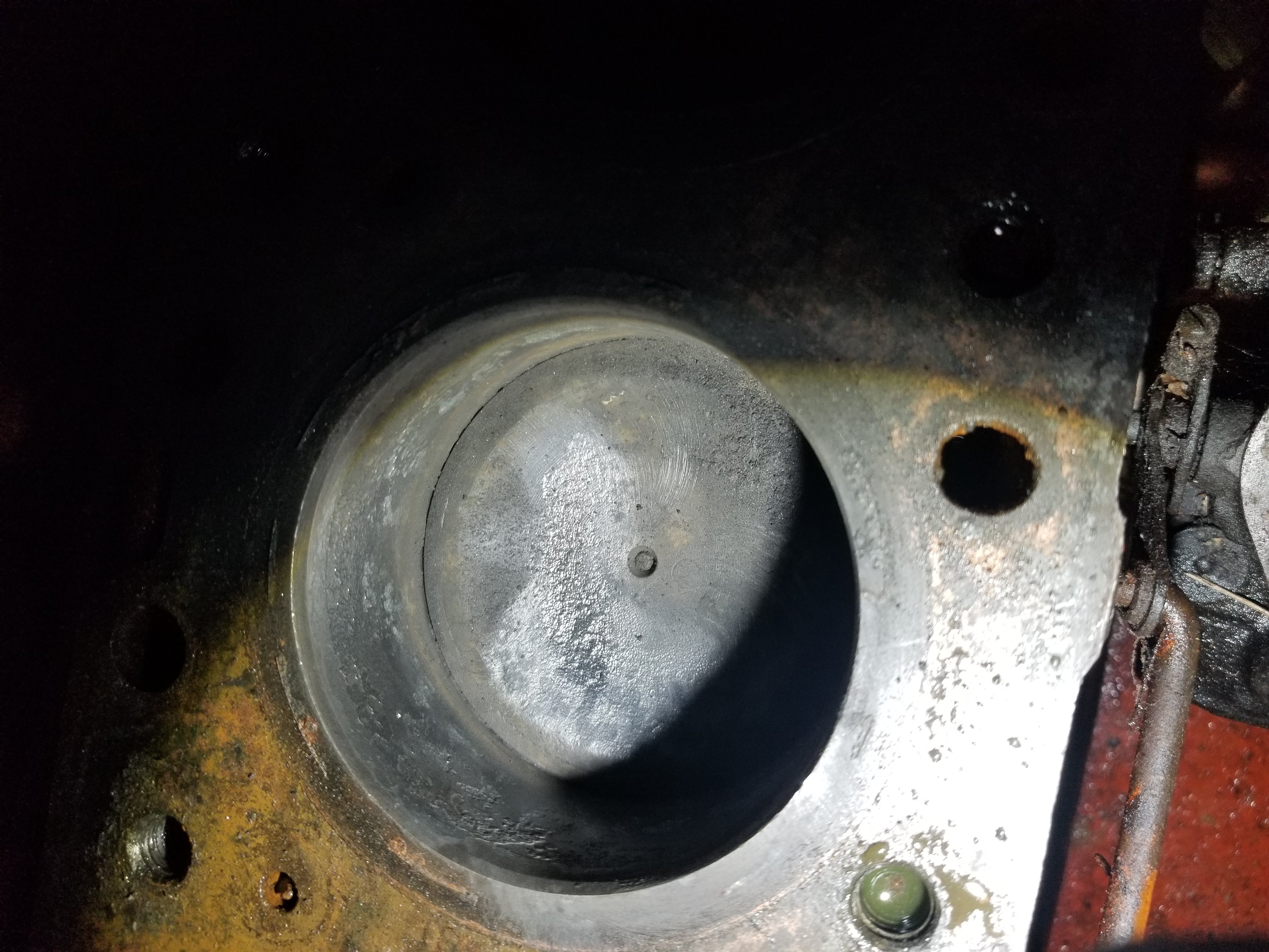

Waited almost two weeks on the acetone and no luck. My brother helped me pull it with my C, no luck, frozen solid.
Decided to take the advice and pull off the head. Took about 1/2 hour, head was off. Lots of water with acetone in 3 and 4. 1 and 2 full of deep rust. Surprisingly 3 and 4 looked good....

thats the problem i have run into.. When you have corrosion 1/16 inch deep into the cylinder walls, you are NOT going to get it to run, even if you break it loose... The AFT story is for surfac rusted or stuck WITHOUT any extensive corrosion..
Your going to find the rings are frozen in the pistons also.

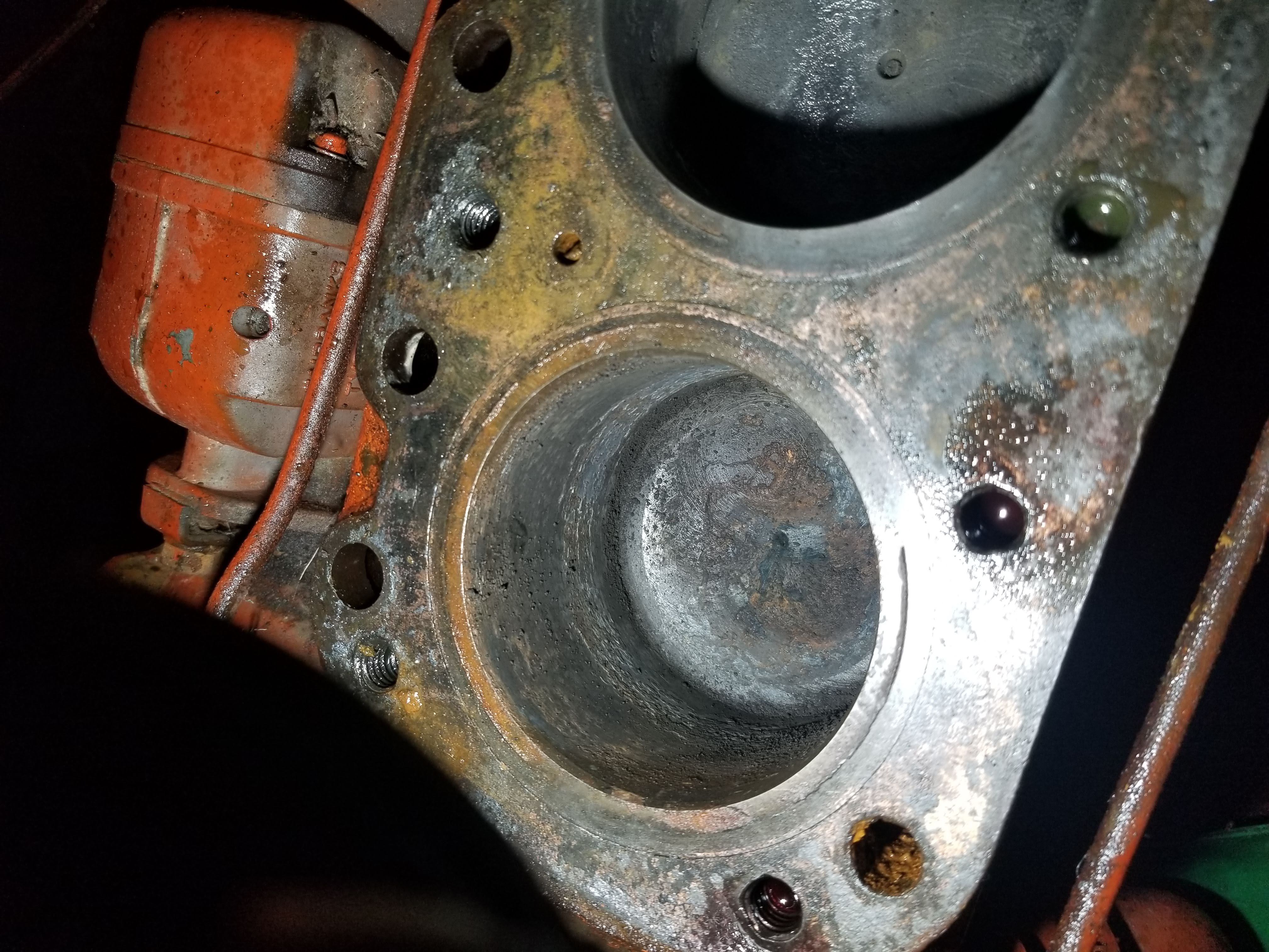

Agreed, those cylinders are toast. He must have left the muffler open. . The tractor was not tarped..
I store my tractors outside. Always tarped.
I always pull my pipes off, easier on the tarps, plus I put the weather flaps on my pipes in case I fail to tarp when I am using them. I always put a rock over the manifold hole in case the tarp blows off.
Hopefully the crank is ok. I have already rebuilt the head, will look that over today for rust... Not hopefull. Where do I get an low cost jug and piston set and why do I need 7 tractors?

I am betting you are thinking that it will not get run very much and cheap parts will be fine.
When you are doing the overhaul, the costs of gaskets. machine work and labor are the same whether you use cheap or good quality parts . You will be much happier in the end, if you use quality parts.
My advice is buy 4 (not just replace the 2 bad ones !) new sleeve/piston/rings assemblies and do the job right.
