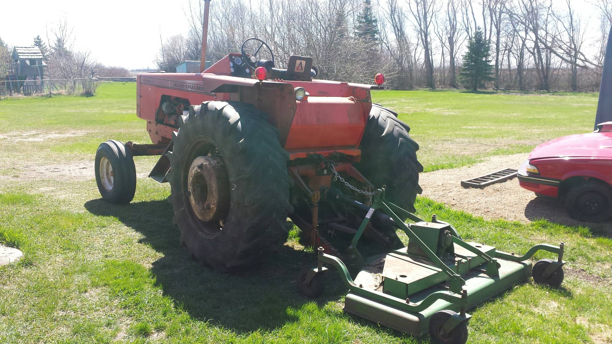

 My friend Jim brought his spare JD272 finish mower over for me to use and work on to get it to where I could use it. I did fix a couple things, greased it up checked the gear box oil and mounted it to the D17. That and the Ford Jubilee are the only two with 3 point.
Here are some pictures:
First off, Maggie just could not figure out why we were working on something yellow!
The drive shaft had been scored and did not slip at all. Got that strecthed out and cut off 6 inches of the outer tube. This allowed it to be able to slide a little better,
Patched a orange sized hole in the deck:
Took the guard off and cleaned the hickory nuts out.
Dog is still unclear as to what the heck we are doing!:)
So this actually did not fit this tractor to bad. It is a big mower.
I attempted to mow our yard today. Looks like overkill? Well it wasnt! I almost got the D17 stuck in the soft yard. Mower did pretty good. I think when the ground drys up this may actually work. Maybe a little better on the Ford?? Yes the owner wants to sell it. Trying to decide if I need another toy?:)

The dang squirrels and mice love to pack those dog gone nuts under those shields. Hope it works out for you.

I have used my 6 ft buell farm King on my 190 it worked well. Had it on the CA it cut good but I couldn't lift it and steer. only thing when severely overpowered it's easy to turn the belt into smoke.

I pulled a 6' woods with my D14 for years.  It was a real good match.  The belt routing looks the same on that one as it did on my Woods.

What I find ironic is if you remove the labels from that deck and the one under our Deere Mower Garden tractor they look IDENTICAL.

That rear tracked machine is awesome! I had never seen one of those! That would work for me. Except I cant ride one. I have motion problems and would be sick in less than a hour!:)
 But that is a very neat machine!
I may try this 272 on the Ford. We have a lot of ground to mow at our local tractor show grounds. I want to add a 6 inch offset pivot hitch on the back of this deck to allow the 5 foot Swisher tag to be off on the left side. Should make a nice mower set up. The Ford is a ton lighter than the D17. If it has the power to run it and the front end stays on the ground?
I will report on that set up. Right now I am trying to get the syrup wood cut and the Ford is doing the work on that too. The Allis team just sets there and watches!:)
I also have another grass cutting machine to work on. A pull behind brush hog (5 foot) that needs a lot of attention on the rusted out sheet metal. Not even sure its worth saving?
My vote is for the Ford. It's nimble, light, and will use 1/2 the fuel of the D17. I use a 6' Frontier finish mower on my 8N and it walks through 6" grass like there's nothing there. I generally mow in 2nd or 3rd gear, occasionally 1st if it's really thick. No front weights, so shouldn't be a problem for a Jubilee at all.

Victory, I was smiling when I read this! That was how my lawn was the other day. My regular Cub Cadet mower was buried in the yard by the orchard. I had to unhook the wing mowers and drag it out with the Ford. Just like playing in the sand box!
Folks,
 So yesterday was to be the trial for the Ford Julilee and the 272. Well they did not want to play together. The Ford has a stub spline extension that brings the PTO up to today's standard size. With that in place the PTO shaft of the 272 mower was too long to be able to be installed. I forgot to just try to lift the 272 with the Ford. I assume that will be ok.
So back on the D17 the mower went. I loaded it up and took it to our local tractor show grounds. It mowed very good. 3rd gear high range. 3/4 throttle. It did a good job even in some taller grass. I mowed a couple hours and the tractor used about 1/4 tank of fuel.
I really liked how it mowed. Loved the D17 power in the heavy stuff, the power steering on the D17 in the corners was nice too. I was not worn out after the event like on the smaller IH Cub's with the 60 inch Woods decks. They bounce around a little more, not as easy to get on and off.
So it was a good test of the 272. Seriously thinking of buying it. Friend wants $400 for it as is. Seems to be in good working order.
I am not sure, but maybe I can get a PTO shaft replacement that is 6 inches shorter?? So it would fit the Ford?
I did add a hitch on the back of the 272 so a Swisher could be hooked up too. did not get a chance to try that as this was the first time over the yard and it had a lot of tall grass that needed whacked down first.
