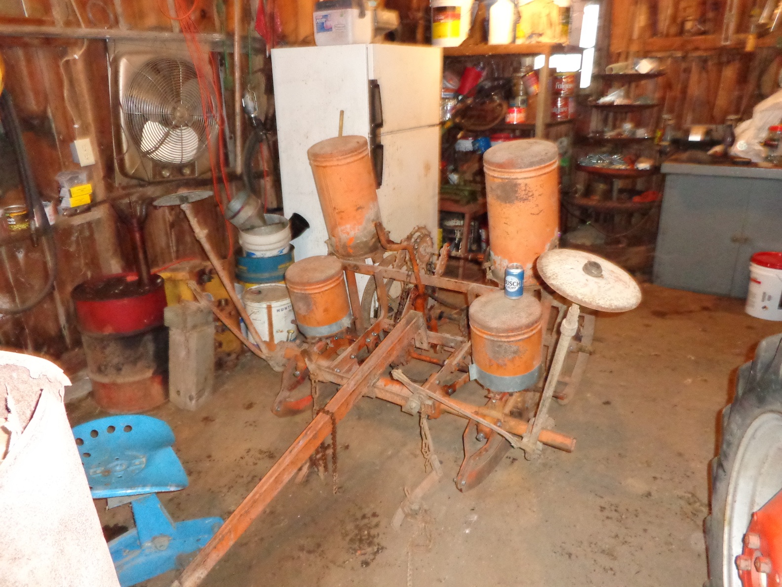

I have a snap-coupler two row planter I've been working on for quite a while now. I'm getting close to having it together and ready to plant some sweetcorn. What I need to know is; Is there a chart somewhere that explains how to set the population? There are nine sprockets total, might be more. I only have the ones on the planter.

Post Options Post Options   Thanks (0) Thanks(0)   Quote IBWD MIke Quote  Post ReplyReply Direct Link To This Post Posted: 17 Apr 2020 at 2:19pm
Here's a little update on this planter. I bought it from Don Bradley three years ago, (I think). He asked me how I was going to haul it home. My big trailer was tied up so I said snowmobile trailer. Well, he took it apart so it would fit. Wound up hauling it on my uncle's car trailer so it wouldn't have needed to come apart but hindsight you know. It came with a parts planter too. So for about the last year and a half it's been taking up a bay in the garage. Decided this year I'm getting this thing together and out of here!
It will be a nice tribute to Don to plant my sweetcorn with it.

Post Options Post Options   Thanks (0) Thanks(0)   Quote Sugarmaker Quote  Post ReplyReply Direct Link To This Post Posted: 17 Apr 2020 at 4:24pm
Mike,
 Very nice! Don would be tickled too!
Thanks for posting the picture.

Post Options Post Options   Thanks (0) Thanks(0)   Quote nella(Pa) Quote  Post ReplyReply Direct Link To This Post Posted: 17 Apr 2020 at 4:56pm
I planted 25--30 acres of corn every year in the 1950-1970 years with my WD and that exact model planter. Got in trouble when one split boot got blocked up and had one row of corn missing for a few rows. Sold it about 3 yrs ago to a Mennonite church organization, it went to a country in Africa. Had it hanging on the wall in the upstairs of the barn for many years.
Dose this ever bring back good memories!

Post Options Post Options   Thanks (0) Thanks(0)   Quote Ted J Quote  Post ReplyReply Direct Link To This Post Posted: 20 Apr 2020 at 2:22pm
When you get it working right Mike, take some good pics of how the chains go on it.  I'm trying to make one planter out of two and I know I need to buy some gear/sprocket chains, but first I need to know where they run to.

Post Options Post Options   Thanks (0) Thanks(0)   Quote IBWD MIke Quote  Post ReplyReply Direct Link To This Post Posted: 21 Apr 2020 at 2:04pm
Ted, here is a pic of the drive chain, It's routed the way shown in the book, I think. Hope this helps.
