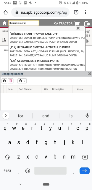

I'm not sure if this is correct but it looks like there might be a kit from agco?

Don't buy the kit. It has a lot of parts you don't need plus expensive. Replace the 4 springs above check balls, as they break and stick spool valve. 4 big orings in body and one small one between hold poison valve and pump body. There are 3 in hold poison valve that won't be needed unless it is leaking. 3 gaskets you will need. Good luck.        MACK

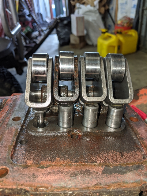

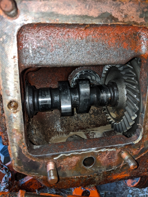

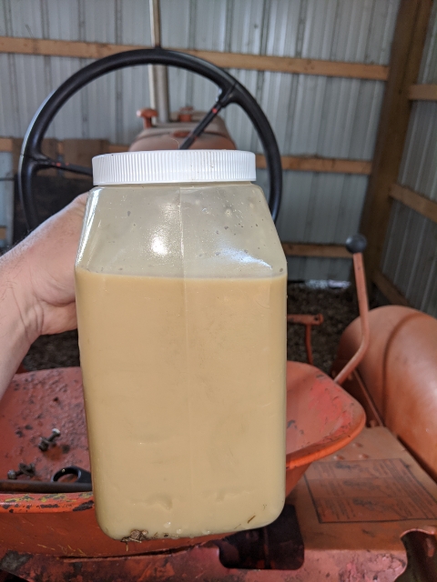

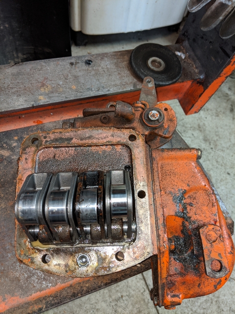

Here we are, 3 of hydraulic pump and 1 of the oil I drained out(303 super that was only used about 6 hours to brush hog the end a few hours with a post hole auger)
I'm not sure why but the one cam follower is a darker color then the other three and has some discoloration compared to the others?
Thanks Matt 👍

mmmmm...chocolate milk !!! Leave the jug sitting for a couple days, it'll separate into oil on water.....
be sure to disconnect cylinder hose and push ram to get rid of the oilywater in it as well.....

Great pictures! In your top left photo you can see the hydraulic pump drawbar control unit attached to the pump. I'm having fun tearing it down.
Nasty looking oil! I am working up the courage to drain the rear end and remove the pump so I can clean it. Helps to see someone else doing the same!
Please keep the pictures coming. And thanks.

I was shocked that there isn't a gasket on the mating face of tractor rear end to pump?!?
