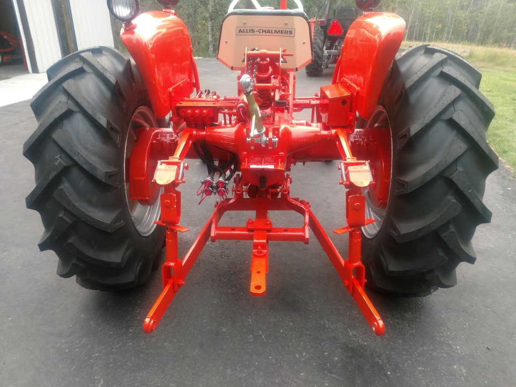

My D 15 top link was too long to hook up the harrow . About 22" at shortest adj. Short top link set about 20" works . Short top link body is 13" as said . Got mine at TSC .Thanks
Edited by ACinSC - 10 Feb 2020 at 12:14pm

I put a 3 of kit on my D15, and had the same problem. Found a shorter top link online, about 13" minimum length. That seems to have resolved the problem with my " selfunloading" 3pt carryall.

Rick, Tony, Ross,
Thanks for the comments! Yes we may have two issues the actual 3 point lower arms may not be out past the tractor far enough. And we may have the top link pivot too high. Well it was a farmer fix and not a lot of dimensions or specs were reviewed during the build. Thats' what happens!

Good morning.   Google has a lot of information on 3Pt. specifications. Note the position of this 3rd point.    Ross.

I think your 3point problem mite have something to do with how the top link is mounted. Looks like it's too high. Add some plates with holes drilled to the back so you can install the top link lower.
After looking at the pic with the saw rig on, I'm fairly certain it's the top link mount that's the problem. The top link should be pretty much at the same angle as the arms when hooked up. Otherwise as you found out, the implement will "tip" as you move the arms up or down.
Edited by tony - 02 Feb 2020 at 6:00am

Dave,
 Maybe that is the problem. I told him we should bolt the cross bar on the drawbar. Will have to look at a little more. We did not have any numbers on where the lower arms should have been. Matt said it worked fine for his back blade and brush hog.

Looks like the 3 point is a hangin pretty far back, there...Wink

Folks,
 Matt came over today with the D14 to borrow my buzz rig to cut slabs. Well it did not go as planned!
When we had the top link in place the buzz rig tipped way back.
We had to use a short chain to get the buzz rig high enough that he could load it.
Luckily he has another 20 tractors to choose from so he mounted it on a 9N and it worked fine. PTO was too short too?  Not sure what is going on with the geometry of the new 3 point we put on the D14??
Edited by Sugarmaker - 31 Jan 2020 at 5:19pm
