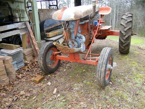

Finally a picture!!!!!!!!!!!!!

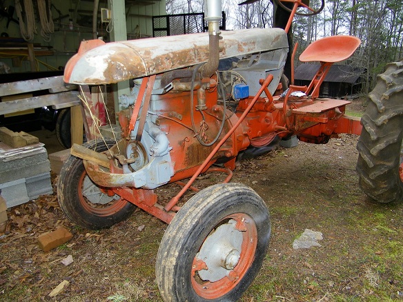

Post Options Post Options   Thanks (0) Thanks(0)   Quote TMiller/NC Quote  Post ReplyReply Direct Link To This Post Posted: 31 Dec 2019 at 6:52pm
Hood and fenders

Post Options Post Options   Thanks (0) Thanks(0)   Quote chaskaduo Quote  Post ReplyReply Direct Link To This Post Posted: 01 Jan 2020 at 11:23am
That's a Basket Case.  Wink

Post Options Post Options   Thanks (0) Thanks(0)   Quote ac fleet Quote  Post ReplyReply Direct Link To This Post Posted: 01 Jan 2020 at 4:29pm
Its a va!--I have 2 of them!

Tim,
 I like it! Do you have a picture of the front axle? That can be a clue too. Does it have a ID tag?
These are a nice little tractor.  Great for raking, pulling wagons, light tillage. 4 speed on the floor with gas pedal. I did some very stupid stuff on one of these when I was young and bullet proof!
Matching tires all around! sheet metal is there. Your on your way to a good project. And its orange!

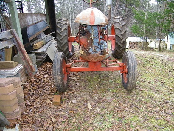

Post Options Post Options   Thanks (0) Thanks(0)   Quote TMiller/NC Quote  Post ReplyReply Direct Link To This Post Posted: 01 Jan 2020 at 8:01pm
Sugarmaker the front axle is straight made of maybe 1" X 3" flat steel, there is something funky with the steering as the arm from steering box to front doesn't look right to me.  Will try to get a picture tomorrow.  Thanks, Tim

Post Options Post Options   Thanks (0) Thanks(0)   Quote TMiller/NC Quote  Post ReplyReply Direct Link To This Post Posted: 02 Jan 2020 at 3:20pm
Couple more pics.........
The steering arm isn't right, was wondering if the front has been changed from a narrow front?

Points: 8542
Post Options Post Options   Thanks (0) Thanks(0)   Quote Sugarmaker Quote  Post ReplyReply Direct Link To This Post Posted: 02 Jan 2020 at 5:06pm
Tim,
 Its been a long time. My guess is that the long steering arm needs to come off at the top attachment point. Then maybe you can actually turn the wheel till the short arm is down. then attach the long arm? May need to go google some pictures of the VA series for steering details?
Tractor looks like its pretty complete too.
To me the VAI stuff on it looks correct.

Post Options Post Options   Thanks (0) Thanks(0)   Quote TMiller/NC Quote  Post ReplyReply Direct Link To This Post Posted: 02 Jan 2020 at 6:03pm
Thanks Sugarmaker, if the arm on steering gear is removed and re installed pointing downward will that not make the wheels turn opposite?
1 more pic of the boss,,,,,,,,,,
Alberta Phil View Drop Down
Location: Alberta, Canada
Points: 3933
Post Options Post Options   Thanks (0) Thanks(0)   Quote Alberta Phil Quote  Post ReplyReply Direct Link To This Post Posted: 02 Jan 2020 at 7:55pm
If it turns right, now, when you steer right, if you reverse the pitman arm 180 degrees, it will go left when you steer right.

Post Options Post Options   Thanks (0) Thanks(0)   Quote ac fleet Quote  Post ReplyReply Direct Link To This Post Posted: 03 Jan 2020 at 9:42am
I still think you have a VAC converted to VA. mine has the steering arm bent to make the connection to the gear. A factory VA dont have axle stubs sticking out.
Points: 8542
Post Options Post Options   Thanks (0) Thanks(0)   Quote Sugarmaker Quote  Post ReplyReply Direct Link To This Post Posted: 03 Jan 2020 at 12:00pm
The one in the video seems to be working OK with the sterring arm in the down position.
 I still go with VAI, final answer! Have fun with it Tim. Does it run? Assume it rolls over?  Will be a real nice addition to the family! If I remember the hydraulics left a LOT to be desired.

Post Options Post Options   Thanks (0) Thanks(0)   Quote DaveKamp Quote  Post ReplyReply Direct Link To This Post Posted: 03 Jan 2020 at 12:44pm
That's a VAI front end concept, but I don't THINK it's a factory VAI frontend....
but anyway, the VAI used a different steering box arrangement than a VA or VAC... and direction reversal MAY have been somehow involved.
The later VACs were available with the 'eagle hitch'... a hydraulic 2-point.  If this one has it, that's a good clue to the date.
