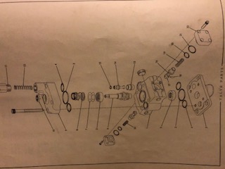

Post Options Post Options   Thanks (0) Thanks(0)   Quote rhead1 Quote  Post ReplyReply Direct Link To This Post Posted: 11 Dec 2019 at 8:24pm
The part number for the housing is 904224
It does have a 3/4" pipe plug on the side of the valve that is between the raise and lower hydraulic lines. Not sure if this is a pressure port that I could tap into or not. If this is a pressure port my intentions would be to run a line up to the cab to a single valve. I would then run a circuit to the tilt cylinders. Do you think that I would need to put a hydraulic cylinder on each side or just one side?
