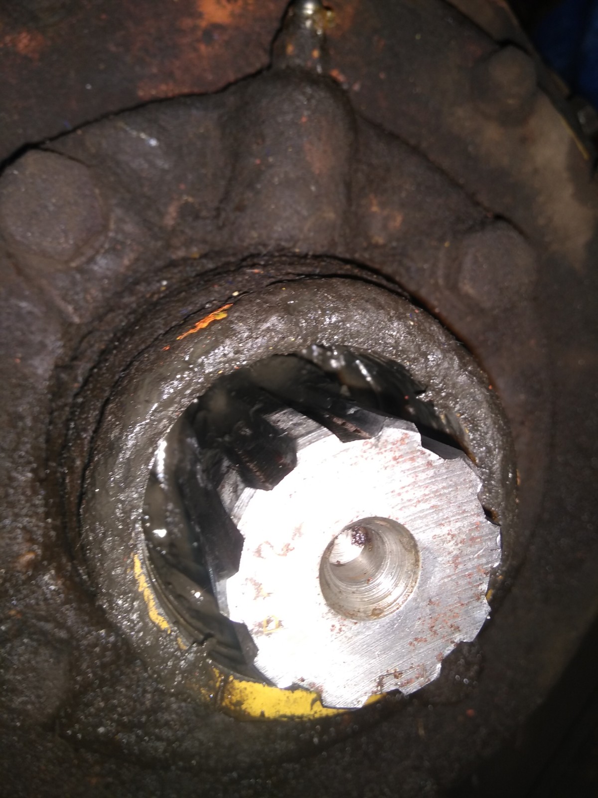

Haven't had the time to work on my grandfather's HD5 for too long but decided today to tackle the first of a few things needing to be done but of course it's more complicated than I first thought.
For too many years my dad thought the vibration was a Ujoint under the pedals. The vibration annoyed me to the point before givin her a run around today I figured I would get that UJ fixed. But, after pulling it apart it seems the wobble is either the yoke or clutch shaft...So, how does one figure this out and what kind of work would it be to change out the clutch shaft? The keys look perfect, no obvious "wallowing" out of the notches but when I inserted just the yoke back on the shaft it was way too loose. I thought at first maybe it was the bearing in there but the clutch shaft is tight and the Uj's on the driveshaft are all tight. How the wobble got there I haven't a clue. Maybe back in the 60's the machine was run too long with a bad Uj and that's what caused it. Over the last 50 years there probably hasn't been more than 100 hours total put on the dozer.  I think it must have been there but my dad never liked wrenching on machines much. I personally cannot stand for things not to be "right".
My first thought is to try to find a yoke and try that, if it doesn't tighten things up then I must go with the clutch shaft..maybe, if I can find one. Open to any and all suggestions. Once I get this done, I've got to get the shifting linkage tightened up, the blade valve gasket repaired and then she'll be good to go.
On another note if anyone is in the market for an HD5 I think I may have to let this sentimental piece go soon. I have no time to tinker and 3 kids to go to college so putting more money into something I don't even use is not going to go over with the boss. I hate the thought but I have to be practical.

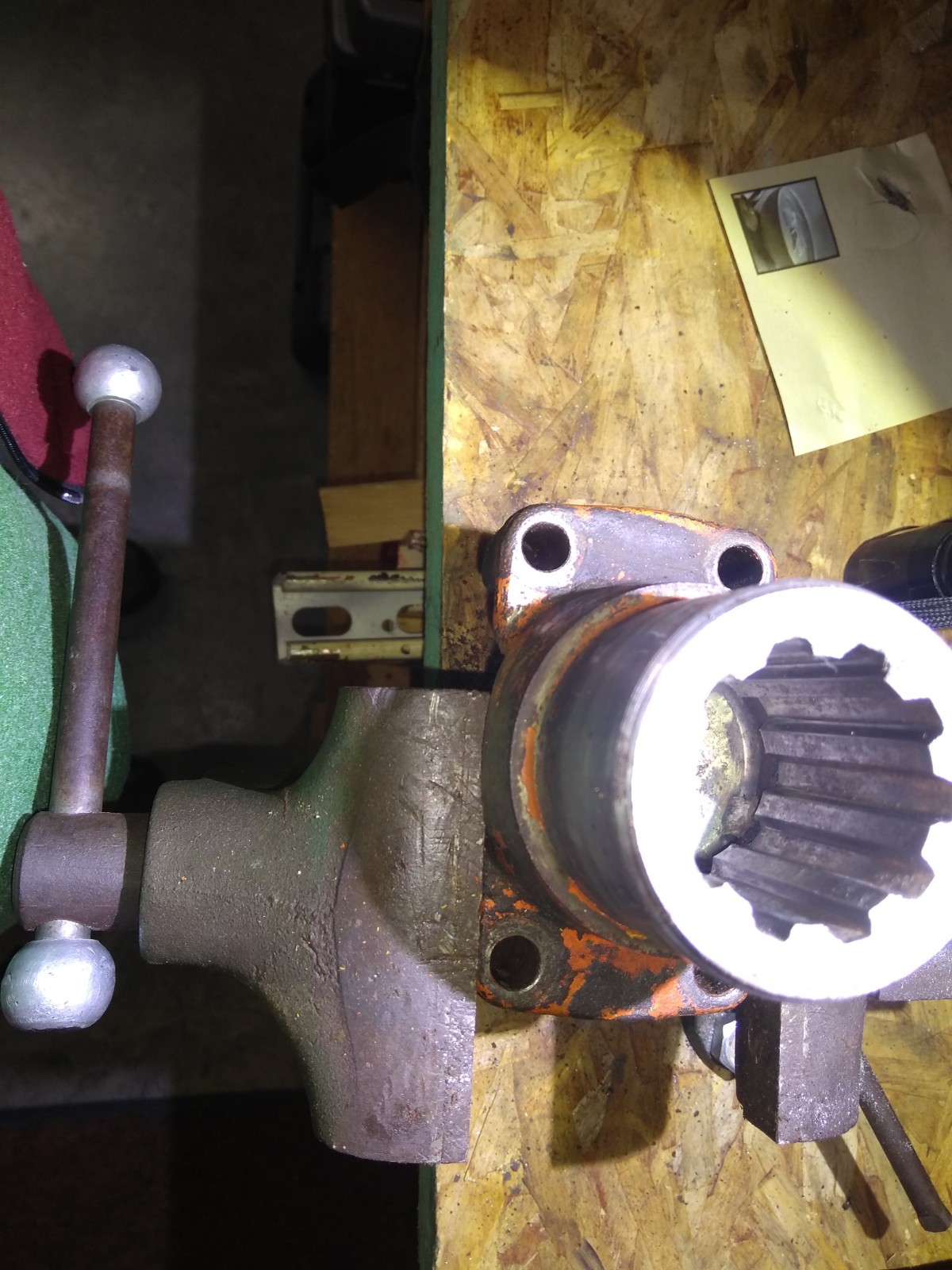

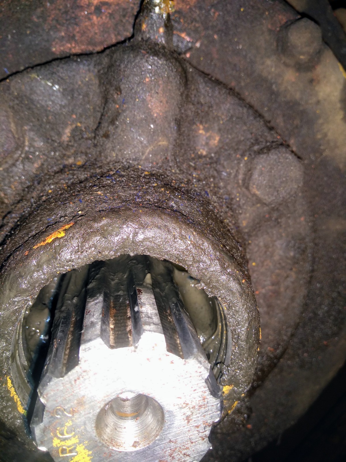

Does anyone have any yokes or clutch shafts they would sell? Also, I've attached pictures. I would call these tapered but I'm not certain as this machine should only have the straight splines...?uploads/835uploads/8354/clutch_shaft_3.jpguploads/8354/yoke_2.jpg4/clutch_shaft_1.jpg

Those are straight cut, there is bit of bevel at the ends to help them get started .
 All Cat parts that I have incounterd that are tapered,you need a puller or press to take them apart. Many of which don't have slines,just a woodruff key.

The angle starts at the top and slopes consistently down.. not tapered..weird. In the book it shows the earlier 5xxxx serial numbers had tapered and the later models had straight cut. The serial number on mine is 27528 so it should be straight but the sides of the splines definitely have an angle. But if that's considered straight then that's what I need. Poor machine has vibrated there since I can remember, my dad always said it was the Ujoints. Ujoints are perfect, can tell they are original and have been greased well.
Not sure what they did back then but is the shaft harder than the yoke? Not sure which to look for or do you just replace them both after adding a grease zirk to the yoke....? If there was a way to mic them out I would.... Thanks for the enlightenment!Smile

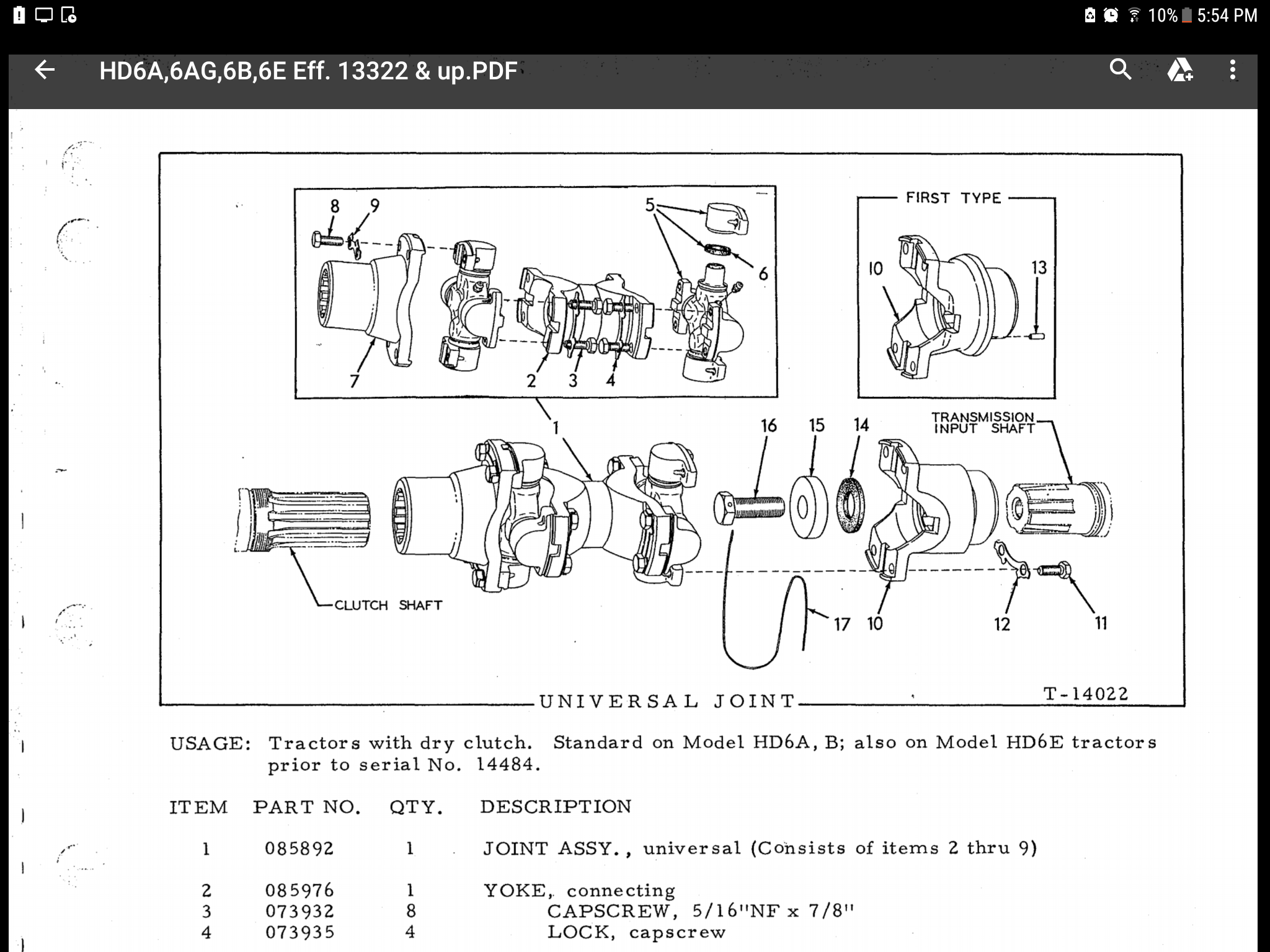

Hi Heron,
Please reffer to the attached parts diagram. Do I understand you correctly that the flange of the yoke labled #7 is not running true to the clutch shaft which is shown on the left side?
You also seam at some point to imply that the yoke has tapered splines, and that the clutch shaft splines are straight. Do I understand that correctly?
If assume that both my assumption as stated above are true then I might have an explanation for your troubles.
Note in the drawing that the transmission input shaft appears to be tapered. If that is the case then I would assume that the yoke labled #10 has a tapered & splined female hole to accept the shaft. Also note that a bolt through the center on yoke #10 holds the yoke onto the shaft, therefore not requiring a press fit as was mention was the case on CAT equipment.
Given all the above observations might I suggest that it could be possible that your dad got yokes #7 and #10 mixed up by accident? If he did then your observations would maybe make sense.
In the case of a mix up the #10 tapered yoke would not slide onto the clutch output shaft far enough to line up true with it's plane of rotation and that might be why you see the wobble you do. Also, the straight splined yoke #7 would be loose and sloppy on the transmission input shaft side and that could also be inducing a wobble.
I have some other ideas, and I might also have a yoke I can sell you if it turns out that you need one, but check out the above theory first and let me know what you find.
Sincerely,
Leo

That diagram isn't for a HD5 as the part with #1 is about 18" of tube - single joint on front and single joint at transmission . ==

Thats 100% true Coke, and I should have made that clear. That drawing is for an HD6.
I assumed that they were similar. I apologize for any confusion.
Does anyone have the proper diagram for the HD5. My brain has been turning over this question over and over and It would be great to examin the problem using the correct diagram.

As a previous poster said they are straight according to Allils. To me since the top is narrower than the bottom it should be called a tapered but it doesn't matter. I have other yokes where the straight splines are boxed completely but they also have grease fittings on them.
Also, when I removed the yoke from the Ujoint and slipped it on the shaft it definitely wobbles and has too much play and as I said in an earlier post I wrapped the end of the clutch shaft and put a large pair of channel locks on it and couldn't budge it.
When the machine is running at high idle you can see the wobble right there but as the rpms increase the vibration lessens.
Not sure if it's the yoke or the shaft that is worn. I'd hoped the yoke was softer than the shaft but I don't know so I'm assuming I need to get another yoke and put it on and see what happens. I'd like to find one that someone could place on a clutch shaft, see if it's tight, if it is on their's but not on mine I know its the shaft...No way to mic it out properly, at least with the tools I have.

 According to the diagram above 5 and 6 are completely different units. To fit the bigger engine up against the HD6 they moved everything back - the HD5 and HD6 share the same rear housing but being the Budda was longer than a 2-71 things were changed in the power train

The shaft picture I can see oil in cover and this cluch should be dry and you could have a broken block sliding shifting yoke

The oil is residual grease that's been pumped into that zirk for that bearing over the years. This machine has had the grease put to it. Probably too much. I'll know more once I open it up.

Leop, Great idea with the play doh. I'll look into the dial indicator but without baselines I'm not sure how it will work. I'll make a video of the play although I'm not sure I can upload it.
Also, the joints are in phase.

Heron you dont have a runout spec, but the 8ndicator will still tell you a lot. You can tell which part of the conection is the worse (more slop) and then you can focus your efforts there.
I also remember seeing runout speccs for the clutch output shaft and transmission input shaft somewhere in the service manual, so if you have one then you could check that out.
