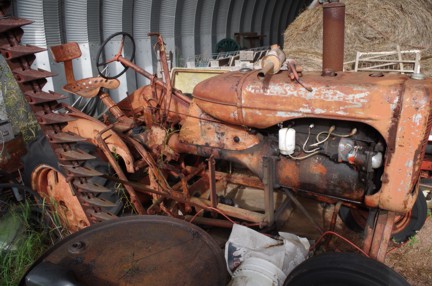

I have a couple  pictures if that helps. It originally had the in cowl type of muffler.

There's no kill switch wire to the mag.  It has the mag mounted metal tab to kill it.  I remember being terrified of shutting it down when I was a little kid!

Seat looks to be from a WC or WF.  Its bolted to a bracket that is installed on the axle casing.  Held on by 'U' bolts??  Looks to be a good project to restore.
Oh, and welcome to the forum!!  Lots of help and info available on here.

I will have to get out there and see how the seat is mounted.  I know its on a type of leaf spring that's held to the rear axle housing(?)  with a big old nut.

Hey welcome to a great forum. Go to tractordata.com and look up your serial number. I have a 39 B. Sure looks like a late 30's. A few things could have been added in it's 80 yr life. Fun little tractors. Oh where in WI are you?

Odd it would have generator! My guess would be it is not the original engine and the replacement engine had the generator already mounted when purchased. The early B's only had a Zenith carburetor also.

If there are no wires on the generator, then I would go with DICKS idea of a motor replacement, and the generator is just a belt tightener. ............. and all the Bs came with a bench seat, so that has been changed also.

I would say the generator is being used as a belt tensioner.  I guess I never thought about someone replacing the engine on a tractor that doesn't have a frame as opposed to just overhauling the engine.  I guess you could wear it out beyond limits or freeze it up and crack the block.  I live about midway between Wausau and Green Bay in Wisconsin.  My mailing address is Bowler but I'm nowhere near Bowler.  I'm in the actual middle of nowhere.

Could the seat on my B be off of an IB? I have seen some of these at shows that have a set up similar to mine. Going to the gathering of orange exent in Union Grove WI in a couple weeks. I will try to figure out more while I'm there.

I suppose it could be but Monroe made an after market pan seat. I have bought some that have other makes of pan sears that were cobbled up that looked like something that could have been bought.

The seat could be from and IB, but the base bracket it's mounted on is a little different than the ones on an IB.  Same mounting, but different shape.

The tractor was originally owned by some county government entity so it may have been ordered like that? Just an idea. I know my grandpa didnt change it or the seat would have been held on with a piece of fence post and a bunch of wire!

The tractor came from the FACTORY with a bench seat......... but the DEALER could have installed a Monroe or something they had off a WD tractor, etc.
