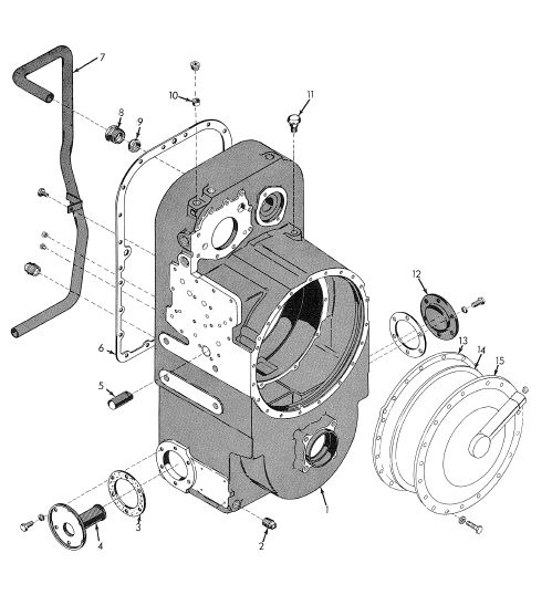

Up-date: I have not found a housing vent on the transmission, which concerns me a little. Most likely just haven't been able to see it. Did get a seal that is about twice as heavy or more than the first one we took out, and the one we replaced it with that went out again. I am pretty confident that this new one will hold back a good deal more than the precious ones, but for peace of mind, I'd sure like to get my hands on the vent. Is there any where that a person could get an online parts diagram of the transmission, so I could see just exactly where this elusive case vent is at. Thanks, Darrel

I found the parts books on Minnpar's website. There are a couple different ones but the seals for the drive shaft were the same in the books (I think I checked all of them at the time). I'll see if I can spot the vent again and try to post a link.

Here is a link to the Fiat Allis loader parts manual index at Minnpar. 4 choices on the 645s. HTH

645 prior to serial 2032.  vent is shown of pg. 81 of pdf
645-b  vent in same place.  guessing they all are  #11

Wow! Talk about fast service. Thanks guys. I see in the last picture there that I was looking in all the wrong places. Going to head out here shortly and see what I can find. darrel

The steering pump is on that (left) side and may kinda hide that breather
