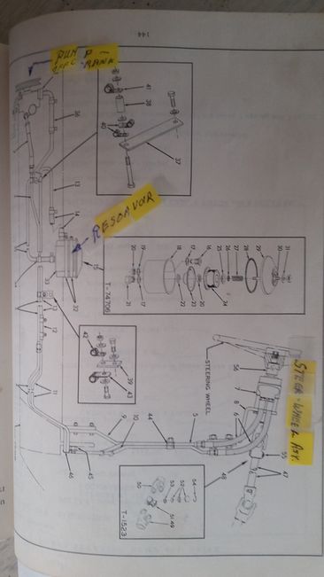

Good morning.   I could never understand why A C did not automatically put power steering on their 'D Special' graders. I have a 'D Special' and it was shipped with every option as standard equipment; except, power steering. We are currently trying to install this option.
It appears that a lot of option are available if you decide to put P S on. My parts book shows:
   There are, of course, so many options for appropriate equipment to adapt to the grader for P S. Automotive pumps with reservoirs , pumps driven from other sources like the distributor, most seem to have added a priority valve to the existing hydraulic system in order to rob enough oil to power steer.

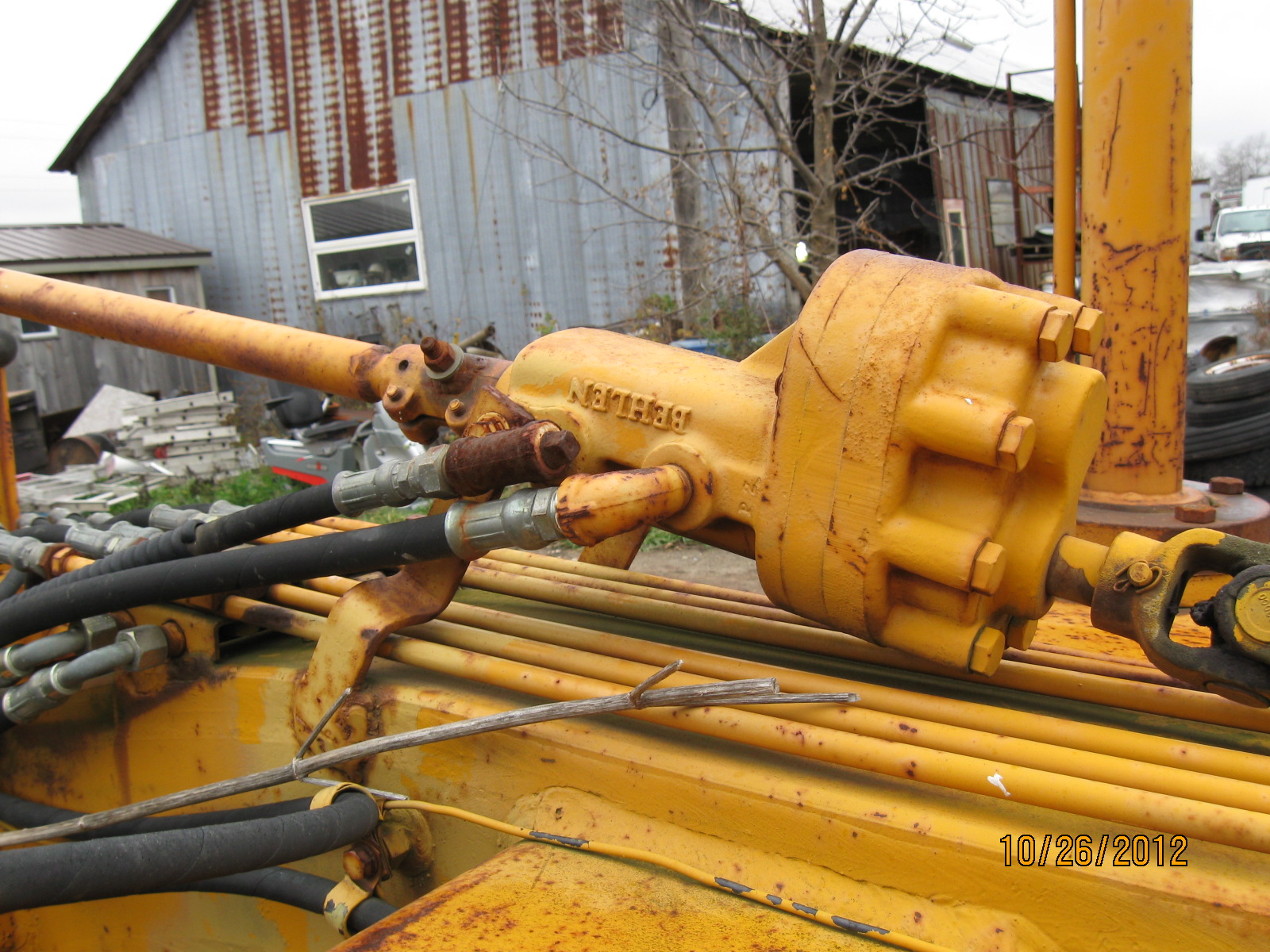

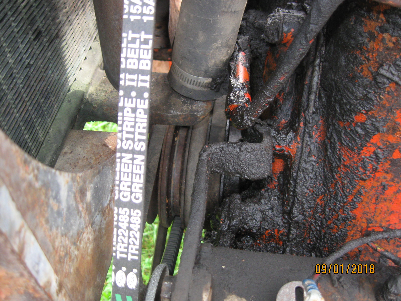

   Here are some miscellaneous pictures.
   How do you intend to install the system?

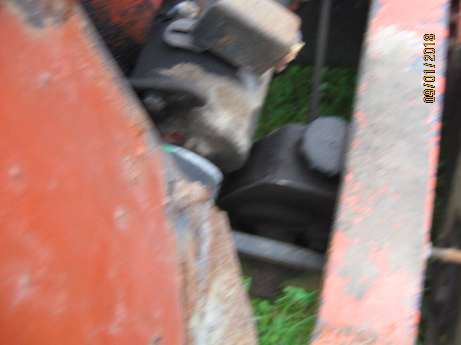

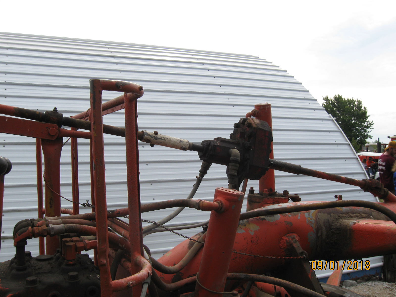

   Hi David.
   Here is pictures from an old grader that was at the Pontiac, Il. G.O.T.O. show this year. The pictures show an automotive style pump mounted on the R H side, driven off the crankshaft pulley, and located below the alternator. Sorry that the pictures are not very good and the sizing of the pictures.

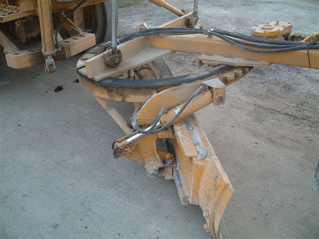

   Here may be an idea that you might want to consider sometime. This man says that this addition to the blade angle really works well for fine grading applications.
   Ross.

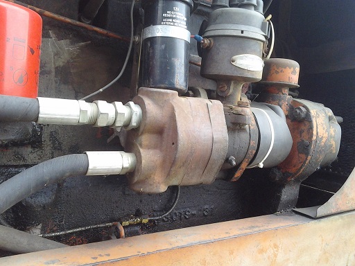

Looks like putting  pump on dist would be putting to much  on  gov gear  and dis gear train. I know it was used as an add on on small tractors. I would go for the belt.

Post Options Post Options   Thanks (0) Thanks(0)   Quote Ross D. Quote  Post ReplyReply Direct Link To This Post Posted: 09 Feb 2019 at 10:22pm

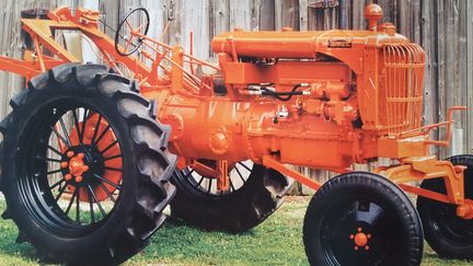

   Probably was a common usage:
   Ross.
