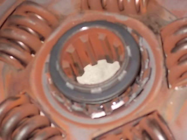

I also have had a bad experience with South Bend: I have 2 different first Generation diesels and installed their recommended clutches in both of them,  One day my wife call and the 89 just quit moving. The pressed together center had just stripped out. The disc was made in China. When I called South Bend, their answer was " We don't sell Chinese parts and anyway it's out of warrenty". when I sent them pictures of the disc clearly marked "Made in China" I never got a reply. Nothing was worn , Flywheel still looked as it was just re-surfaced and pressure plate looked like new, even the disc lining itself measured about what it did before it was installed. I got a HD  FORD disc from Rick Corder and it has been fine.
