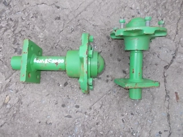

Post Options Post Options   Thanks (0) Thanks(0)   Quote PaulB Quote  Post ReplyReply Direct Link To This Post Posted: 29 Nov 2018 at 4:55pm
Here is the pair of stub axles that I have available. They accept the standard AG 6 bolt rim. The round part of the axle is 1-3/4". The hubs have a grease fitting and roller bearings.
