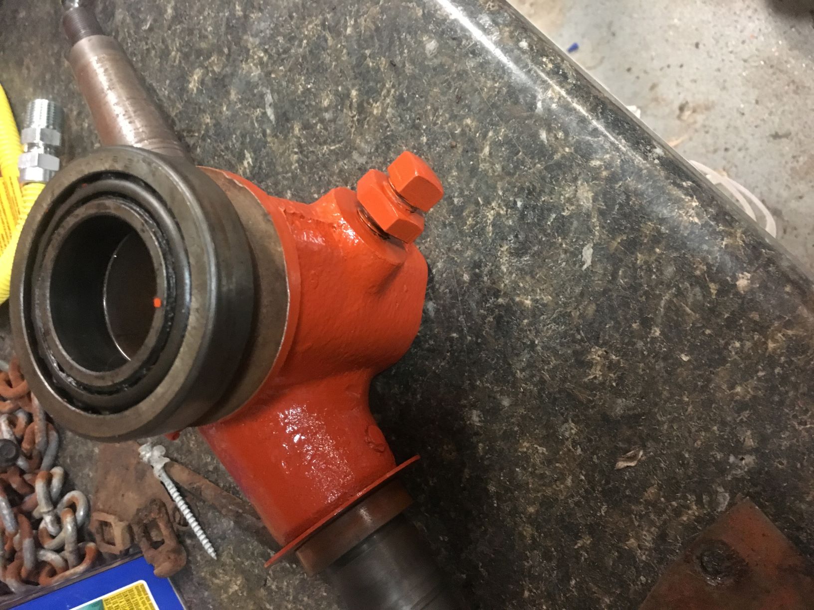

I think theses may be the bearings I used. Not sure I have so many pictures of bearings? Top seal doesnt look right? Looks too small?

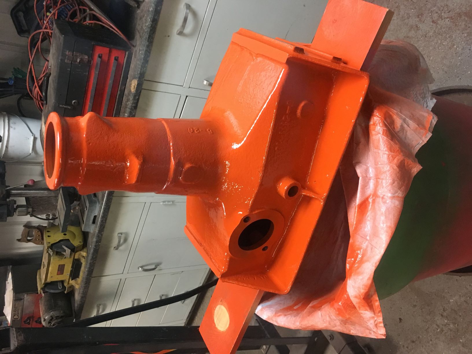

Here is the gasket I need. Sorry about the rotation-haven't figured that out yet.

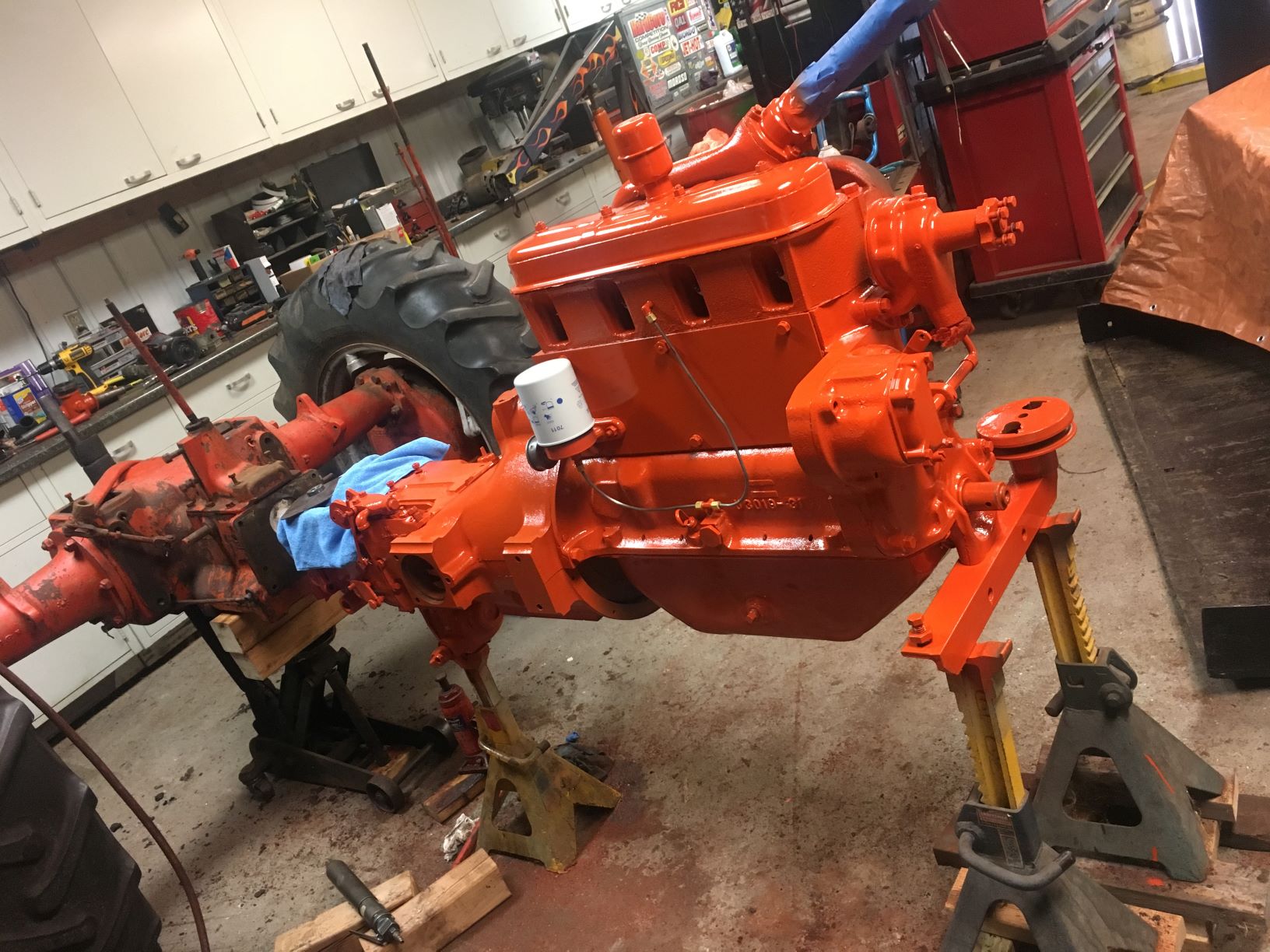

Current status

Great shop and the WD is coming right along! Thanks for posting these. You should be able to post more than one one picture at a time too, so not sure why you cant?
Sandy Lake and or other AC parts folks on here should be able to provide that gasket. BTW I am going to need one sometime soon also. I am going to try to get mine split in the next few weeks.
What are you using for primer and paint? It looks good!

Yes thanks just to clarify I am talking about bearings for the lower vertical shaft. and a gasket where its split at the trans.

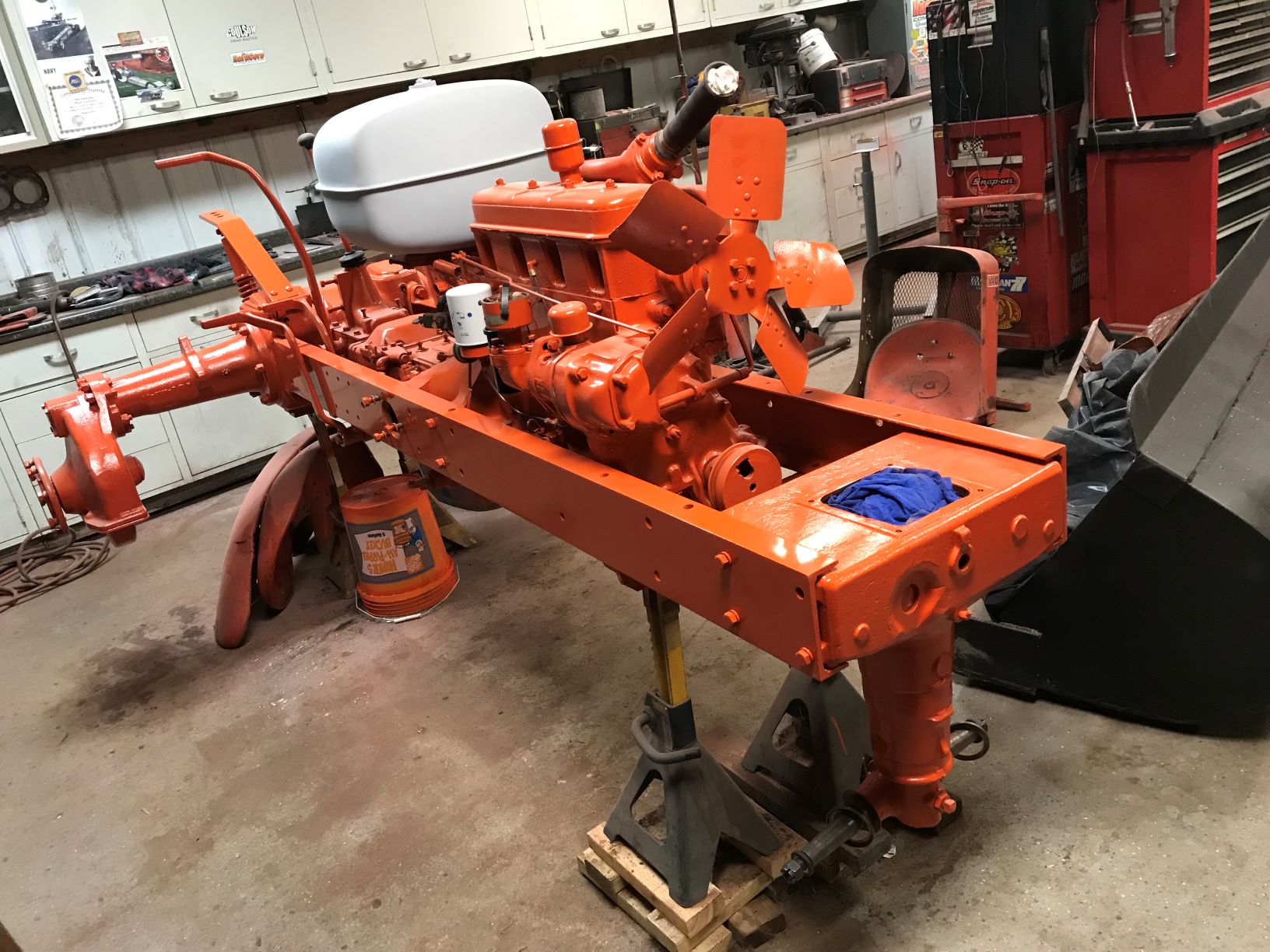

Here is an update fro you guys! working on the sheet metal now.

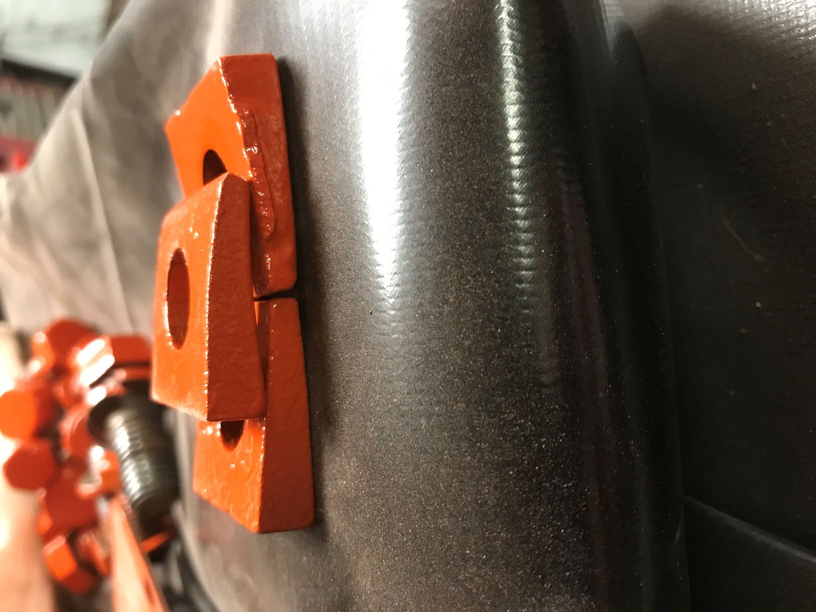

Anyone know where I can find a few of these?

Fastenal
Points: 9002
Post Options Post Options   Thanks (0) Thanks(0)   Quote SteveM C/IL Quote  Post ReplyReply Direct Link To This Post Posted: 17 Jan 2019 at 8:54pm
...or get a chunk of angle iron from the welding shop and cut some out.
JoeM(GA) View Drop Down
Location: Cumming,GA
Points: 4945
Post Options Post Options   Thanks (0) Thanks(0)   Quote JoeM(GA) Quote  Post ReplyReply Direct Link To This Post Posted: 17 Jan 2019 at 10:03pm
mcmaster carr has them
use "leveling washers for I-beams" in the search

Looks like it will be really nice when done.
What the funny looking thing of front of the crank pulley?
Points: 8662
Post Options Post Options   Thanks (0) Thanks(0)   Quote Sugarmaker Quote  Post ReplyReply Direct Link To This Post Posted: 18 Jan 2019 at 10:44am
Coultrain,
Looks great! More pictures! Please.
I was wondering the same thing on that pulley? Haven't seen that version? What does the shaft look like?
Just noticed the different fan too.
Also what did you find for vertical spindle bearing?
Wish mine was that far along! its a lot of moves to get them old WD's to look that good!

The pulley was repaired at some point. looks like it may have been being used for something-not sure what. I got the spindle bearings from the central Iowa farm store. Great guys there.  Ill try and post more pics later.
