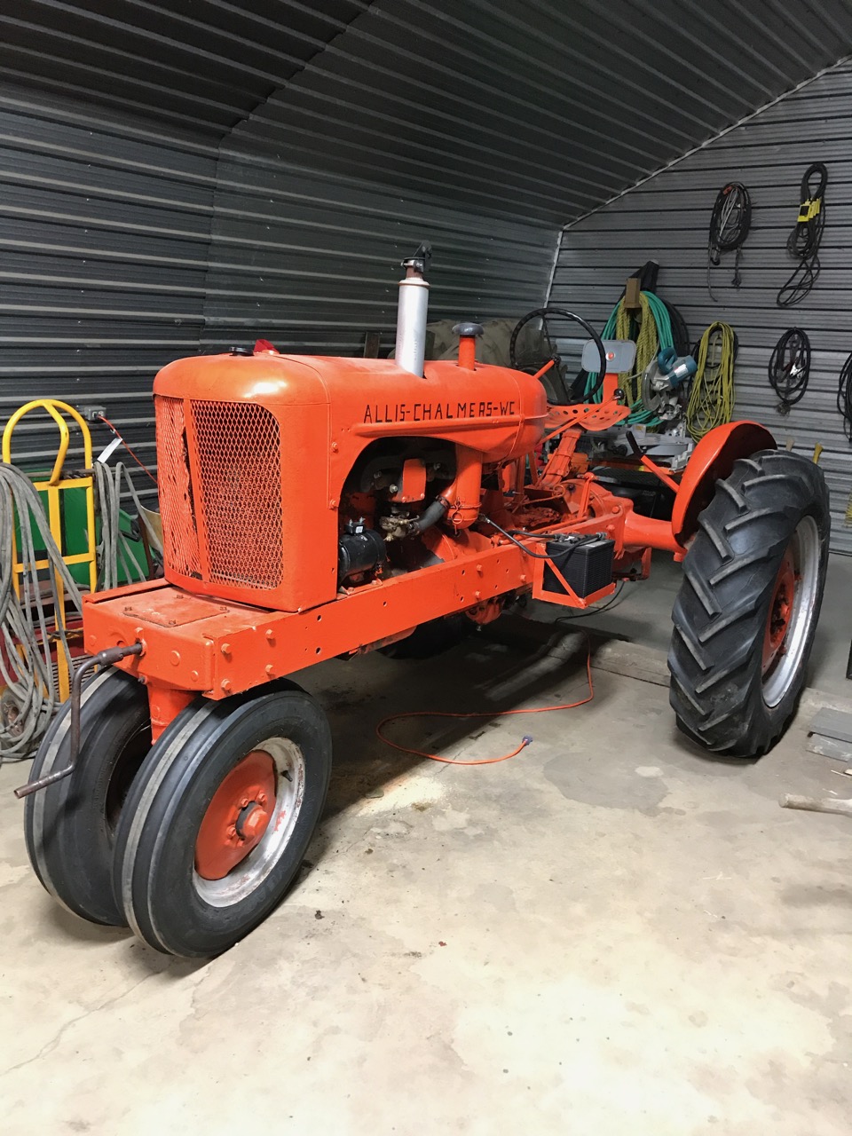

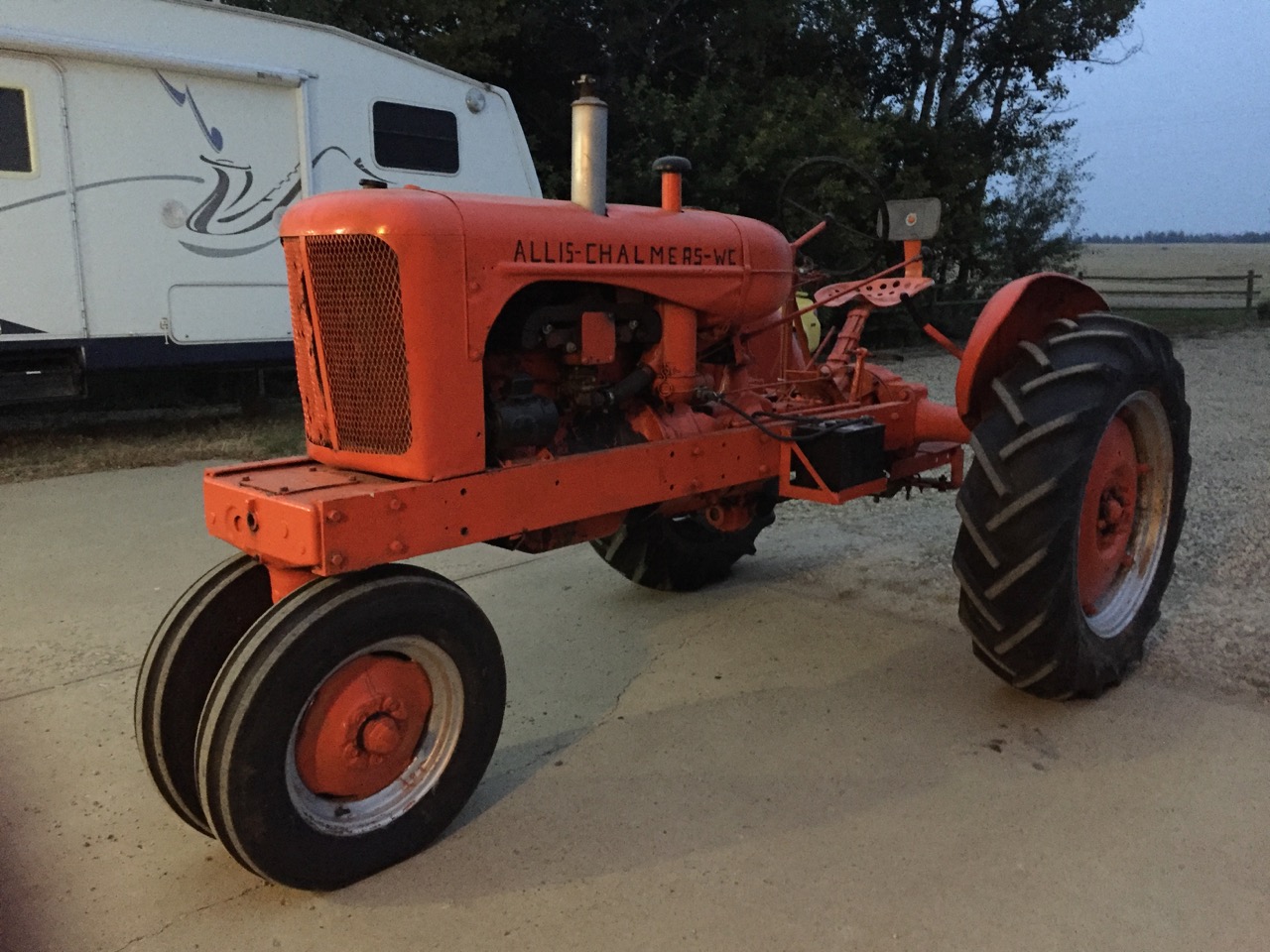

Yes, as Phil said it wasn't too bad, but since I need to replace the front crankshaft seal and a few gaskets that are leaking, I thought I might as well check the head and block. The block doesn't look too bad, but I'm not totally sure what I'm looking for. I can't feel a ridge or anything on the sleeves. I might post a picture later and we can see what we can come up with.
My plan with it is to try and fix the oil burning, fix a few oil leaks, get a new drawbar, and give it a new paint job. It won't be put to work much, but may go in the odd parade. See pics below.
