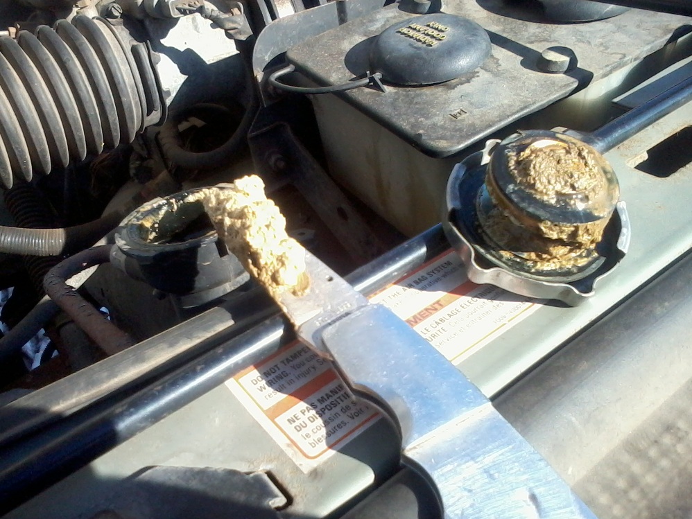

Or it will look like this if mixing...

YIKES !!

I seen one like that but the gunk was pink and it had the consistence of wax.
