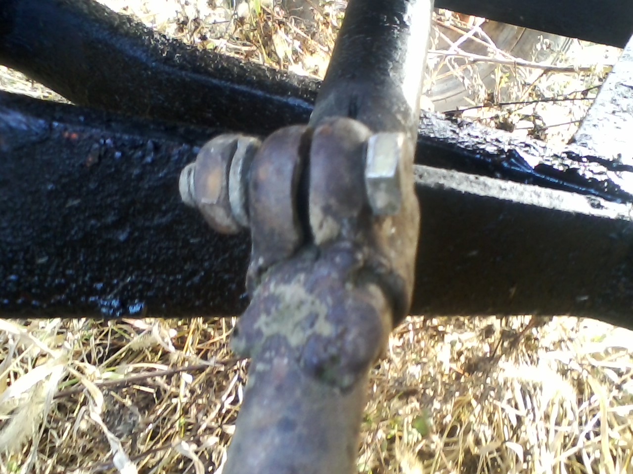

So today this happened.
I can't even pull the steering arm off at the adjustment point as someone has booger welded it to the shaft!

So how do I get the arm of the steering spindle? I got the snap ring off, but do I need to get the key out? Been pounding on it with a sledge as I don't have a torch.
And do you think our local blacksmith can weld this back up, or should I be looking for a new arm?

man I do feel for you though ... It looks like you'll need a spindle and the arm piece....oh yeah, tie rod end with zerk too....
hmm maybe, just maybe you can use a thin cutoff wheel and remove a piece of the busted casting (2 cuts, 1 whack with cold chisel)? if it's like the D-14, they are 'keyed' so, cut there first as  keystock is cheap and you may not damage the spindle.
slow and steady, patience and you may win.....

Dang. Why do I need the spindle piece too?
I can't get the thing to separate what you see on it is a bunch of WD40. I been using my little Thor hammer to try and get it off, no luck.

Can you get the nut off the tie rod end?  Pickle for would have that piece off quick and save you some money.

It's spinning in place, I'll probably get it off, but I think tomorrow I need to get a fine torch, for the arm, the one I have just now would take out the tyre too

OK, as long as the arm wasn't welded to the spindle(which is what I thought) I'd cut/grind off the busted arm. I doubt a welder can fix it 'like new'. 2 cuts will get rid of a piece of the spindle, so the rest will come off.

WD40 is not a penetrating oil.  mix up some atf and acetone, 50/50, and drip a little of that, then try again.  Rome wasn't built in a day, and some of these mechanical things take time, specially if you don't have the red wrench...Wink
Oh, and if yer hammer is a little thor, get a bigger hammer, and it won't get tho thor...WinkWink

Ga, didn't proof read.  Pickle fork.  Tie rod fork.  I wonder if you hammer it in there a bit if that wouldn't keep the thing from spinning.

I got to go up to town tomorrow anyways, right by Harbor Freight, so going to pick up a torch, already have the propane bottles. That'll cover the big part of the arm, on the spindle, not sure about the little part, it is spinning with the nut, on the tie rod end (not sure of name), along with the threads. Don't want to mung up anything else, hoping I can regrease and reuse that end, get it going. I doubt the arm can be fixed, but I'll try the local blacksmith, but the small end looks pretty frail and brittle anyway.
Seems like a lot of places sell that arm, fits a bunch of models. So that's a bright spot.
The welded adjustment point (tie rod?) I'm hoping to leave as is.

Try using a pipe wrench or channel lock pliers to hold the broken piece from spinning.  The tapered part of the tie rod is wedged in there anyway.  If you can get a good grip on it, that will let you get the nut off, then use the tie rod fork to pop it off the end of the tire rod.

Put a 1/8" cutting disk in your 4 1/2" angle grinder and cut the arm on two sides. You don't even cut all the way down to the spindle. Cut deep as you dare and wack it hard it'll break at the score and not damage the spindle. I personally would not even bother with the tierod end just replace it. When I did mine a complete tierod assembly was Cheeper than buying both ends and I didn't have to fight a rusty stuck one apart.

I would (as mentioned ) cut the broken arm off carefully with a 1/16 inch thick cut off wheel. one slice might be enough. Get a good used arm and then replace the adjustment rod with a new piece. I fought one of those half a day to get it apart and it wasn't welded! They get rusted together pretty bad.
You might want to check those bearings for the vertical steering shaft. It looks like there may be some slop in those. Now would be the time while you can drop the spindle out the bottom. It was well worth the effort on the WD I repaired.

Dakota Dave is correct, carefully cut both sides. You may try a chisel in the cut and wack it with a hammer. Or try a two point puller, after all that’s what the hole in the top is for. Replace the whole tie rod assembly, as said before it’s cheaper to replace it all than each piece separately. Found that out when I called Brenda at Sandy Lake about my XT.

Looks like the cast arm was welded on before ??
What would the puller push against? I like the idea of a puller more than using fire BUT don't see where it would seat? Or is it clawing up on the two edges of the arm, and down the middle of the spindle, maybe I'm being obtuse.

[/QUOTE] What would the puller push against? I like the idea of a puller more than using fire BUT don't see where it would seat? Or is it clawing up on the two edges of the arm, and down the middle of the spindle, maybe I'm being obtuse.[/QUOTE]

I did not read anywhere if you are aware that you cannot drive the spindle out of steering arm. The steering arm has to come off and remove key before the shaft can move out of the knee. The broken steering arm eye that is on the tie rod can be removed by laying it on an anvil and striking the other side with a heavy hammer, you may rotate it to help get it to release. The reason the tie rod was welded on is because someone replaced the tie rod with an import part and did not change the factory clamp. The import clamps are very prone to slipping. If you decide you want to salvage the tie rod, you will need to grind away the weld. Then you can lay this on the anvil and peen it to loosen it. You can than try various methods to pull it out. Many times I weld a slap hammer puller to it, use some heat and bring it out. Laugh at my methods if you wish but I get them apart without destroying them.

Well bit of a fiasco today. Got a set of 3 pullers from Harbor Freight, they had a nice heavy looking Pittman puller but the opening was too small, so I had to go with a two jaw puller set.
Started with the biggest puller, it bent to a 45degree angle and stayed there Confused
So went to the medium size puller, it snapped a bolt Confused
So I figured I had to use the torch (new from Menards for the purpose), had a bugger of a time getting it lit, got it lit, it burned for a second and a half and went out. Refused to light, no hiss of gas, even another tank didn't help Dead
So at that point I stopped, rather than pound on it in frustration.

I've found the only good torches are sold at the gas supplier's. Throw the pullers away. Get a good torch with a rosebud tip. Remove tire and rim. Heat until arm is red hot and douse with cold water. Tap arm off with a hammer. To reinstall heat the new arm red hot again, making sure to line up key in spindle with slot in arm, drop the red hot arm onto the spindle with a couple pair of pliers or visegrips. Tap down into place. Let cool to shrink fit onto arm again. Install snap ring.

You heat it, then cool it, before trying to remove? Not remove it hot?
Wonder why they didn't just make a custom puller like this?

You can try the wax trick, heat to 500ºF, or so, let it start to cool, and as it cools, stick a beeswax candle, on the joint, in question, let the wax wick into the joint, as it cools.  Wink

You can use a puller if you want and then hammer it back on. I don't like to because it's my belief the arm will not be as tight as needed to ensure it won't come loose and ruin the spindle and arm. Several here will argue against that. But my way is the way I learned at the Allis dealership when I worked there years ago. If you have a torch I find it to be the fastest way with the least amount of effort and since it shrinks to the spindle I am sure it will never come loose. BTW the reason you douse it with cold water is to freeze the metal in it's expanded state so you can just tap it off with a hammer. You do what is comfortable for you.
But that's not how metal works, I mean I'm not a metallurgist or anything but I'm fairly sure it just contracts again when cooled. I do believe that the rapid cooling can change the metals structure tho' I beleve rapid cooling can change the hardness, maybe making it more brittle. These parts are cast iron, yes?
