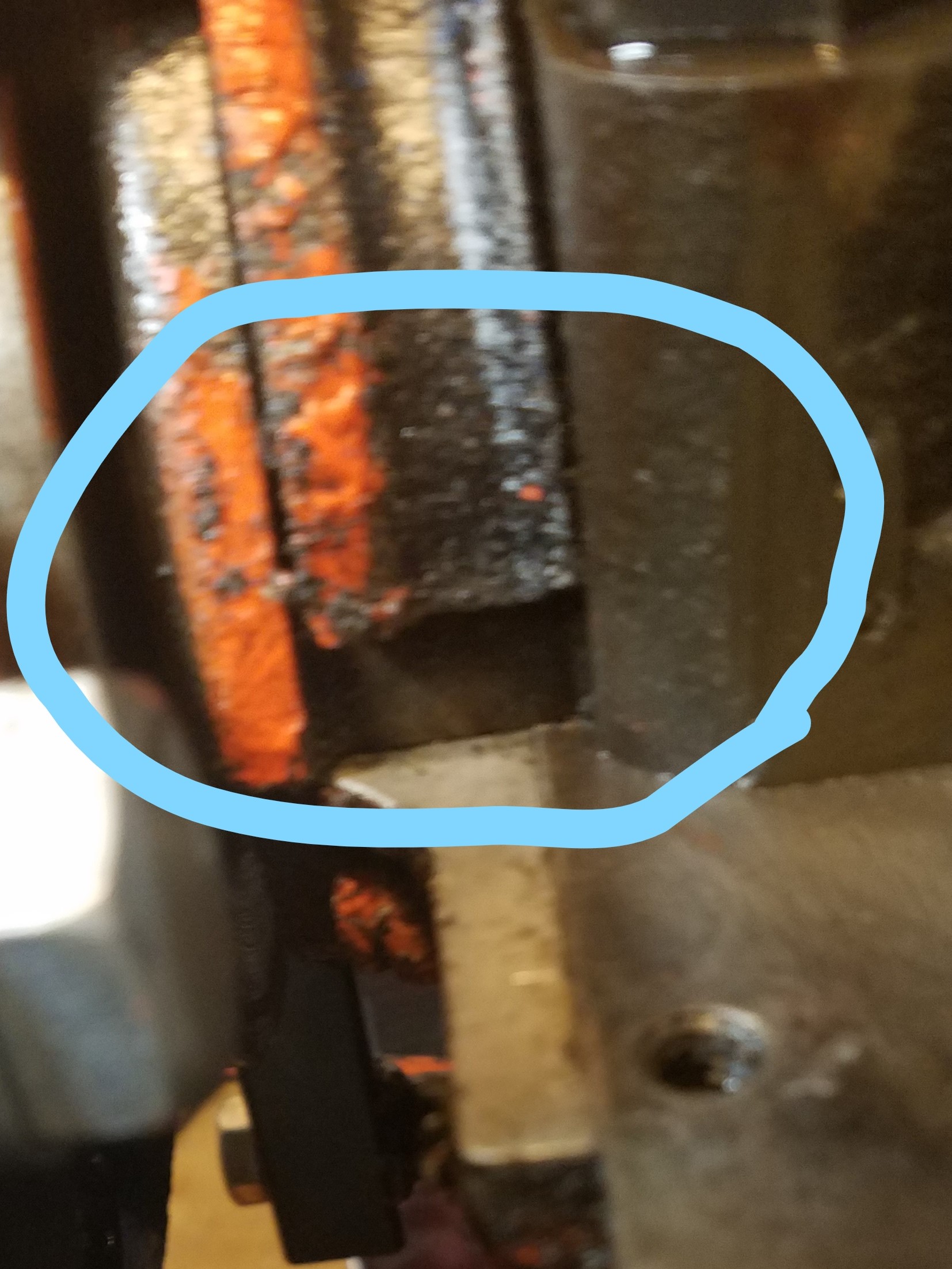

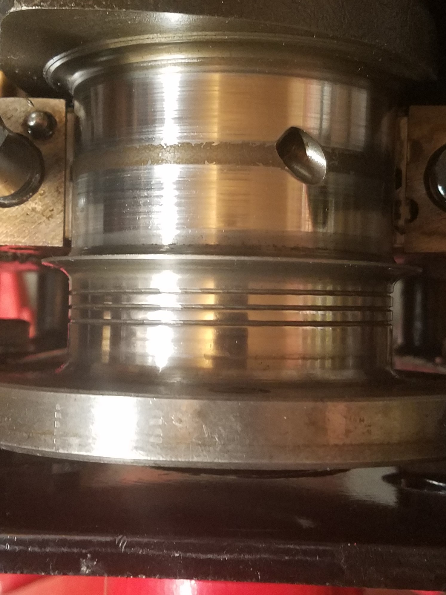

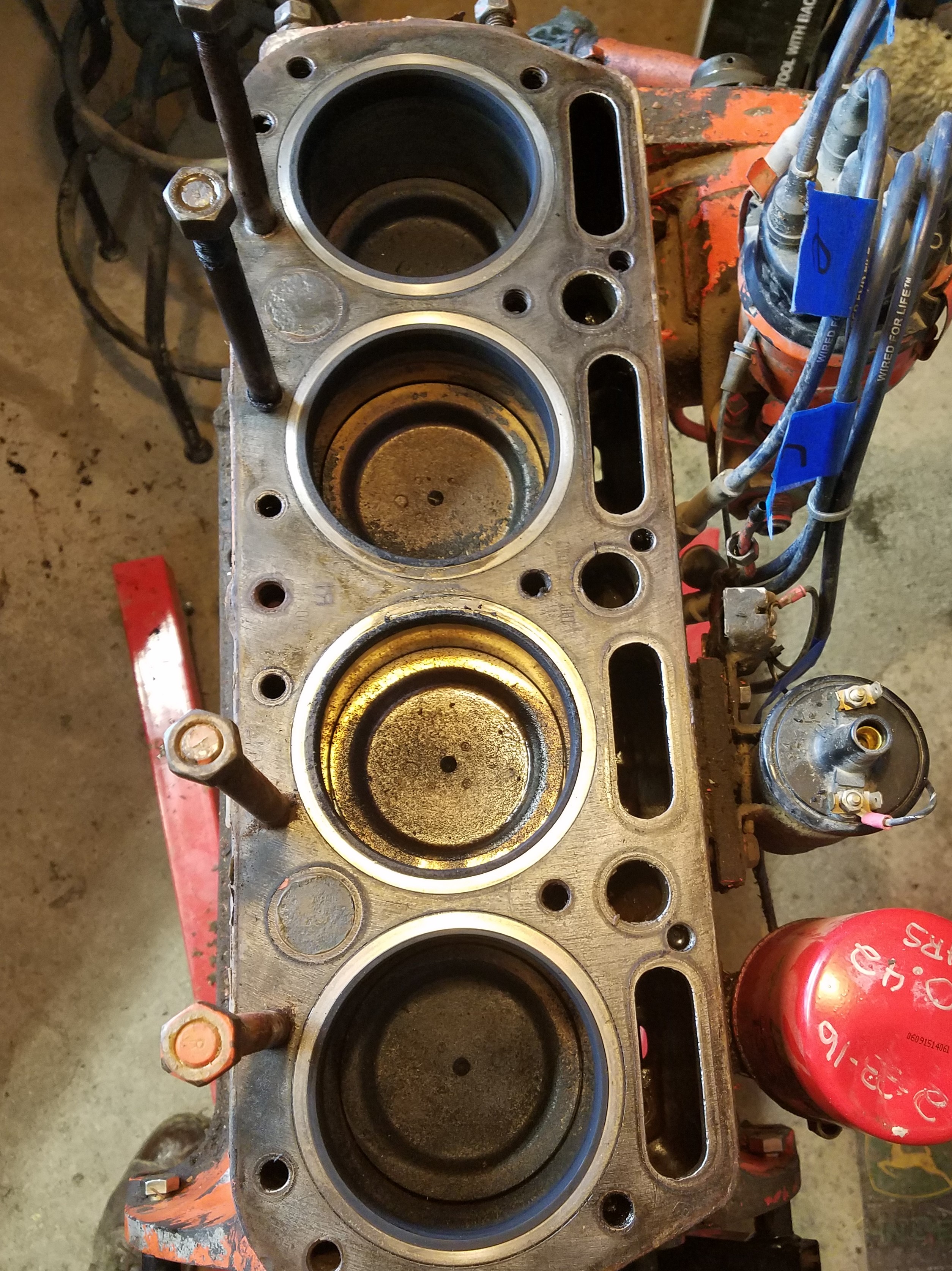

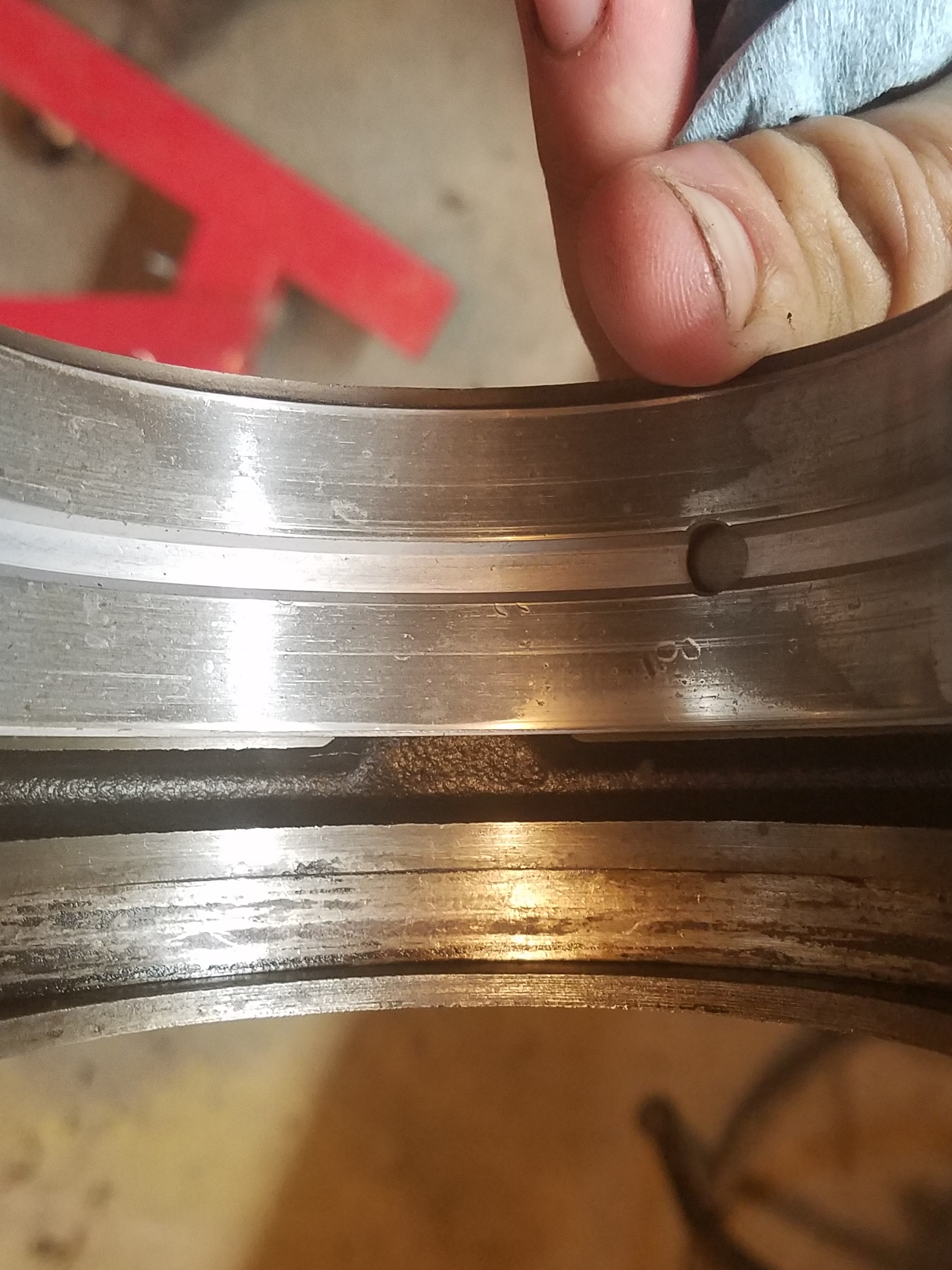

So I split my early D17 because of an oil leak at the rear of the motor, also thinking it needed a clutch. (Witch it does) Now that I've got the pan off and watched Don's very informative video on how to do the rear main I have just a couple questions. 1) ?Is the crank supposed to have grooves in it where the rear main seal sits??? ?I really hope I don't need to track down a newer one. I've also got some pictures of the cylinders, that I think look pretty good, and a picture of the main bearing on the rear cap that I removed. And 2) Should I just do an overhaul? (Rod's, main's, rings?) I'm going to get some PlastiGauge and see what what the main bearing checks out at.
I think this was the main source of my oil leak. Look at the gap between the gasket and the block.
Grooves where the rear main seal rides
Rear main cap bearing
Looking inside the cylinder.

the grooves keep the oil in the engine.

Cross hatching looks good to me (but what do I know). I'd say if it ran good before (good compression, no blow by, etc.) let it be. No sense spending money if it runs good.

Im with Creston.......... liners and piston look great... Bearings look like dirty oil has gone thru them , but I don't see babbit gone.  Clearance check on  1-2 might be a good idea.  What was oil pressure when running ?

It looks good to me too. plastigauge the mains and a couple rods and see how they look. Should be .002-.004. Might be a good time to do a coolant flush on the block. They can get a lot of junk in them over the years.

The bottom of the bore where the rings never touch will almost always look good.  As mentioned  above if it had good power and did not use oil,  probably OK.

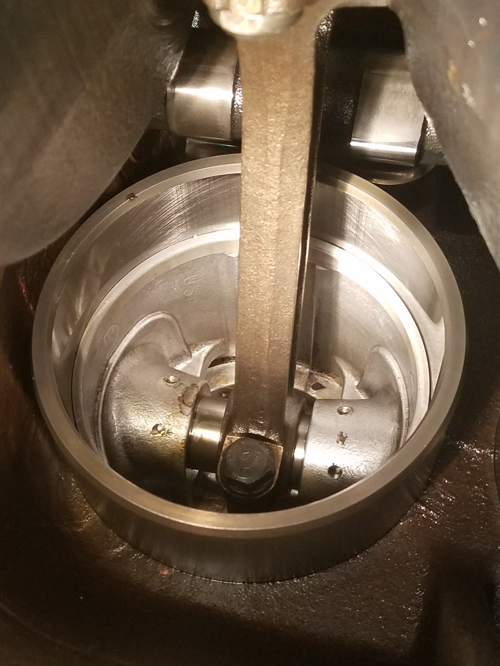

My guess is that engine had an "in frame" repair done to it, meaning new pistons, sleeves, probably rod bearings too. I say that because I see no varnish buildup on the under side of that piston or on the edges of that sleeve where nothing ever touches.
It could also have been an overhaul that set without running for quite a few years and there was enough moisture present to discolor that crank journal. Either way I'd be having that crank reground with all new bearings if it were me.

Well I spent most of the day out in the shop, Plastigage shows .006 on the front and rear main bearing, and .005 on the center bearing. Needless to say I tore the whole motor apart. It's already got .010 over bearings in it, so my guess is it had to be an out of frame, and the crank was already ground. How much of a bugger is it to put a new cam bearing in it? I haven't pulled the pistons yet, but if I've gone this far I might as well put new in. So who sells a good overhaul kit??
