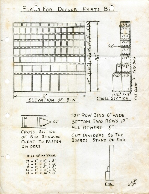

Here you go, the official blueprints for an Allis Chalmers Parts Shelf from 1936:

The board dimensions listed are actual size if from 1936.  A 1" board was 1" thick then not the 3/4" they are now

Drawn 81 years ago Yesterday!

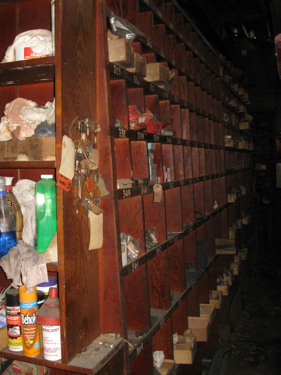

Here is a pic of the parts shelf's I have. They came out of a old Allis dealer. I could take some measurements of them for you if you want.

  Yeah,,Ted  I was just "pokin" ole Shameless,,,. After readin ole John's post I went back to thet page and,,,and,,,there is the date on btm right where the draftsman signed his dwg,,,what a coincedence of the same date,,huh,,,,ole John gots some super sharp eyes,,he does,,,!!!ClapClap

Looks like you need to find someone that can rough cut the wood and then run it thru a planer.  I don't think you can find ttrue size dimensional lumber, but I could be wrong  .  .  .  happened once before!! Big smile

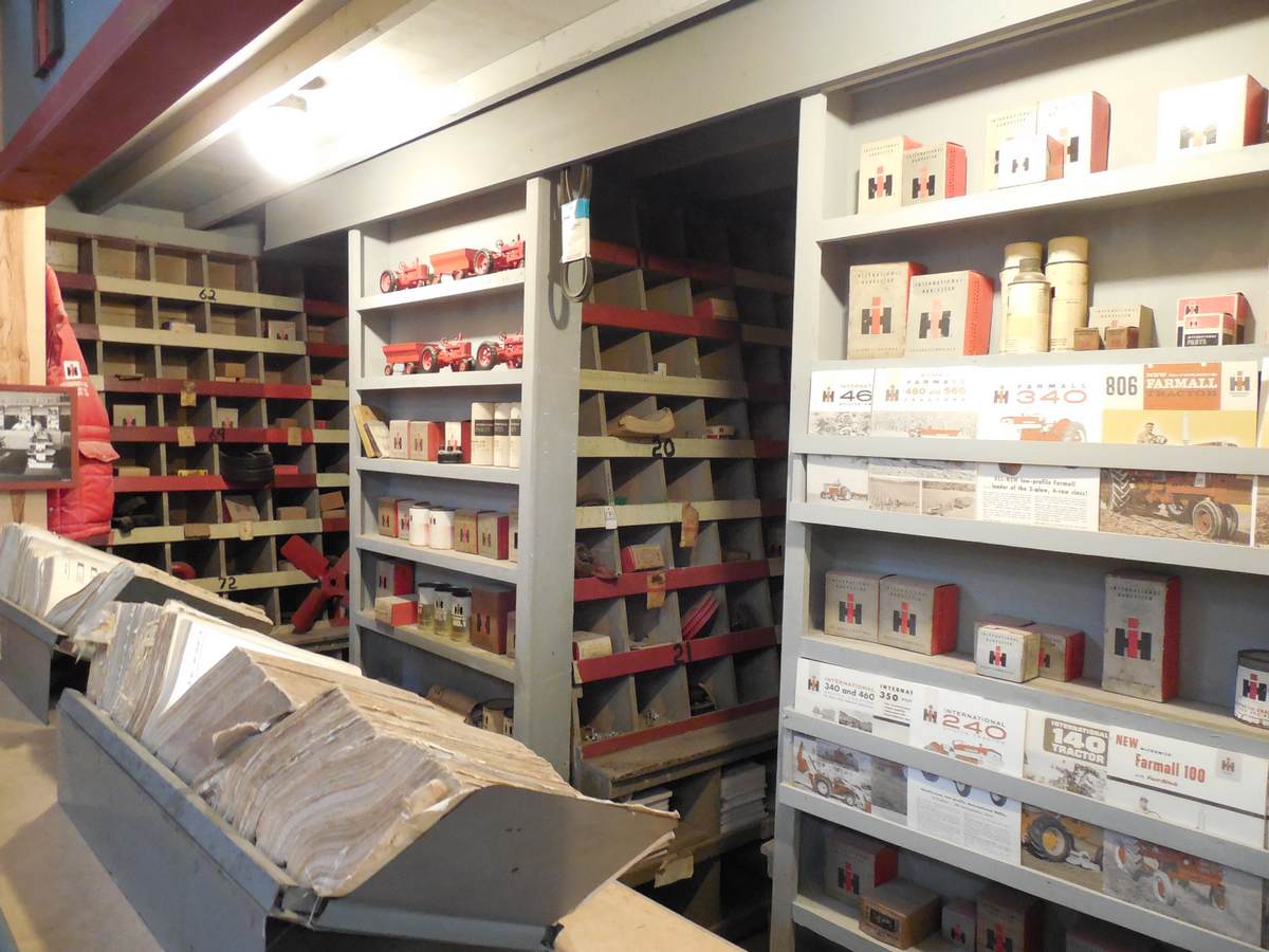

Well dad always jokes saying that gramp loaded up E and D becouse it was right next the index card fileing thing.
Which is the section to the left of picture and in that corner on bench is the index cards.

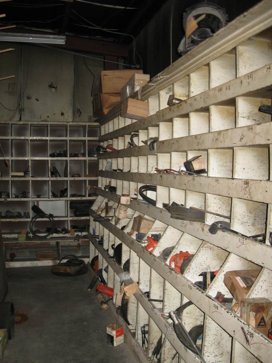

I have also seen shelves that were tapered. I'd also like to construct some of these or buy a set if I ever get space for them.

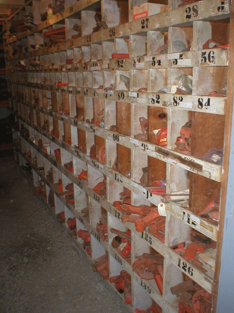

Not sure you can see but ours are tapered to. Now is there a time period to the bin design. I'd have to ask dad again but I almost think he said gramp bought out an old allis dealer at the time and bins came from there.

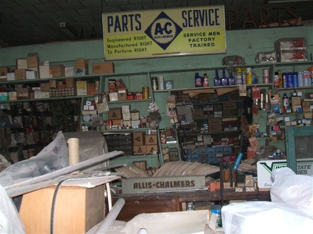

Here is a counter that came from the G&G Allis-Chalmers dealership of Luck Wi.  The pic shows the dealers side of the counter. Bought lots of parts over that counter top over the years till they sold out.  Very similar counter was in the Fallstrom A-C dealership in Falun Wi.

What are the dimensions of the parts counter?  I've been thinking of building one for a while...
